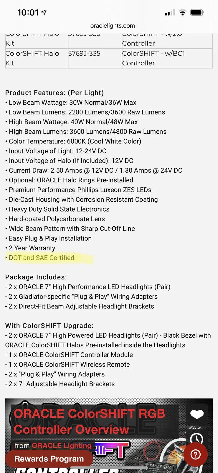

Wait a minute - that says "on the rear" and "one". The tables are a bit confusing (clear down at the bottom) but I read that it only says "on the rear". So where's the problem?
And the lumens - that stuff sets the MINIMUM, not the maximum.
AND, you still have the FACTORY working backup lights which meet all requirements. (I guess a person could simply unplug these for inspections?)
I can see these NOT passing in California as I'm going to guess those wimpy small reflectors would not meet the state of CA minimum distance requirements.

There is something in there that states “stamped” DOT/SAE. The oracle light does have a red reflect reflector in it, so the vehicle still has them on to meet that requirement., but is not stamped.
They use this a lot. “Certification. The exposed surface of each reflex reflector shall be marked with the letters DOT-C which constitutes a certification that the reflector conforms to all applicable requirements of § 571.108 of this part. The certification shall be not less than 3 mm high, and permanently stamped, etched, molded or printed in indelible ink.”
