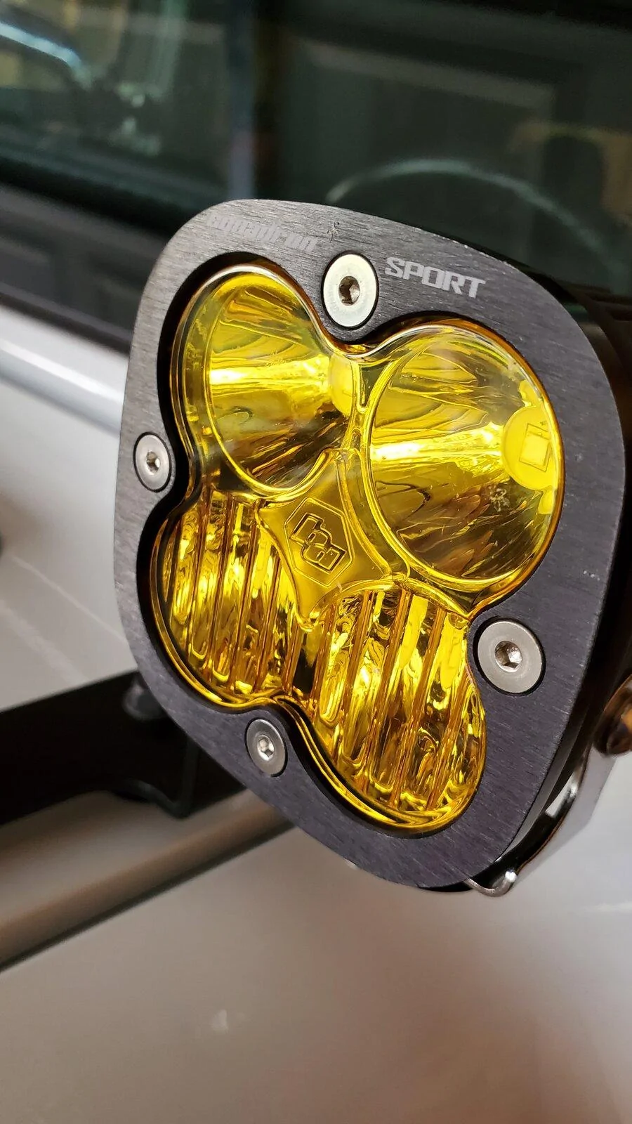

But they are aux lighting, not reverse lighting. If you are plug and play disconnect the harness and go get reinspected.
Price is not the issue, nor do I think Oracle is at fault here. My Baja Squadron pillars were twice as much, and not a DOT stamp to be seen. The problem is they've been miscatagorized by your inspector.
