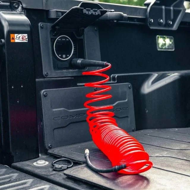

First post here so I’m hoping I can get some good info/ideas! After extensive research I’ve come up a bit short on finding what I’m looking for. I’m a PPF installer and recently was inspired by the integrated on-board air on the new Tacoma trail hunter I recently worked on. It’s a compressor that’s literally integrated into the bedside of the truck with an access door to the inner bed(see photo). I love the idea of on-board air, but would hate to deal with a bulky setup on the inner bedside, engine bay, etc. Saving space on my rig is definitely a priority. Does anyone know of anything similar to this, or has anyone retrofitted something similar? Would love any thoughts, ideas or recommendations!

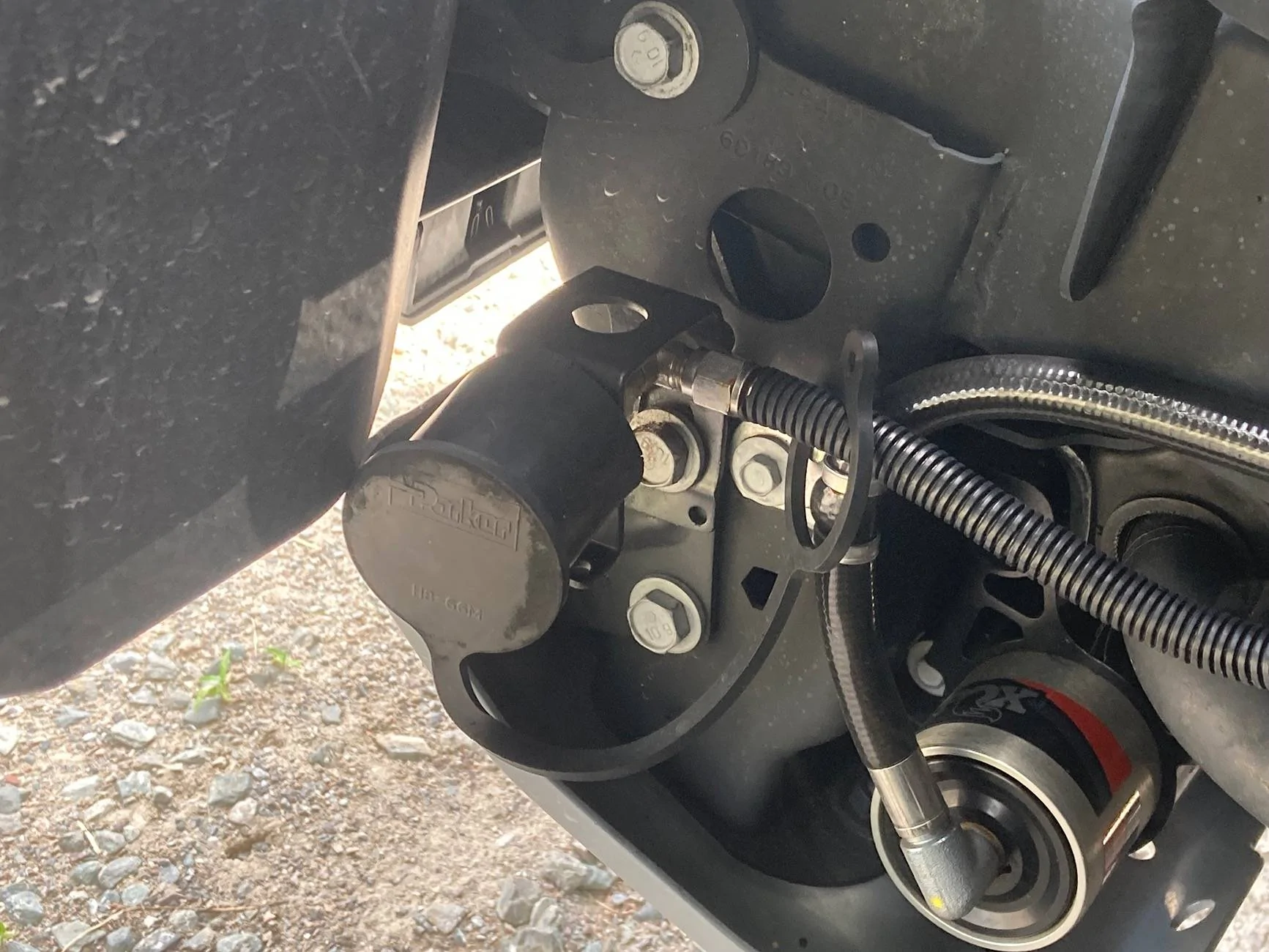

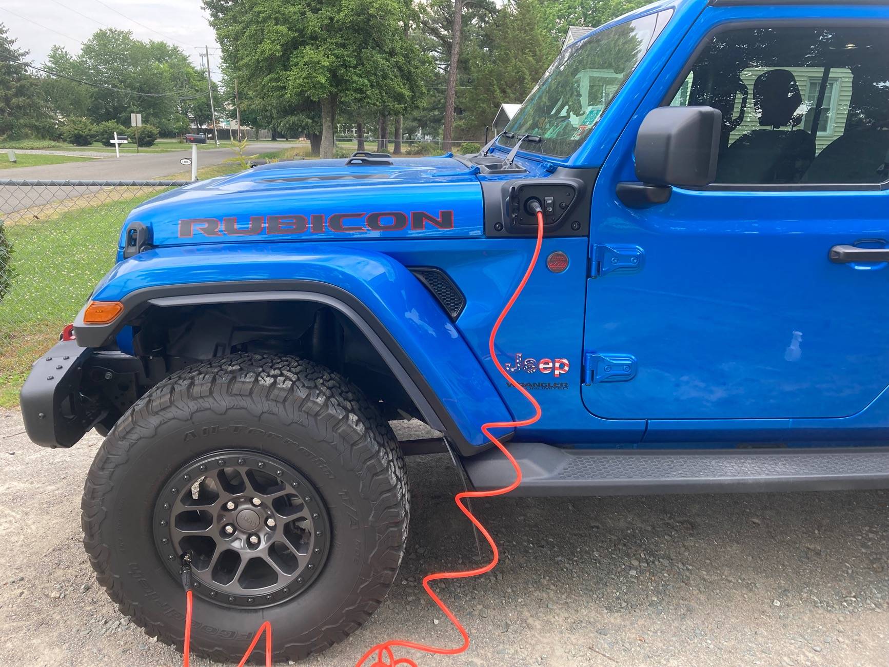

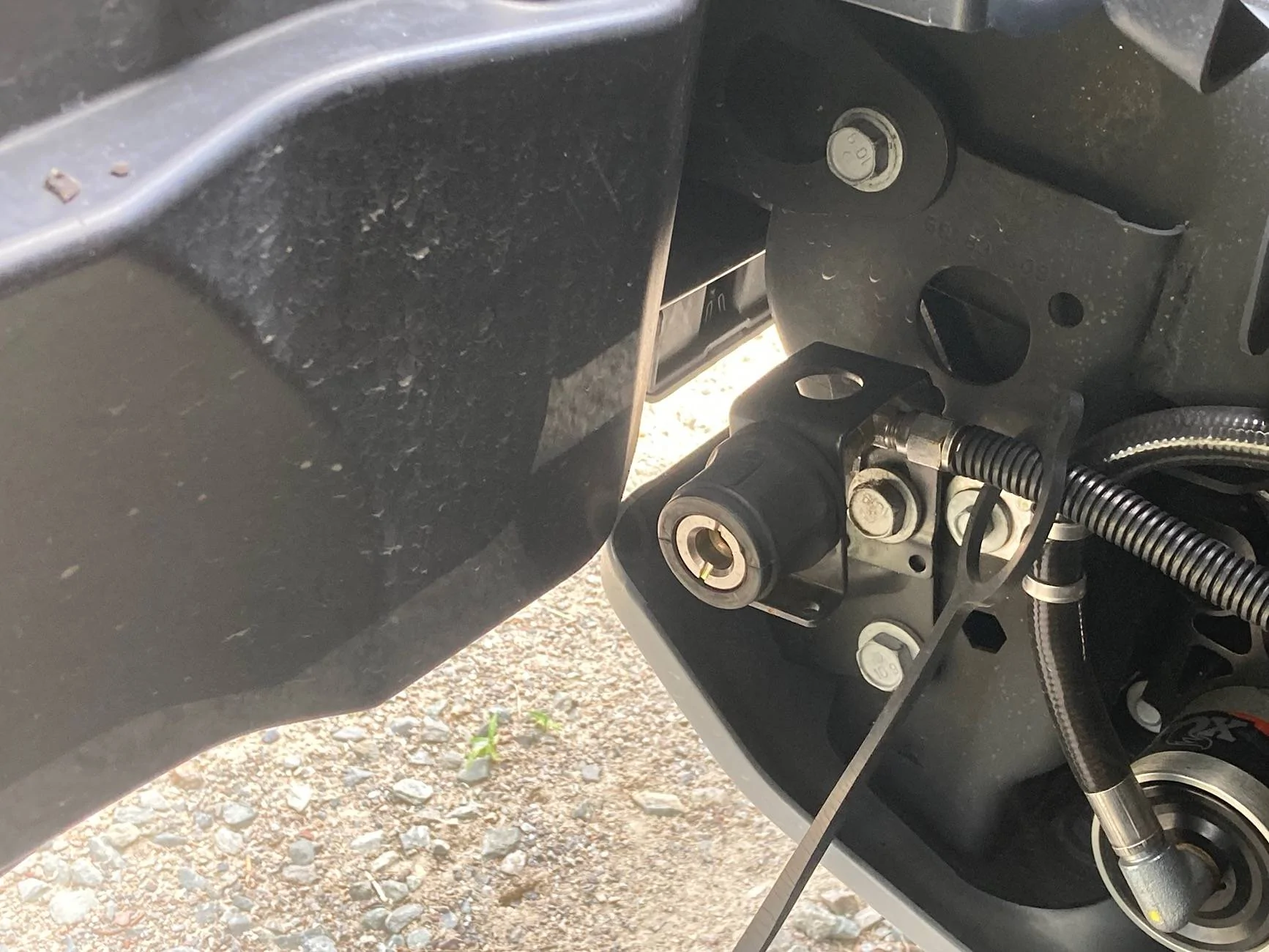

on my last Jeep I bought a 4xE cowl, and mounted the air chuck there. The ARB compressor is mounted near the brake booster. Had it wired to run using factory Aux switches. I have a Mojave now, so I can’t use that cowl. It will work on other model gladiators. My air chuck is mounted behind the front bumper, with a hydraulic dust cover protecting it.

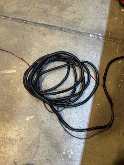

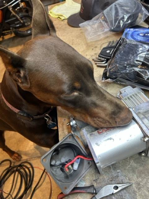

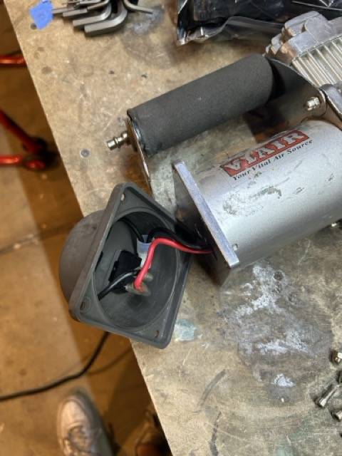

So to anyone still following here, I’m getting started on the project (with my shop helper of course 😂). I picked up a VIAIR compressor off marketplace for $50, extended the 12v cord, wrapped it in conduit and found a good place to mount it. I ordered a stainless steel line to get the air from the compressor to the bedside, and I’ll mount the switch right next to the chuck. I’ll post updates along the way!
