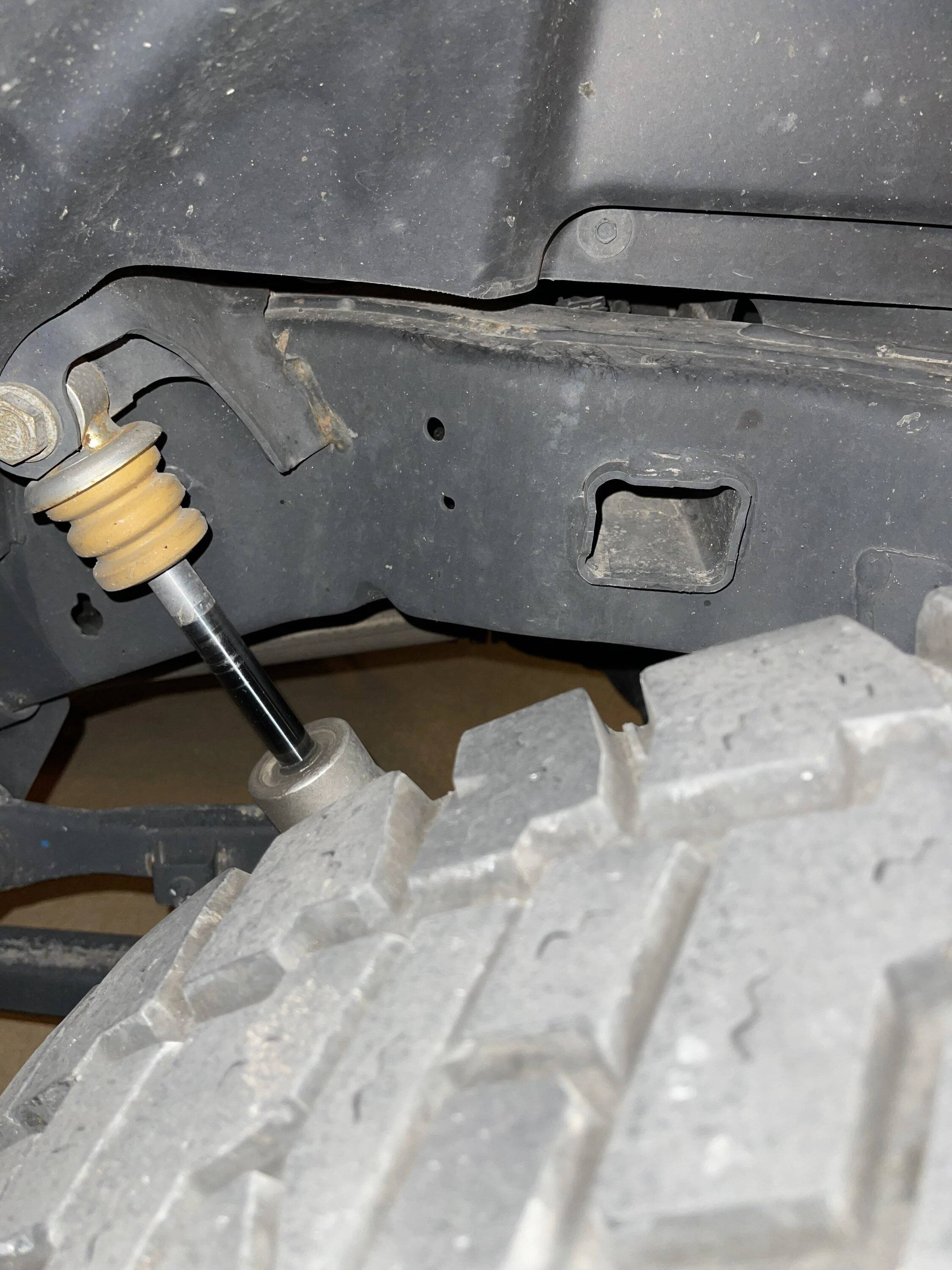

Just looked again. Drivers side has notch. Passenger side no notch??????
Well that’s interesting……….
So, I haven’t been able to find any info on this gfrc truck for year…
I wonder if it’s a gas/diesel thing…..
22 diesel here no notches on either side…
Anyone with a 22/23 gas confirm if it is a year change deal or a motor change deal.
Even though that notch is there I don’t see it making the frame bend in half unless you run these at high speed and overloaded.
These toys are pretty easy to overload…. Skid plates, beadlocks/big tires, winch, bumpers, recovery gear, some camping gear and two American sized dudes- no dog and you are basically at your allotted weight rating….

2/22 diesel. No notches on mine.

My early 2020 max tow does as well
What kind of shock is that? Does that bumper on the shock shaft come into play before the frame mounted bumper? Thats exactly the kind of shit creating the frame bendng forces?
Just a cheap twin tube with shaft mounted shock savers. They come into play about the same point.
I'd cut them off then.......They dont need to be there and it's ust transferring loads forward of the axle.
You could do us all a solid and go jump it to prove my theory? ;)
Why they aren’t hurting anything. There is no proof the shocks cause this. And I don’t buy that. The 1/8 tabs on the axle should easily deform before or with the frame if shocks are the real reason here.
That bend just happens to be the weakest point on the frame and right where the cab and bed are separated. Any excess weight behind the rear axle is pushing down at the springs like a lever. The motor does the same on the front. Frame will break at the weakest point from the counter leveraging. You can make a demonstration from a board and some weights. Add the additional dynamic forces from high speed bouncing and it’s all she wrote.
