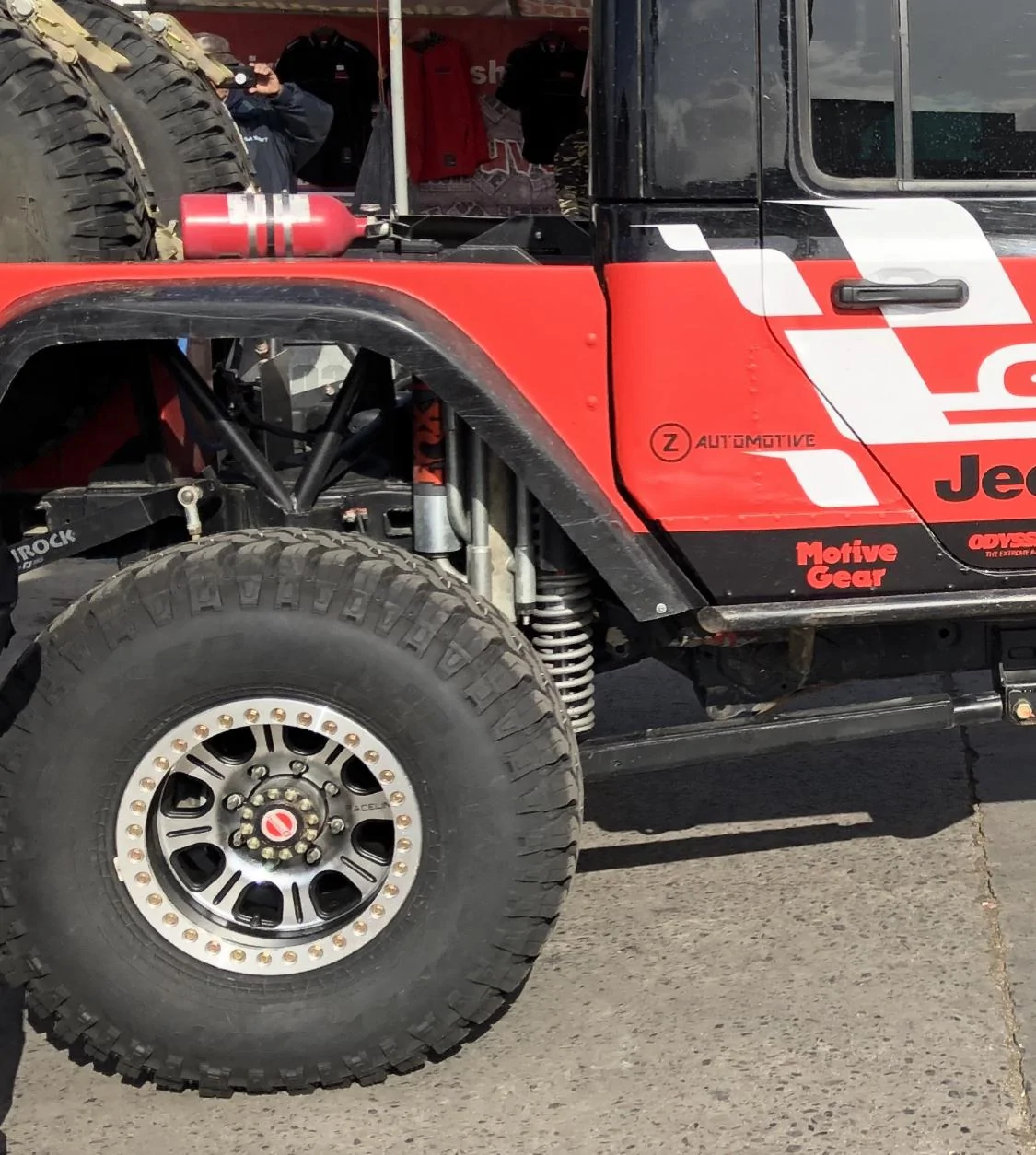

Is this a photo of a bent frame or a allegation of where a bend would happen?

This is the first pic I've seen up close of the potential failure location.
I did find a video a while back on you tube of a job someone did adding a plate to that area. The idea I think was pretty good, but the execution left some to be desired..........

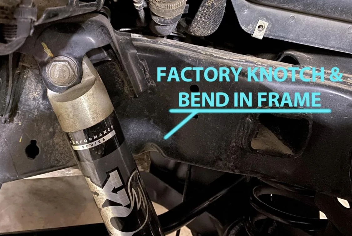

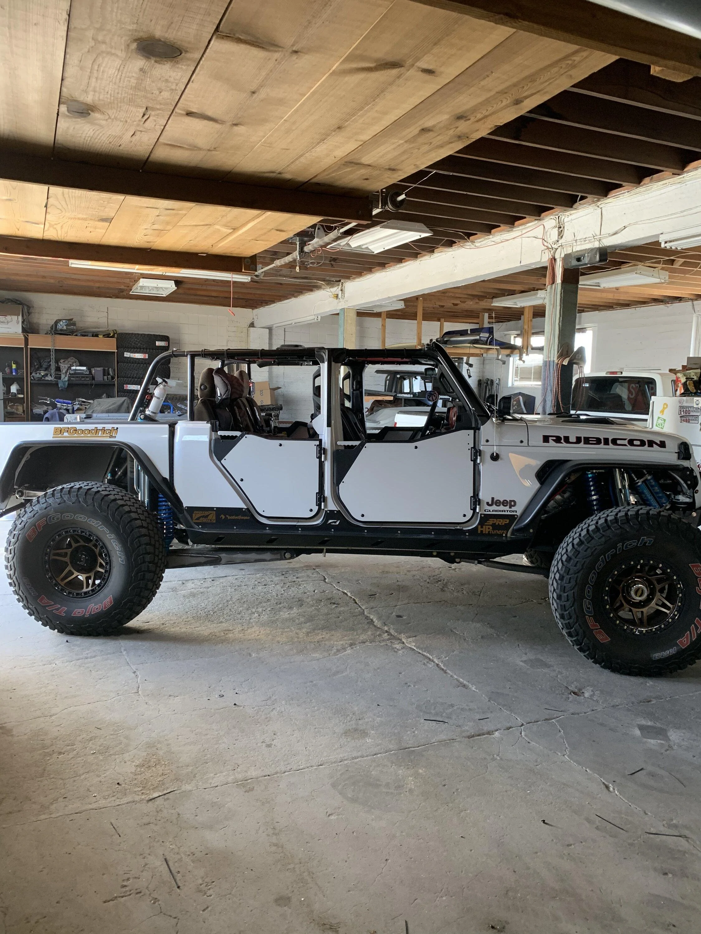

So I’m stuck on this topic…..
Is this factory frame knotch that was posted above- I can only assume that this is the post bend photo…. Because it doesn’t look like this “not bent”
Jeep Gladiator Bent Frame D3D01089-0198-4CC5-811B-9262DACF67B7

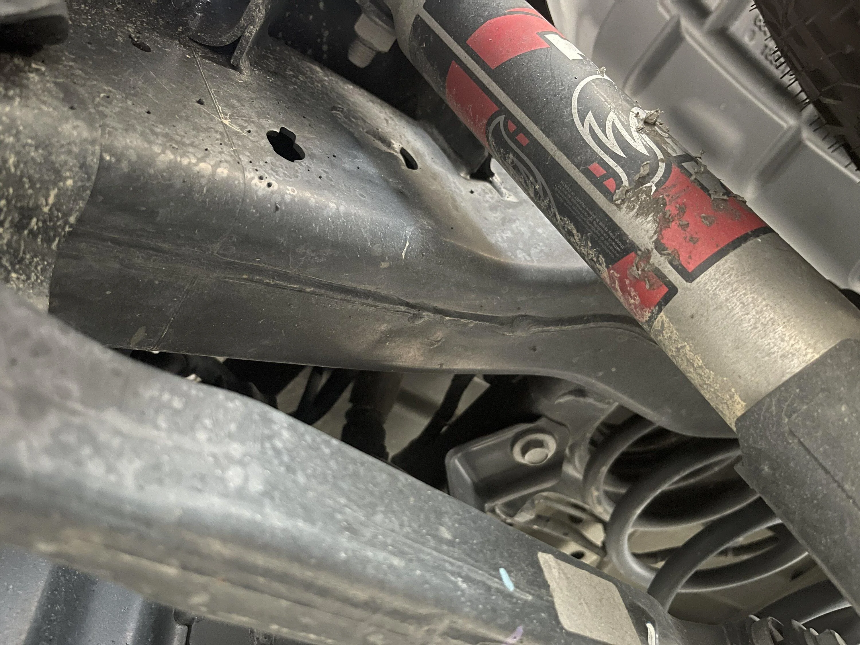

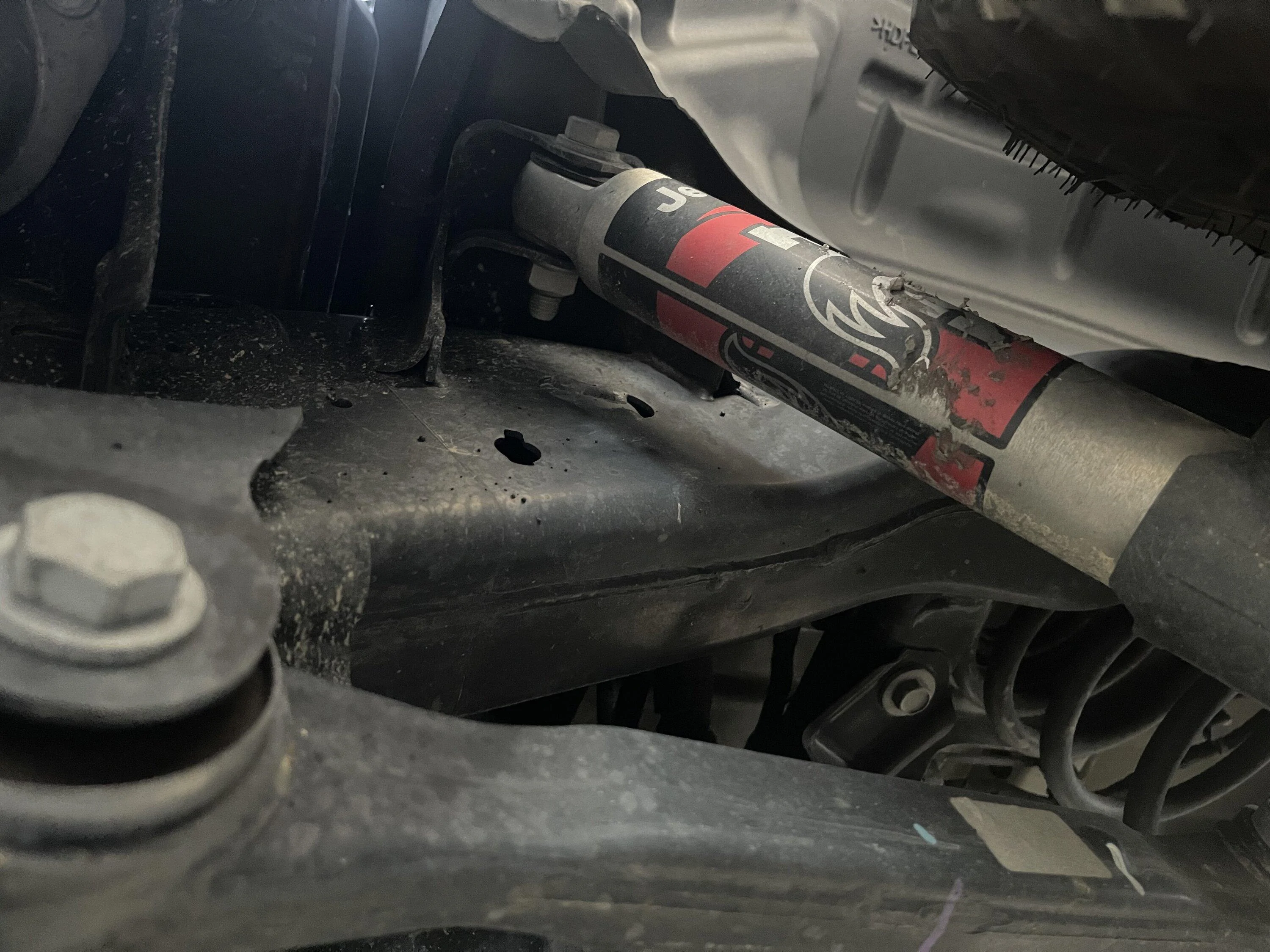

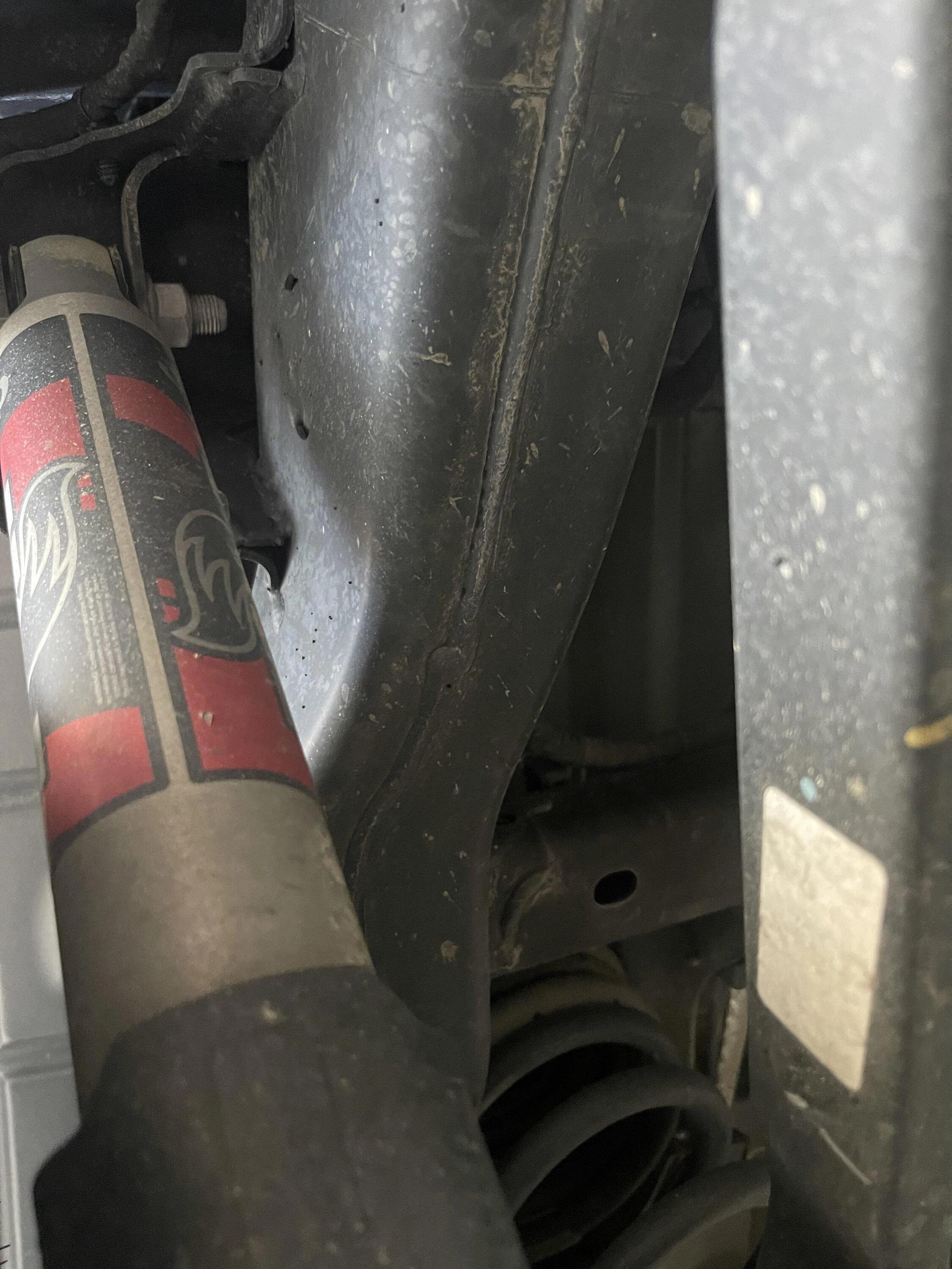

My frame…. Though note the link is where the frame is bent in two directions from the factory…. An upward and outward angle (or inward ?? Coffee??)
Jeep Gladiator Bent Frame BD163B5C-F776-42C9-A2A9-C096BB071803
Jeep Gladiator Bent Frame 4E26B76A-1FD7-4014-880E-781EDEEFCB9A
Jeep Gladiator Bent Frame BB16011D-2030-4528-AF14-BFC7C10A90D4

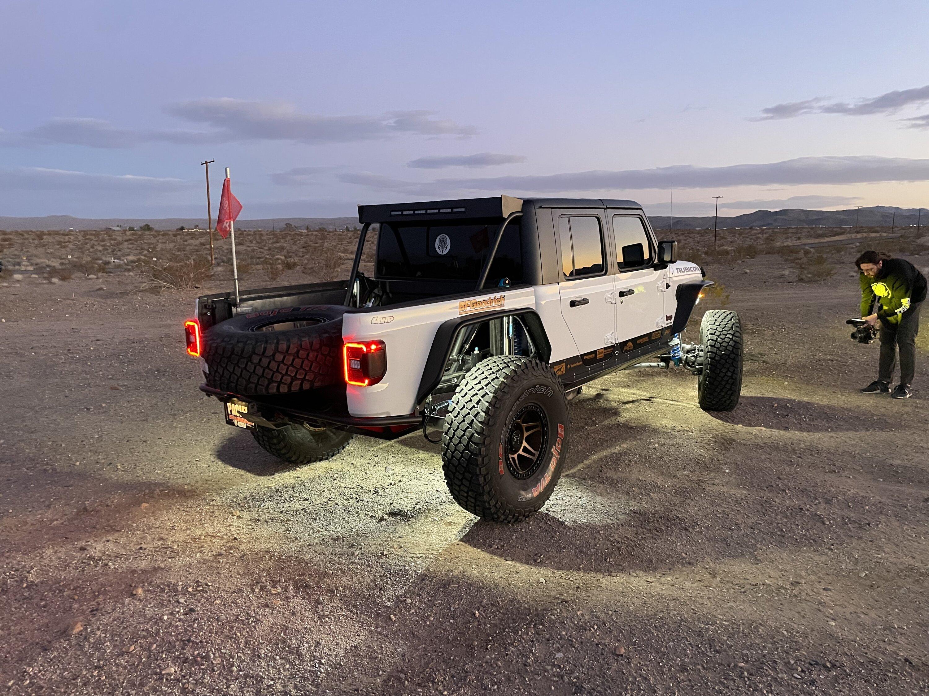

Savvy looks to have ditched the mount completely ???? trailing arm setup.
Jeep Gladiator Bent Frame FB0DB712-6689-4FF3-A045-8F0143FA3883
Another badass rig….
Jeep Gladiator Bent Frame DCE03A49-F0C8-4042-9A15-A7D4811E1936
Jeep Gladiator Bent Frame D9A927B5-36A8-44E1-9165-F68DE72E443E
