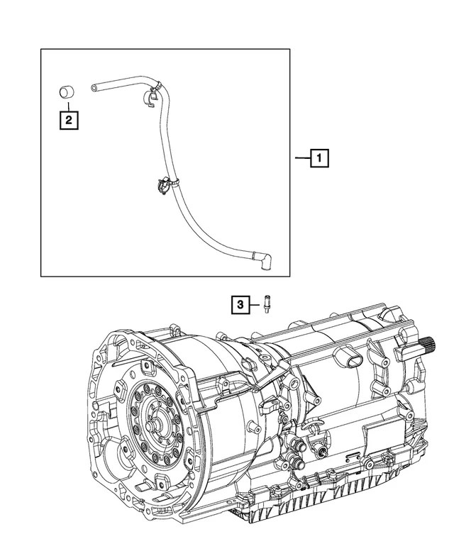

And for my own reference later:
Jeep Gladiator Besides a snorkel, what mods are needed for a Jeep to go this deep in water? 1feaba3ec116349ee615379695189949
Transmission Vent - 4799861AB (#3)
Transmission breather tube (#1)

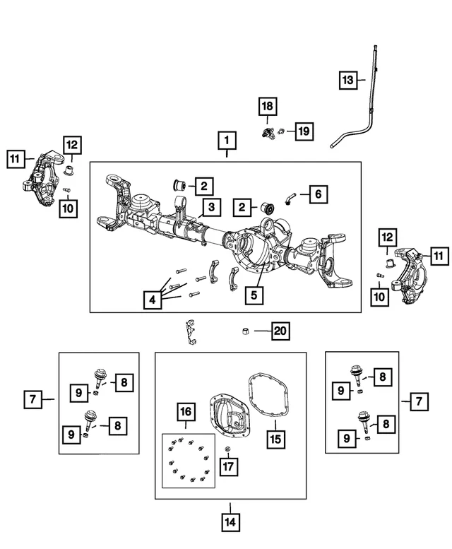

Jeep Gladiator Besides a snorkel, what mods are needed for a Jeep to go this deep in water? ae8e6e9100c2708b1d5299970249b13e
Front Axle Vent 68463497AA (#6)
Front Axle Vent Tube 68283292AD (#13)
Odd how the front axle has a dedicated vent to connect the tube to but rear doesn't.

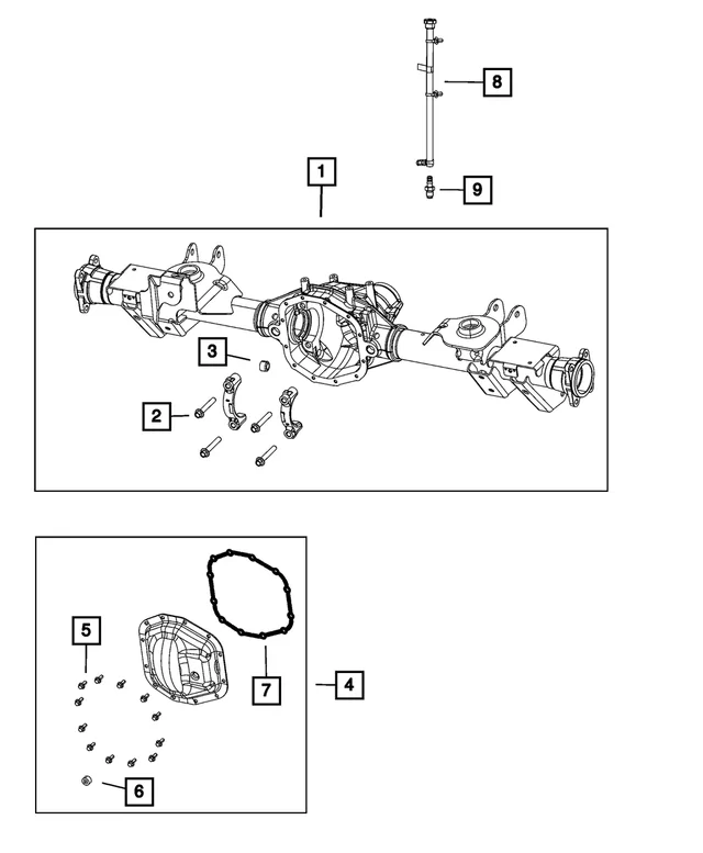

Jeep Gladiator Besides a snorkel, what mods are needed for a Jeep to go this deep in water? 8a257caf9f0e2a74fcb8b6e01eb0d4b3
Rear Axle Vent Bolt -52114267AB (#9)
Rear Axle Vent Hose - 68338693AD (#8)

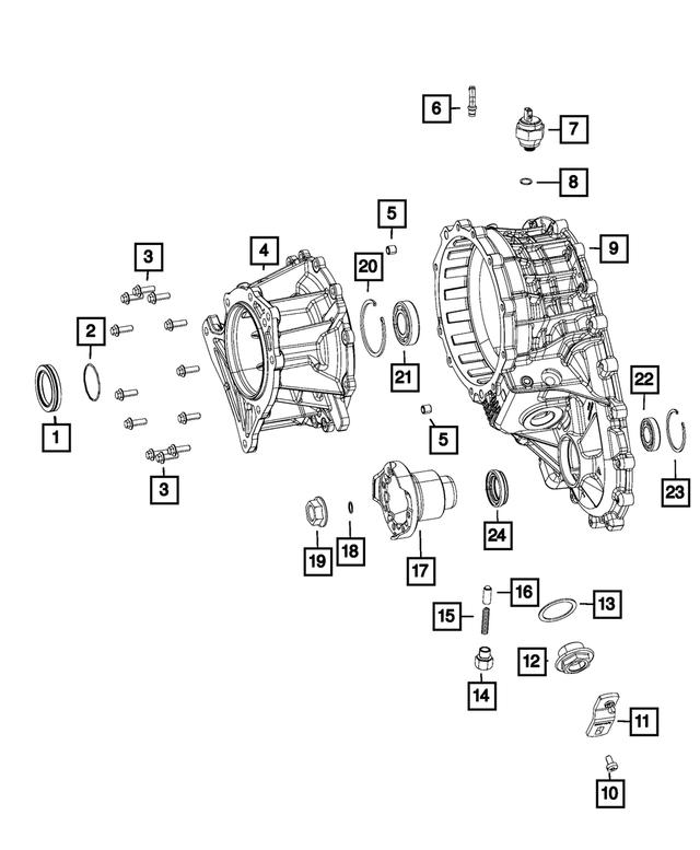

So the Transfer Case does not have a vent tube, just a vent!
Jeep Gladiator Besides a snorkel, what mods are needed for a Jeep to go this deep in water? 241dbd8f34141ed90b1720410c7834a8
Transfer Case Vent - 68385085AA (#6)
I think this goes to the little hole adjacent to fuel fill hole. Probably not important to consider.
