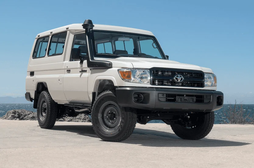

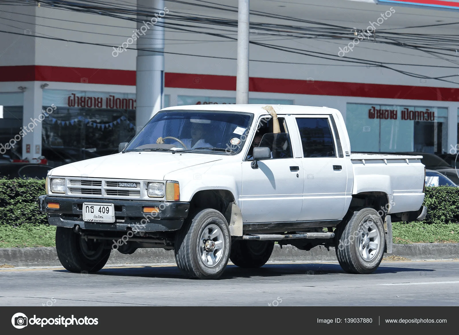

I lived in Ethiopia for awhile. Drove these two vehicles for the NGO. God they were awesome. Really miss turning the lock on the wheel itself. Tires were usually bald but we ran tubes and somehow managed to get out of everything... Learned a lot.
(Pictures generic from internet. Ours were squared off on the front, and beat the hell up.)
