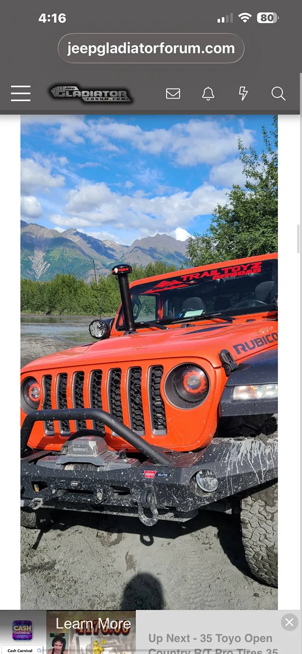

Jeep Gladiator Best snorkel for high water crossings? IMG_5374
River Raider just seems like a nice design , can put lower pipes on it when not really needing the water crossing height. Shame no one picked up the design….Jack
