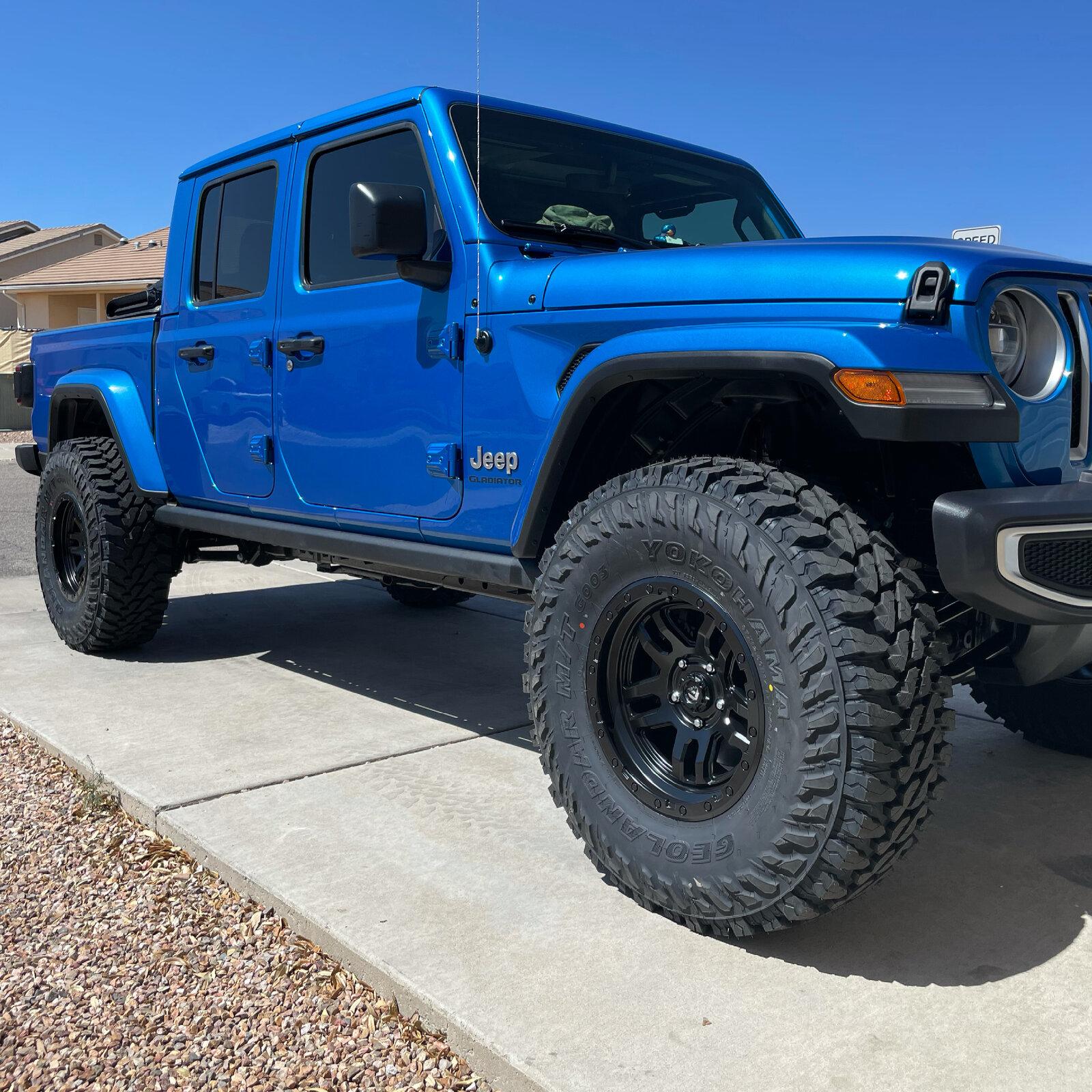

IMO the long proportions of the gladiator need at least a 37. Many on here regret going 35s and look forward to replacing them with 37s, just search. I got 37s and wish I went 39 bfg. If you have over owned a boat, then you know this as two foot-itis.
