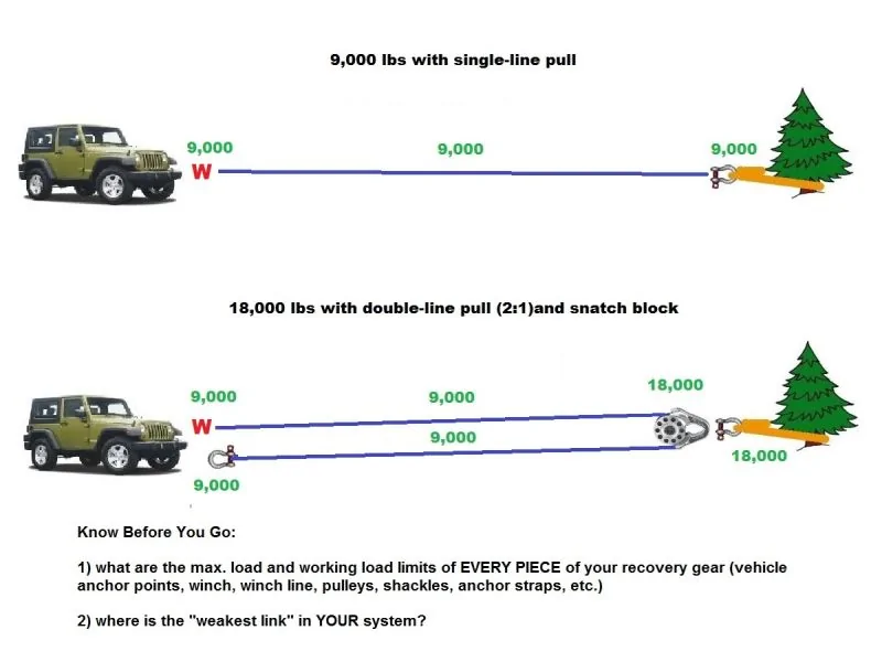

Here is my 0.02, I have used it a few times and it has worked great for me. Keep in mind your winching power: example mine is a 12k winch, if I use a snatch block and run strait back I now have 24k pulling power.
You need to have gear i.e. snatch blocks, straps, shackles, anchor points, that can handle the load you will exert.

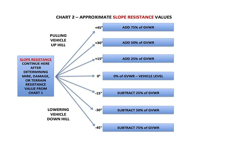

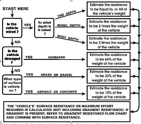

Another way to look at it is that a recovery requires a certain amount of force to accomplish. (Your tables are a very good reference) and that force can be reduced and redirected using blocks and other fixed attachment points (Trees, rocks, other vehicles, etc.)

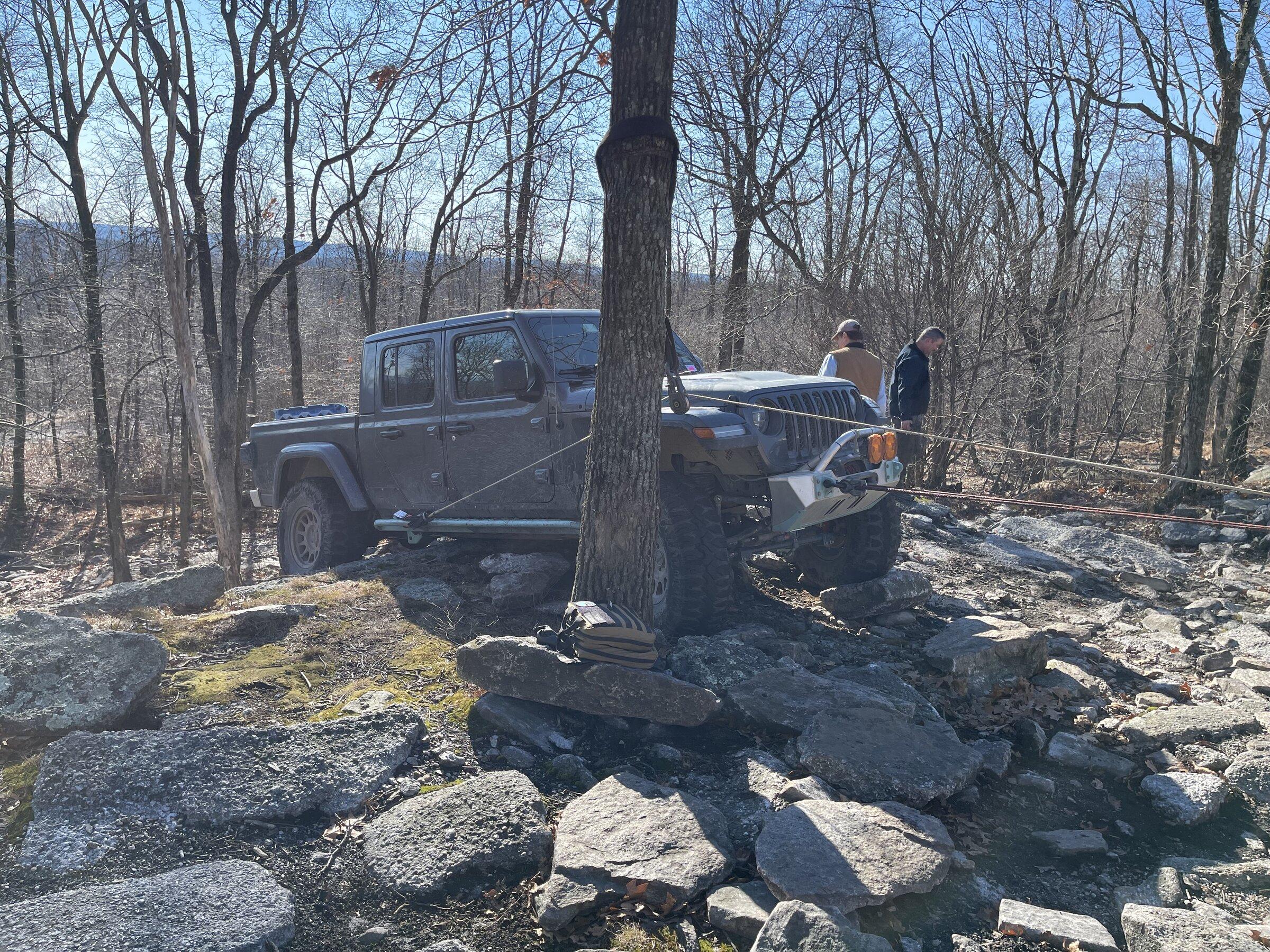

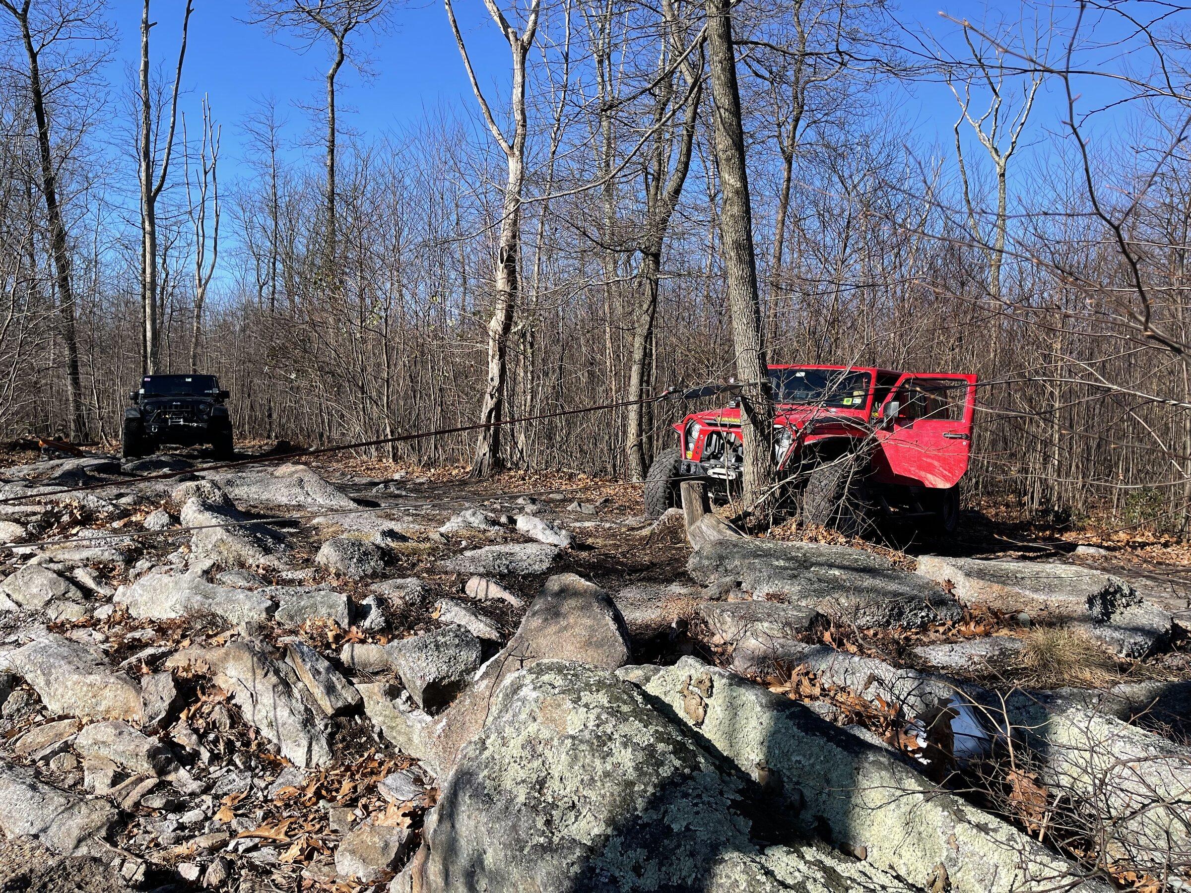

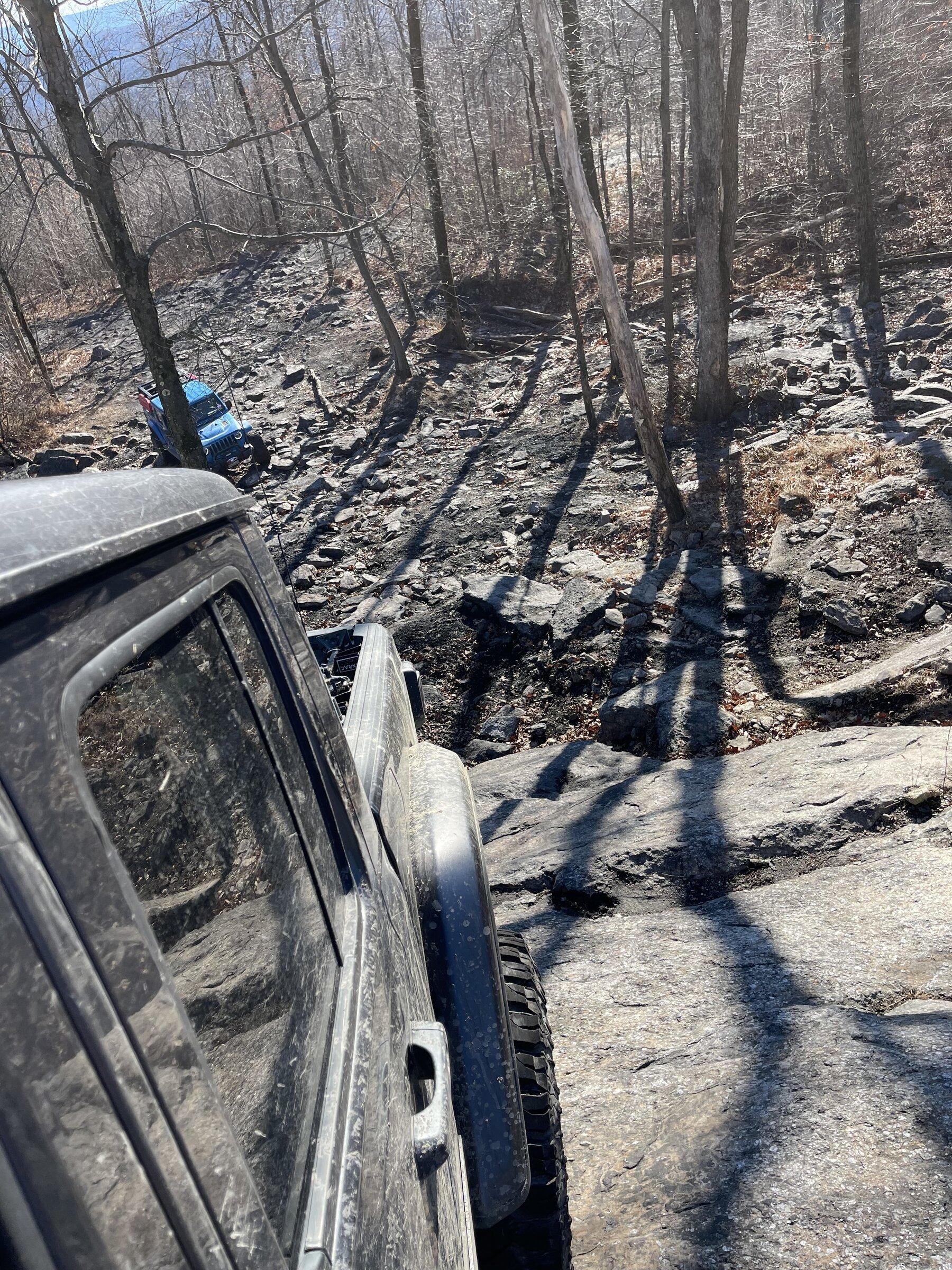

Example multi snatch block pull after doing a buggy line and finding the lip too sharp. Needed to lift the rear of the vehicle to get it off the LCA skids, and the snatch blocks up front to give the JK more pulling power since mine was being helped by gravity.
