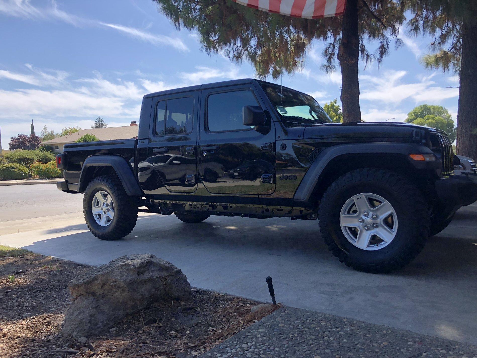

bigger tires on unlifted Sport S
peeklay
brian
Feb 23, 2020
coloardo
2020 Gladiator Sport S

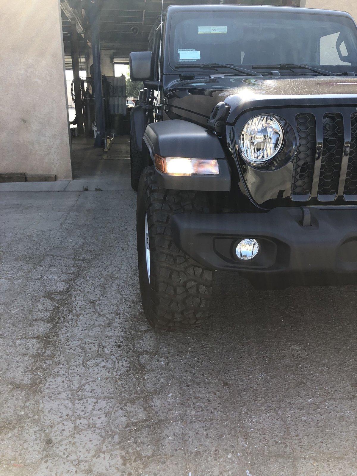

Welcome to the forums. Even though the thread was started a while ago it still gets updated. Usually there's someone that has to go and start a brand new thread. I'm surprised that tire places told you you can't go higher on tire size. Must be a California-thing. Here in PA everyone and their brother drives a truck or SUV that's lifted with big tires. Your upgrade looks good.
Discount tire said couldn't put some of the Wildpeak Rubicon take-offs on my stock Sport S.
This forum told me otherwise and this forum is right and DT computer is wrong :)

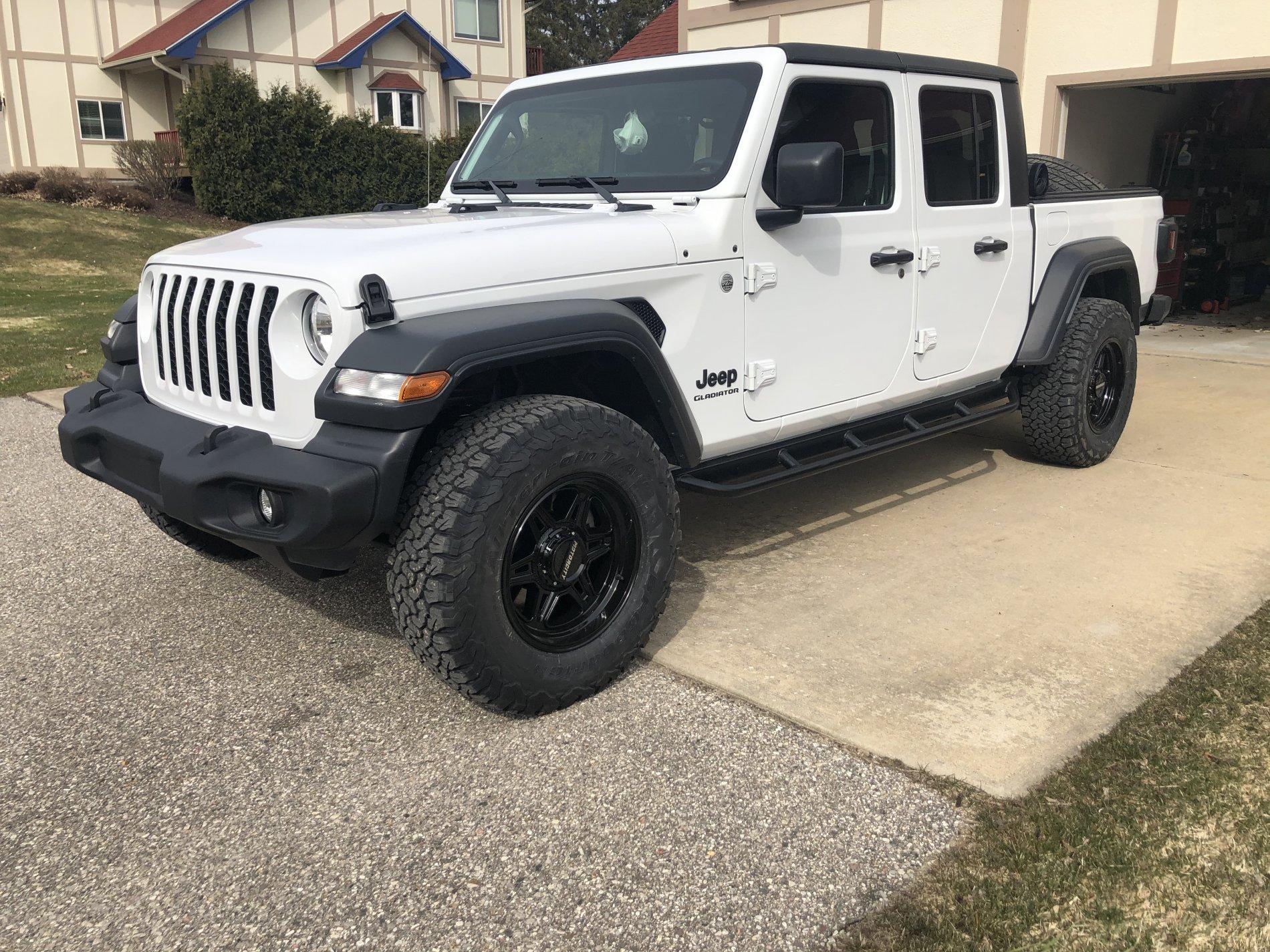

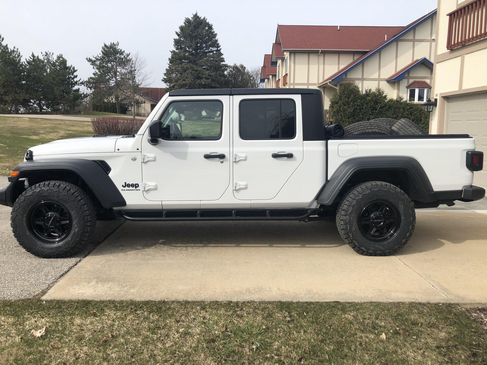

Tool Man
NO LIFT on 35's with Mopar Gear Satin Carbon Wheels.
Part Number 77072471AB
35 12.50 R 17 General Grabber and 17x8.5 wide with 5.22 BS mopar gear wheels. This was before my lift. No rubbing lock to lock. And fine if you chose to get the tires installed first and the lift later. The way my build was going I decided to get the dealer to add this to the BOS and get my Mopar Lift to install on my own.

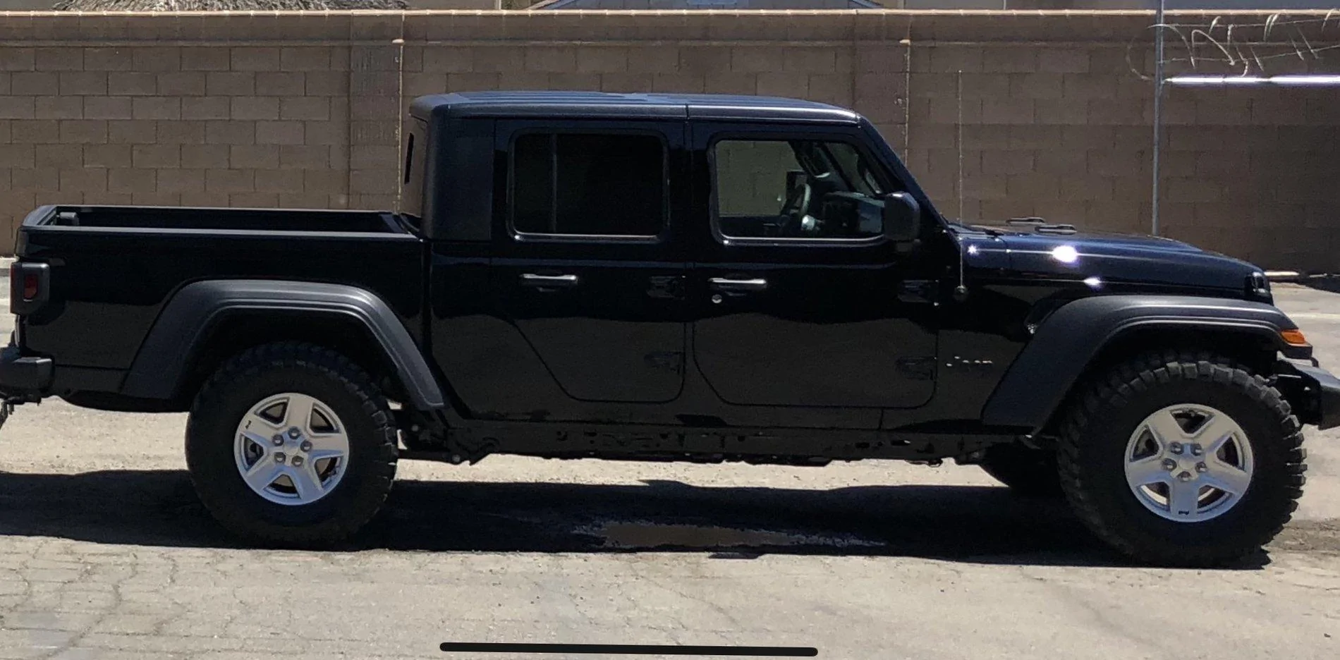

See now I'm torn between a 285/75 and straight 35" KO2... I think I have the wife convinced about the stubby at the same time to deal with the rubbing, I'm just wondering if 35's will rub in back with weight off road... anyone have any feedback for a Max Tow on stock wheels?

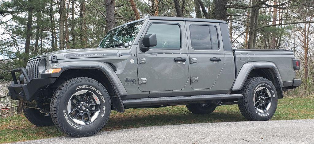

I went back and forth on what tires to get. Was going to stay stock (245/75r17) then thought about 255/75r17 or 255/80r17. DTD had their flash sale Monday so I got 285/70r17 P rated Cooper Discoverer AT3 4S which weigh 45lbs each. I wanted to stay close to stock weight as I could. The tires were $50 off for 4 and there's also a $70 rebate. Bought Monday, delivered today. PA has this stupid law now where the tread can't stick out past the fenders and this goes for inspections too so I wasn't going to go with 35" and I prefer white letter tires and there wasn't any choices in the 285/75r17 and they were heavy tires anyways. I did consider the C rated KO2 but I've had them before and they pick up little rocks like crazy. I had the C rated 315/70R17 on my '15 JK and then sold them a few months later for some 285 Coopers and had to dig out all the rocks with a screwdriver hahaha. I mainly use my truck for hauling stuff, no towing so I don't care for everyone's whole 'P rated sucks for towing so buy heavy E rated 35" tires instead' bullshit that 'supposed' tire experts here like to spew.
