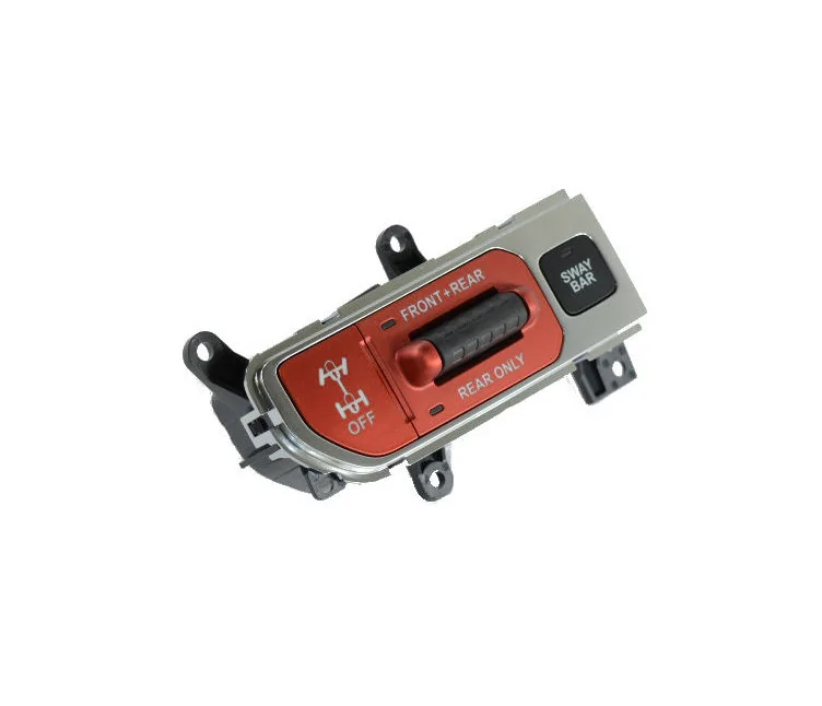

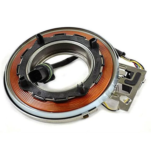

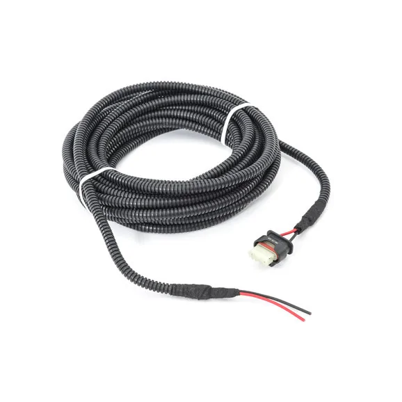

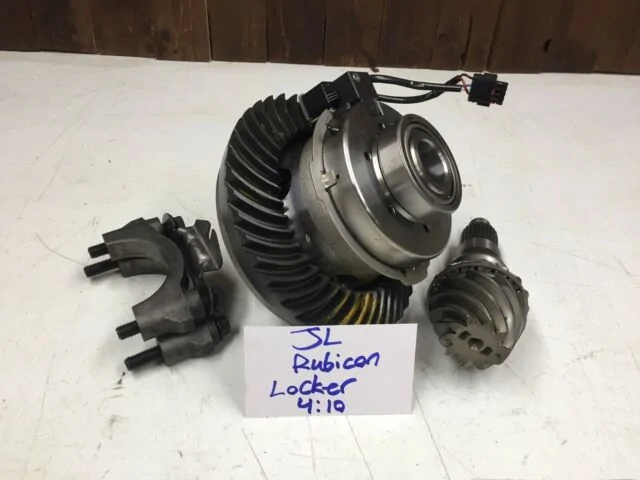

Does anyone know of someone who has added the Rubicon, Spicer Dana 44 E-Locker to the front axel on the Mojave? I'm planning to do this, mainly as a learning exercise/experiment.
I've done some poking around the internet and this is the parts list I've come up with. Does this list covers everything that's needed? Have I included any unneeded items? I guess I'm also wondering if doing this is even viable. Thoughts?
  1. The locker connector bolt: https://www.quadratec.com/p/mopar/locker-connector-bolt-jl-rubicon-dana-44-front-axle-68400412AA
  2. The locker actuator: https://www.quadratec.com/p/mopar/axle-locker-actuator-jl-rubicon-44-front-axle-68400409AA
  3. The actuator bracket for the front-axel e-locker: https://www.quadratec.com/p/mopar/locker-actuator-bracket-jl-rubicon-dana-44-front-axle-68400412AA
  4. The connector that comes out of the axel: https://www.quadratec.com/p/mopar/68400411AA-axle-locker-connector-jl-rubicon-dana-44
  5. The wiring harness to bring the front e-locker wiring into the cabin: https://www.quadratec.com/p/mopar/rubicon-locker-switch-harness-jeep-wrangler-jl
  6. The spicer/dana e-locker hub: https://www.drivetrainamerica.com/2...r-32-spline-rear-07-14-jk-rubicon-68036128aa/
  7. For enabling the front e-locker in the console and button group: https://www.zautomotive.com/product/tazer-jl-mini/

I really like all the updates to the Mojave, but still want the OEM sway bar disconnect and front locker.
What are the chances, the wiring harness is the same? Also, wondering if the fox reservoir location would impede the installation of the OEM swaybar disconnect.
Items needed?
Most likely need
All in I'm guessing around $2500 or less to add everything to have a Mojavicon.
Let's hear your thoughts on doing this. Let's not do a debate on Rubicon vs Mojave, there are other threads for that. I just want to discuss the creating this combo.
