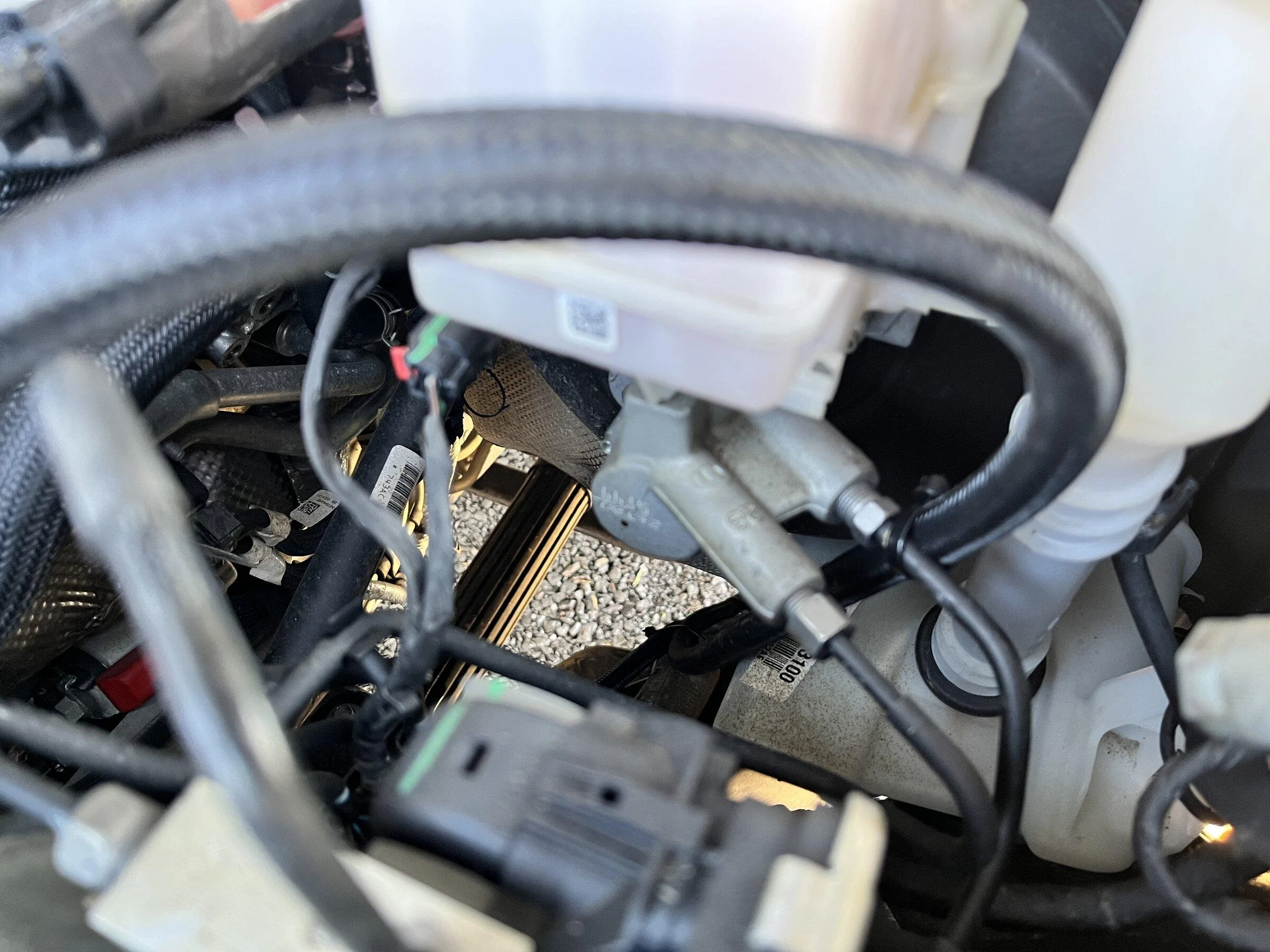

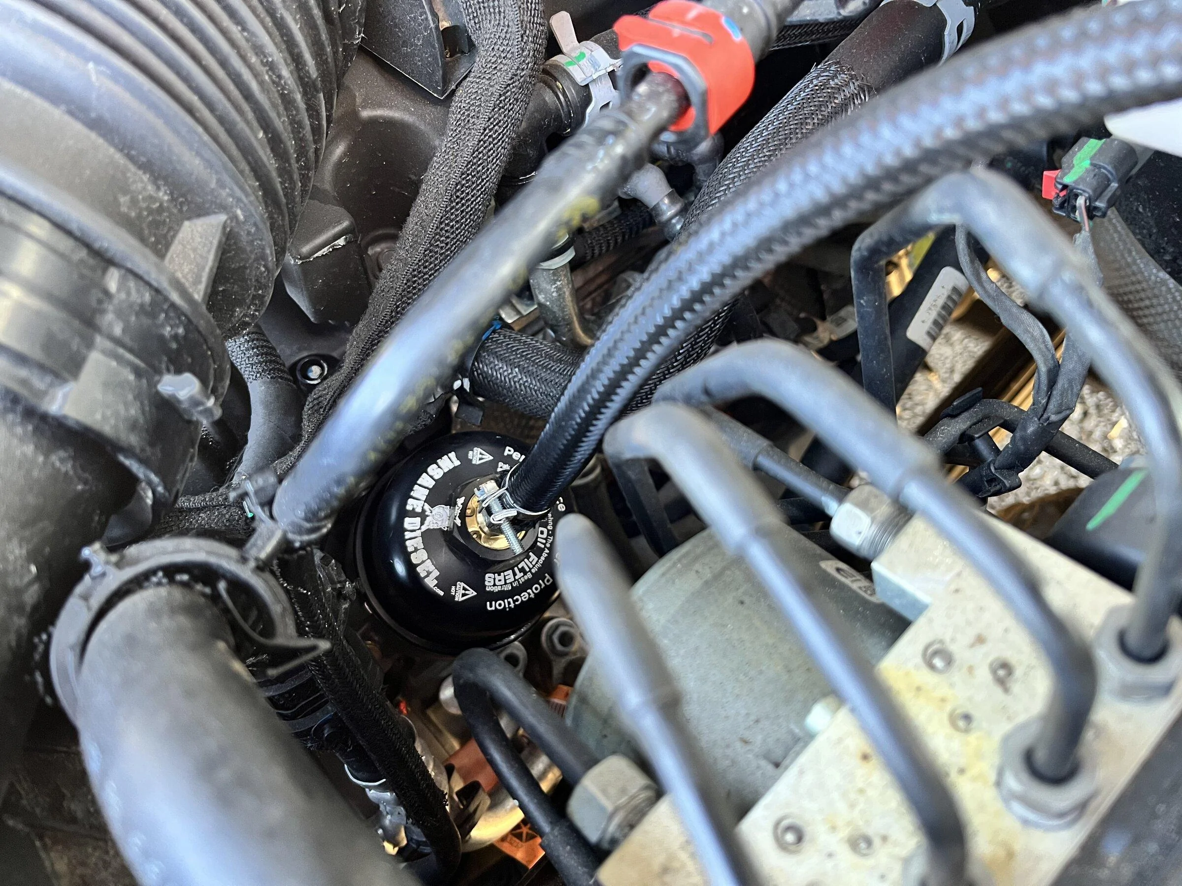

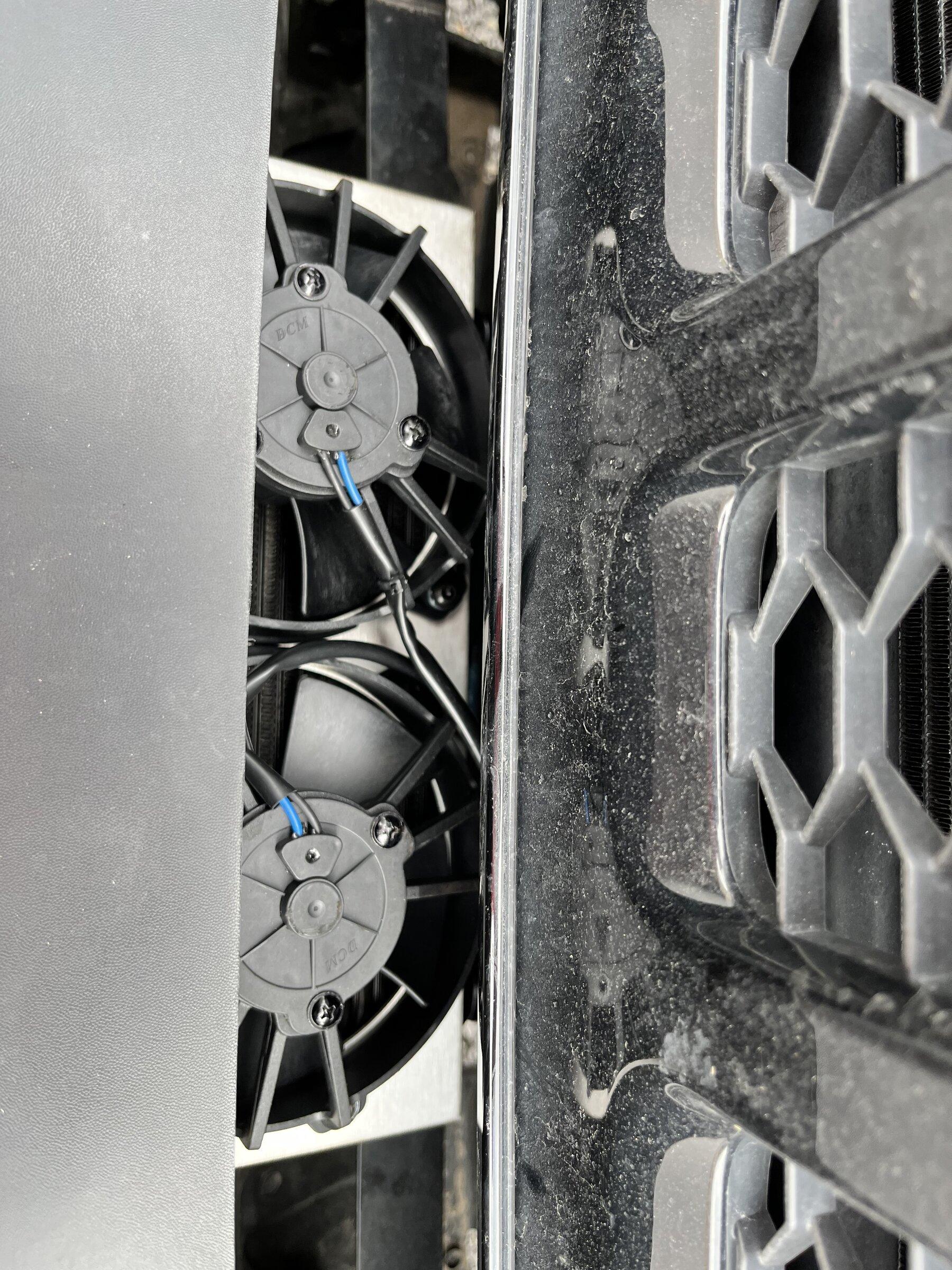

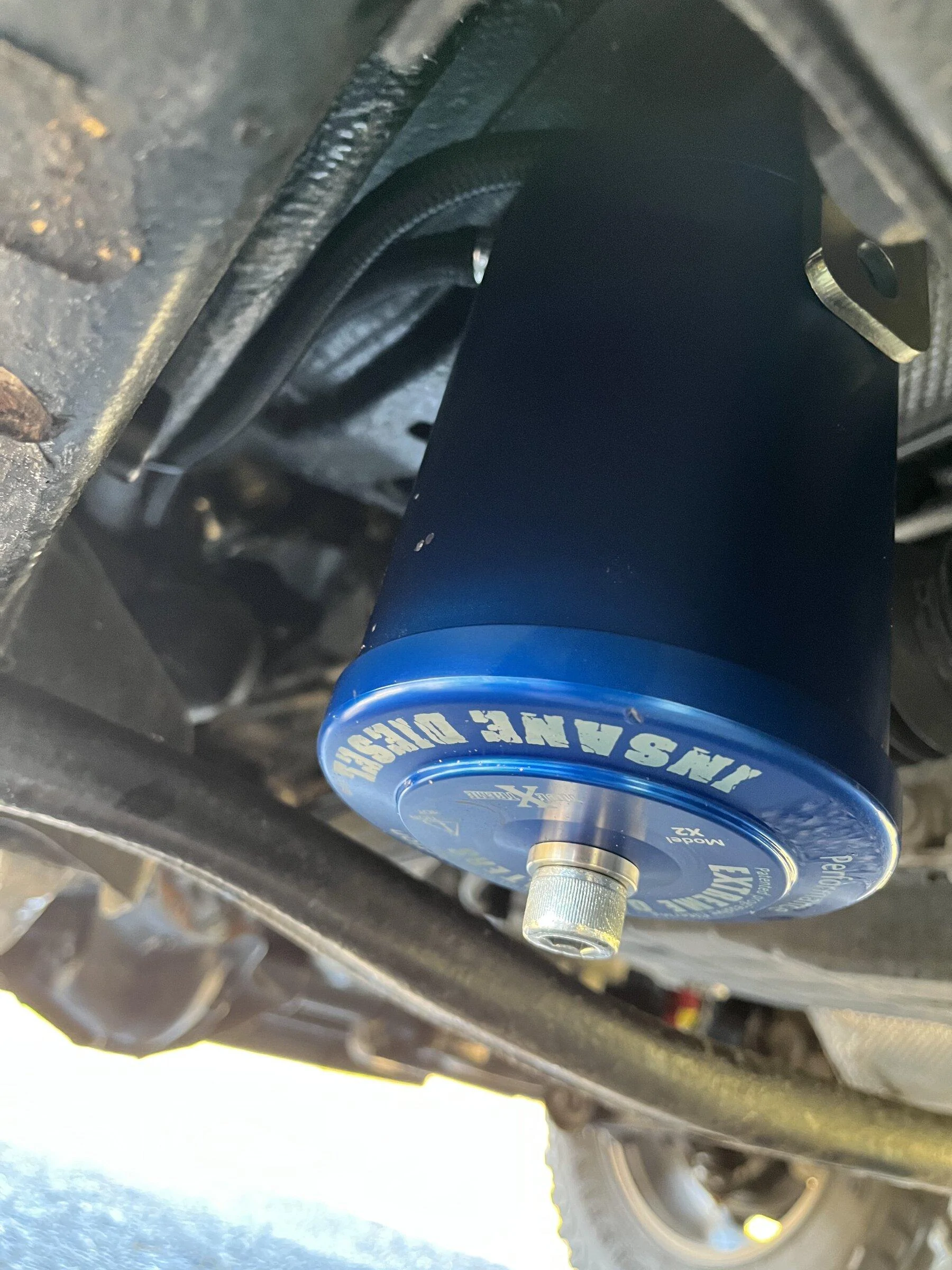

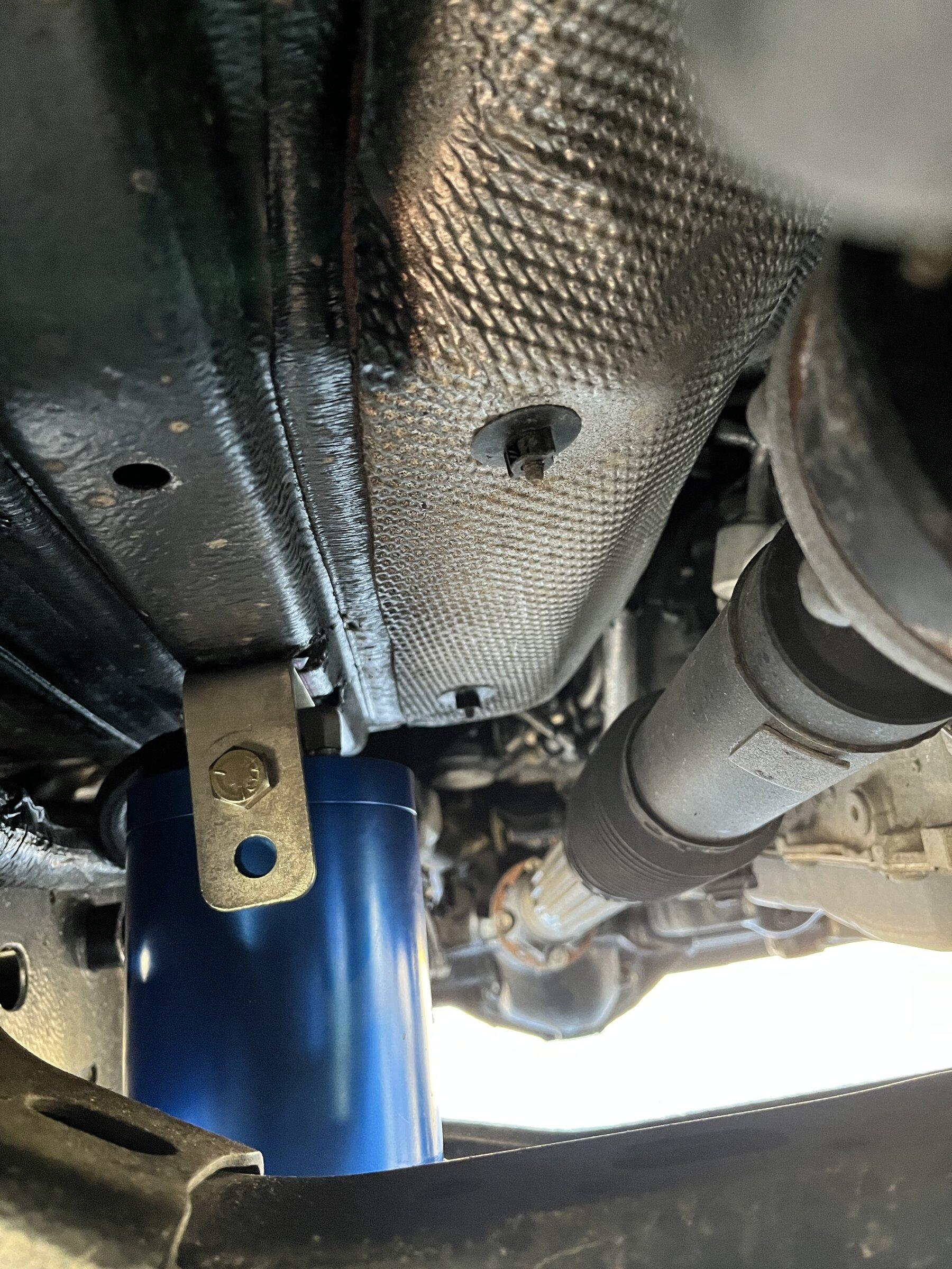

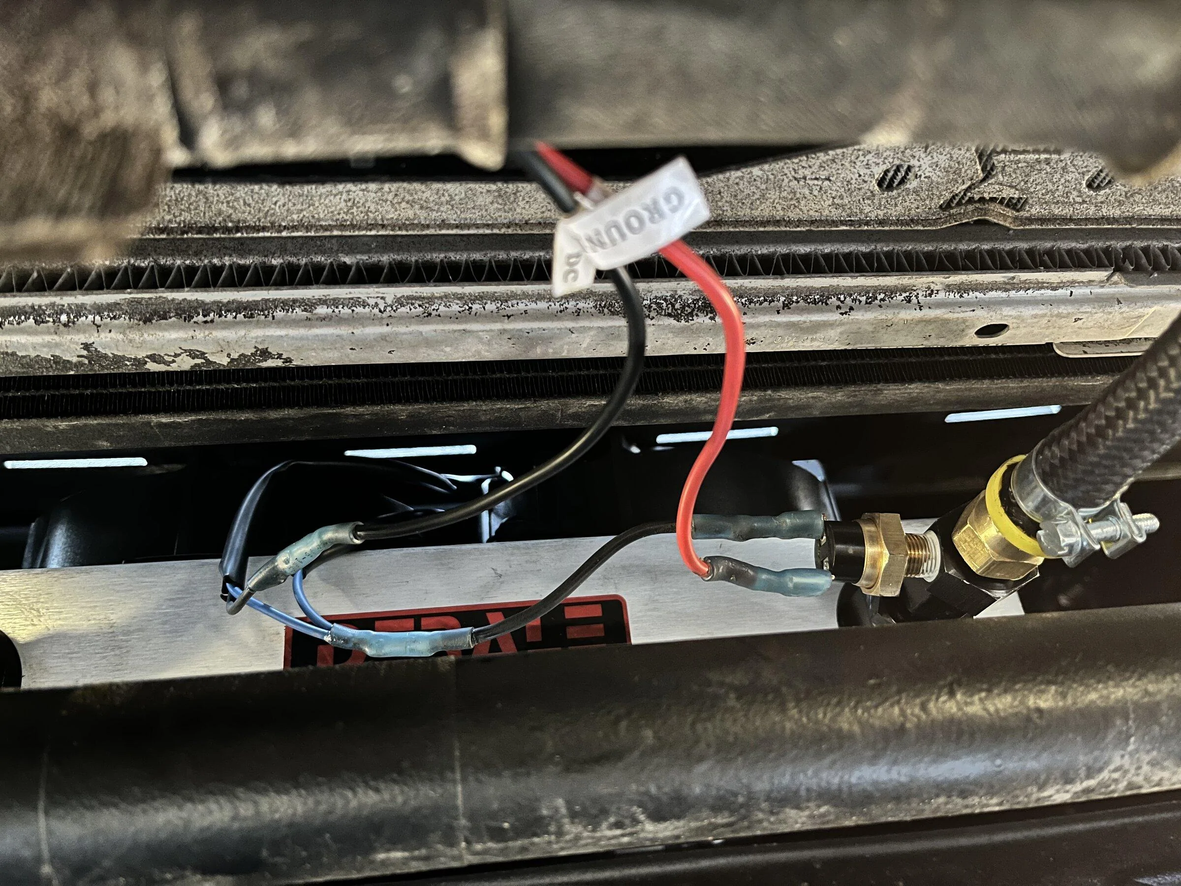

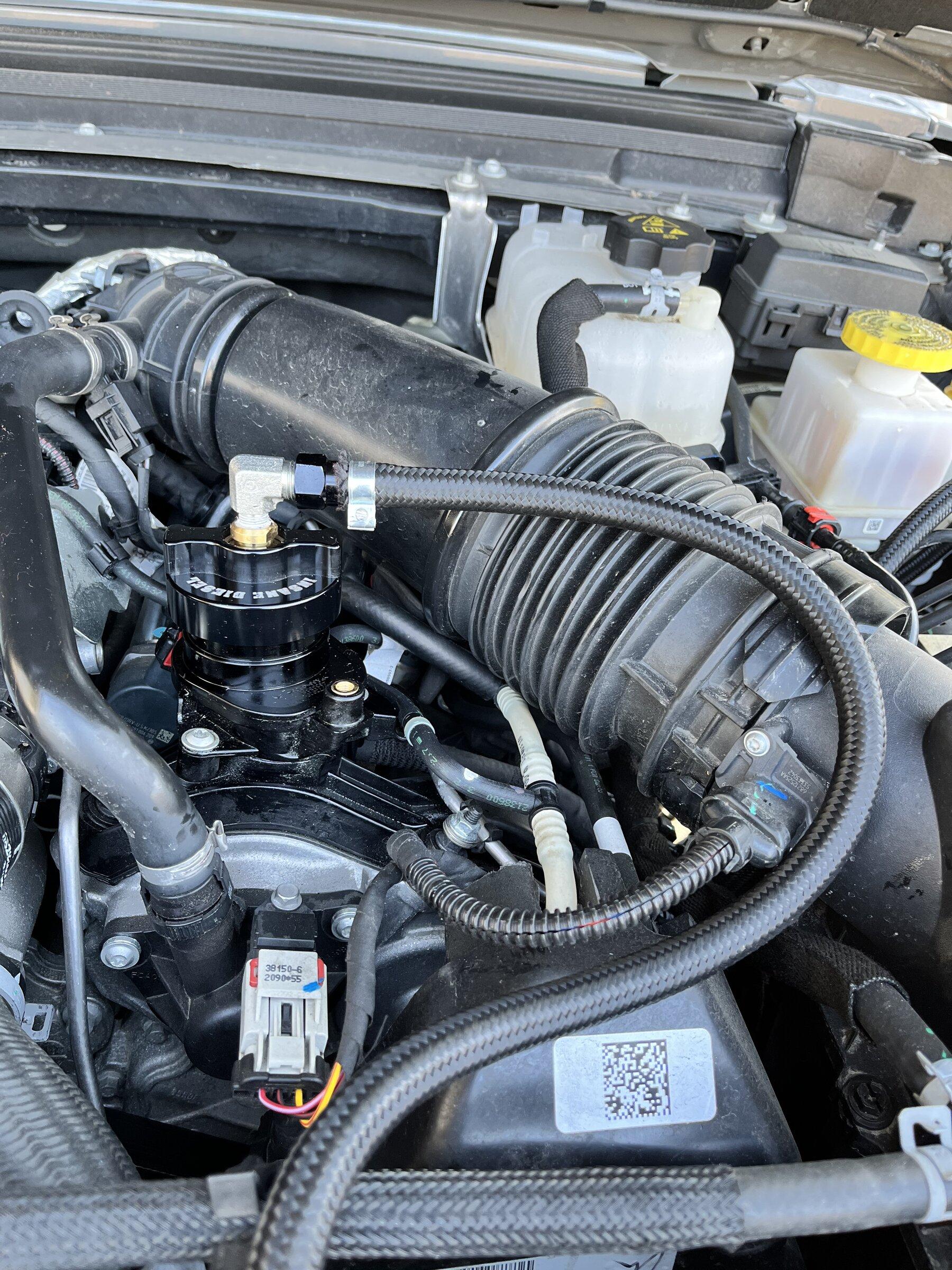

So here are some photos of the install! Filter is by the transfer case cooler is laying flat under the radiator. He made a bracket for the back of the cooler and used the rad mount for the front of the cooler. T stat on the feed side of the cooler on at 185 off at 165. Keyed on relay to feed the t stat. System fused at 7.5 amps. Hooking trailer up in a few to take her for a spin.
Jeep Gladiator Bypass filter and cooler install. 2E9F2F76-0E26-4511-846C-98AF5DB95A44
Jeep Gladiator Bypass filter and cooler install. 9C22585D-8628-4025-B306-EDBEB096CAE4
Jeep Gladiator Bypass filter and cooler install. CD328E88-B7B8-4C12-B70F-2B98A3ED1980
Jeep Gladiator Bypass filter and cooler install. 79F76EBE-3E31-466A-AA95-649C8F3FD837
Jeep Gladiator Bypass filter and cooler install. 489C5632-3502-46BE-B2C9-52E12F089204
Jeep Gladiator Bypass filter and cooler install. 65C61773-41A9-4CF9-8A7D-7A84B69C7344

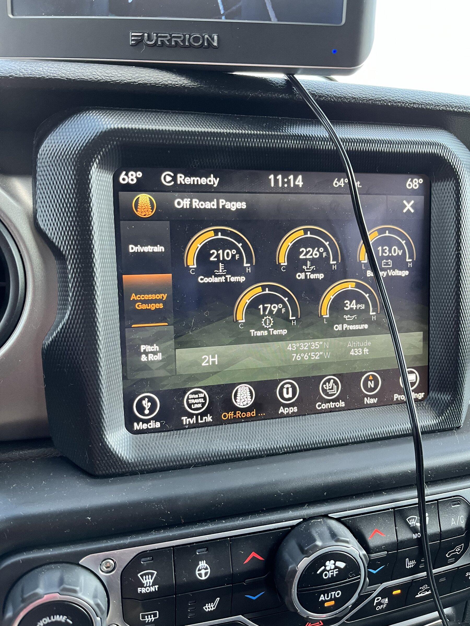

One more shot of the cooler mounting location also did a test tow this morning. Not exactly hot out but had some wicked headwind and some good hills
Jeep Gladiator Bypass filter and cooler install. B0DA0161-42C0-4B6C-A6F1-3E4D0EA6FE22
Jeep Gladiator Bypass filter and cooler install. D6A166D7-5923-449B-848A-04D4B8A4BD04

Similar to what I will pull. Think we are around 4000 dry. Looks like your set up is working! No joke on space, hardly room for the hoses let alone everything else.
What sustained speeds are we hitting here?
Glad_he_ate
Glad_he_ate
Jun 11, 2021
790
1,076
Mexico ny.
2021 gladiator Willie's ecodiesel
Union electrician
I was at 65 on interstate 81.

I might look at bypassing the t stat with a toggle. I think if I run the fan basically any time I’m towing I should be able to keep the return oil down substantially and give myself more headspace. With the oil at 213 on the dash the fans don’t even kick in. It was not till about 220 that I hear them spin. I’m guessing the oil is cooled down to the 185 on set point by the time it runs through the filter assembly and the cooler. Basically what I think is needed due to the lower volume of oil in the bypass system is either a lower set point t stat or a override switch to spin the fans any time I see the temperature climb. This first bata test today tells me it’s working and no leaks detected!! Now giving a few data points I can fine tune things as I feel necessary! I tell ya tho keep that filter assembly away from heat sensitive items. It transfers a lot of heat being aluminum! So far I’m really happy with the setup.
Glad_he_ate
Glad_he_ate
Jun 11, 2021
790
1,076
Mexico ny.
Union electrician
If I can get the return oil down to say 120* at 10%volume I would think I should see towing oil temps around 200 to 220 in hot temperatures. Obviously I don’t want to suck too much heat from the oil and send cold oil back into the sump but if I can keep it above 100 and under 130 I think that’s a safe return temperature.
