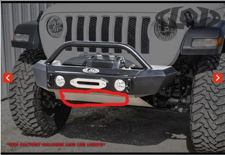

What about this cooler:
https://pitstopusa.com/i-23900721?q=setrab+cooler
Mounted in the red section on this bumper:
Jeep Gladiator Bypass filter and cooler install. InkedScreenshot 2022-04-12 at 09-39-43 LoD Offroad LoD Offroad JL_JT Signature Series Shorty
Mounted inline to the factory oil cooler lines so it passes through the radiator fluid heat exchanger then through this cooler then return to engine? I believe that is how it functions now with a radiator oil cooler, correct?
I would cut a hole in the skidplate and put some protective mesh.
This would give you full flow and much more CFM through the cooler?

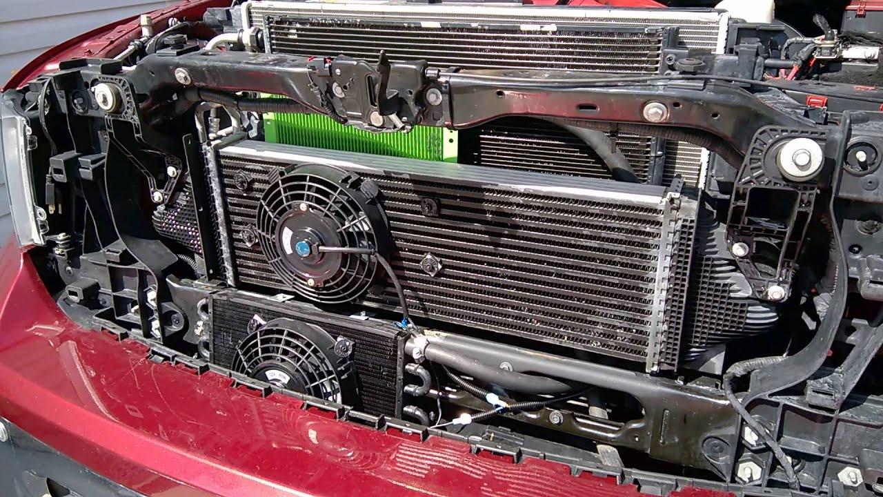

Nothing to reach close to the level of the ram 1500 cooling that owners get easily:
Jeep Gladiator Bypass filter and cooler install. ecodiesel cooler

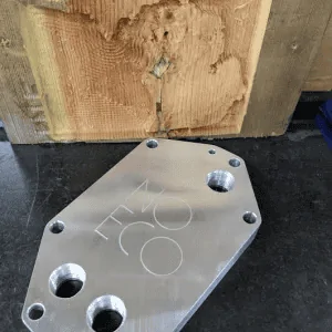

I wonder how much different the 2 gen is to the 3rd gen in regards to the factory oil cooler. There is a company up in Canada that makes an oil cooler adapter plate. If there is no difference between the 2 generations. It would be simple to run 2 hoses and a cooler.
https://noecodelete.com/shop/
Jeep Gladiator Bypass filter and cooler install. 1649797201958

You would have to cross reference the two oil cooler/ filter housing part numbers. I have not done that yet.

You said its a 10% bypass? How is the flow controlled to your cooler? Like when does the bypass open is it pressure related?
I ilke the idea of that plate that deletes the problematic FCA oil cooler setups. With that you could bend some hardlines then swap to AN lines and put a cooler with full flow somewhere thats air cooled and isolate the oil from the coolant system.
That seems like a really strong setup. Plus it will only push the same amount of oil factory and return it immediately into the engine.
Now we are cookin.

I don't see how we could find the space for an oil/air cooler large enough to where we could eliminate the OE installed oil/water cooler while still have it tucked into a place protected from airborne debris.
I still think the best solution is just adding in a small aux oil/air cooler.
Except that the factory oil cooler is water cooled with the radiator....which is usually heating your oil. Separating it to an outside cooler with vans would help ALOT and take the load off the radiator cooling. Did you see the bumper I posted above with a large lower skid plate? That does hang low but the skidplate and lower frame horns would protect it. You could possibly carry a bypass hose in case of trail damage?
