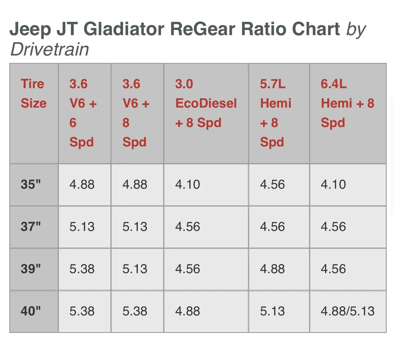

found this on exodus4x4.com. A shop that does a ton of gears.
Jeep Gladiator Called my dealer for a regear quote… E3127A27-1A7C-4EE9-B892-37C29B891596

Not bad, but they seem not deep enough for some.
5.13 with 39s, you're only going to be turning ~2,100 RPM at 70.
That's a definite lean toward off road performance.
NO WAY would I install 4.56's in a JT Eco on 37's! I have 16K miles on mine with 5000 miles of that towing trailers 4k+ in the steepest country of CA, NV, CO, UT, and still think 3.73's are a perfect balance.
I wasn't paying much attention to their diesel recommendations.
Weird how they recommend 4.56 for the diesel and 37s, but then recommend 5.13 for a gasser on 39s. Too low for the diesel, not low enough for the gas.
It's all subject to someone's opinion!
Exodus has a cool YouTube channel and works some big builds, but I wouldn't let them touch my Jeep. I fact, after watching videos of gear installs done by Dynatrac and Yukon....I have seen things that I wouldn't do in my own shop.....these guys are the "Experts"? I can only imagine what goes on in these high volume discount gear installer's shops........
