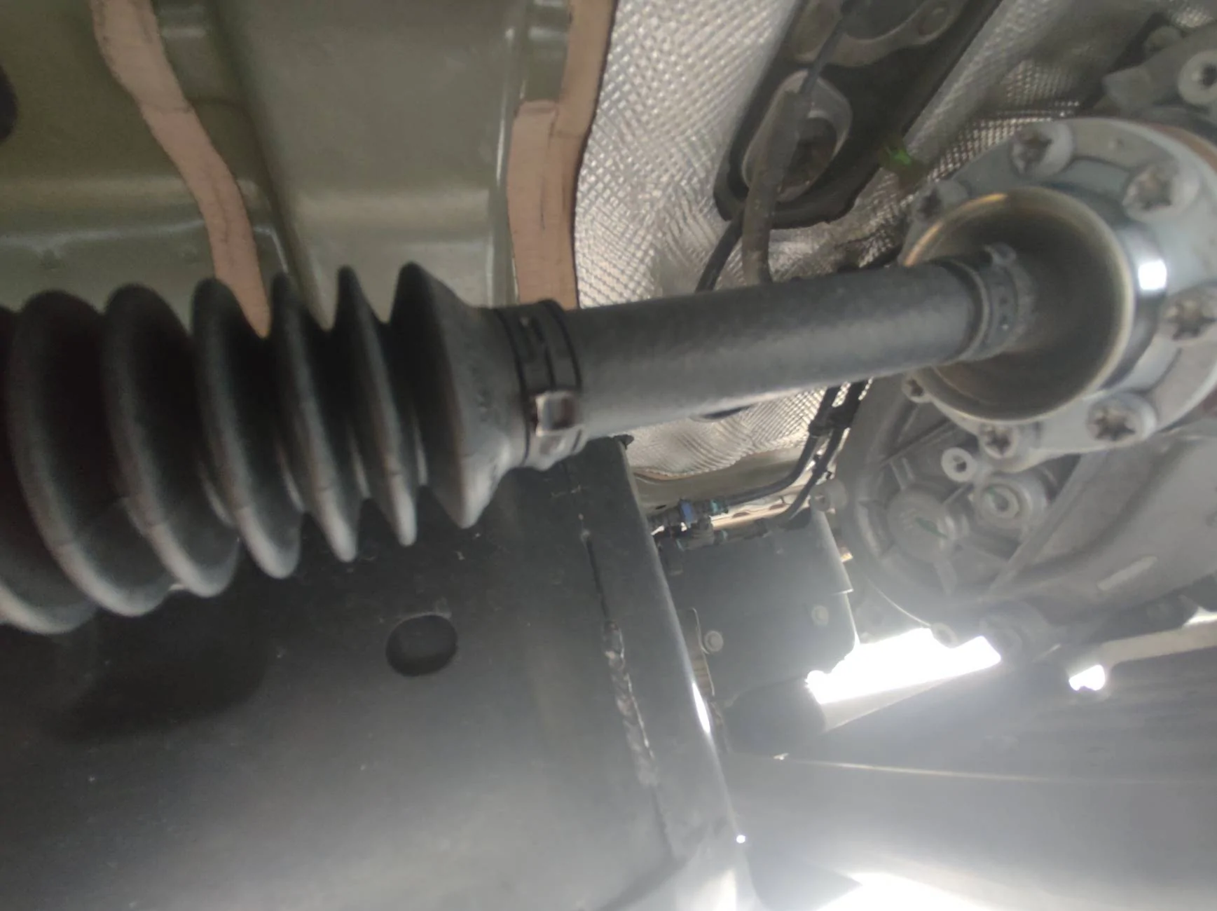

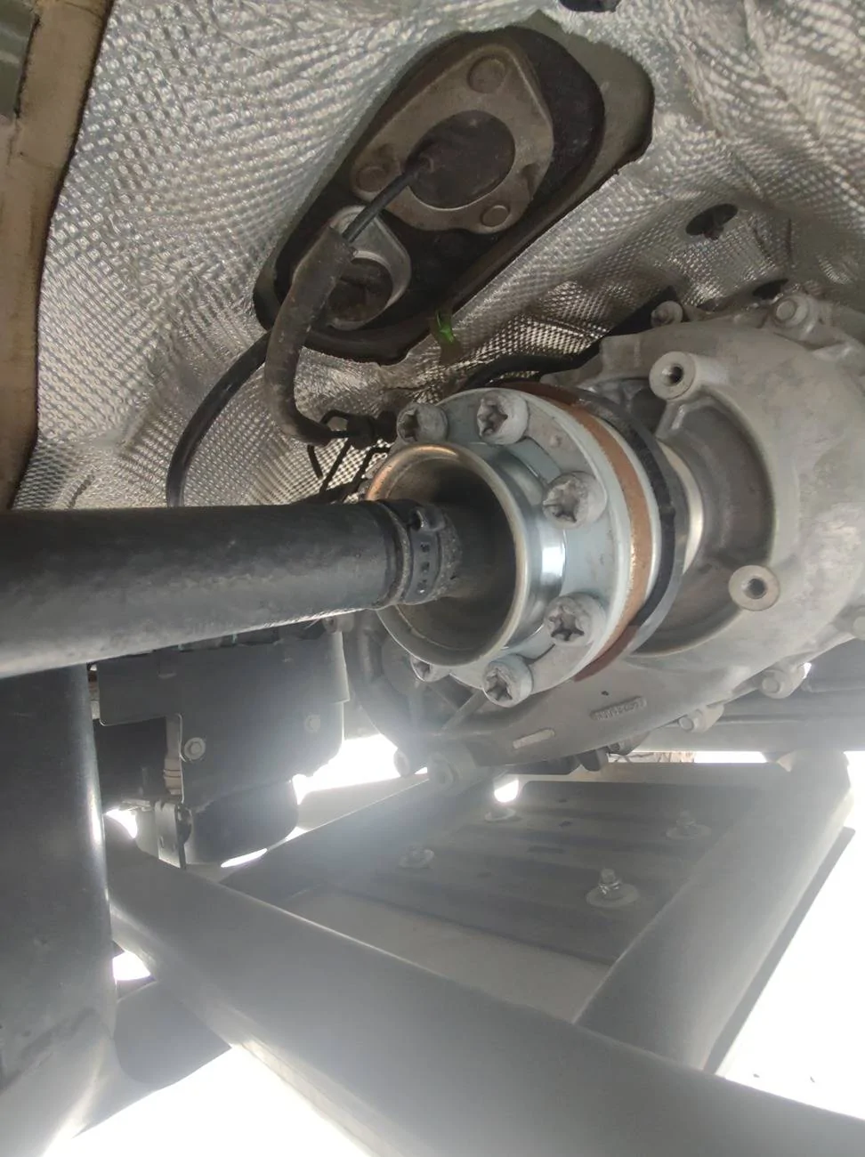

Not really. Unless you make your pinion angle worse in the opposite direction. You’d have had to be at a zero angle for that to happen. Can you please share a picture of your driveshaft at the pinion end, at ride height? Thanks.

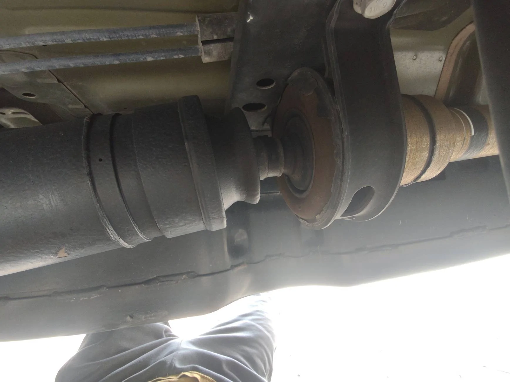

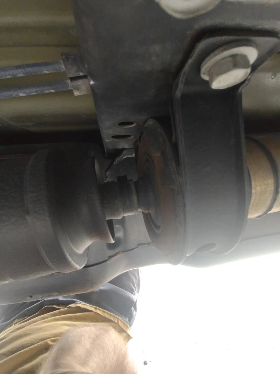

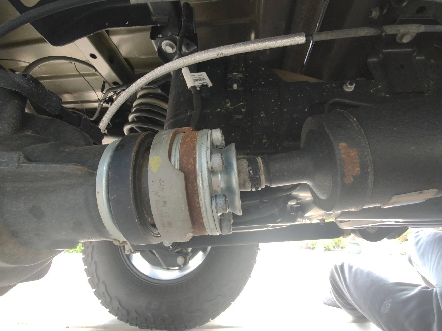

Jeep Gladiator Carrier bearing spacer for rear driveshaft IMG_20250430_112053473
h
Jeep Gladiator Carrier bearing spacer for rear driveshaft IMG_20250430_112036861
Jeep Gladiator Carrier bearing spacer for rear driveshaft IMG_20250430_112010933
Jeep Gladiator Carrier bearing spacer for rear driveshaft IMG_20250430_112001869
Jeep Gladiator Carrier bearing spacer for rear driveshaft IMG_20250430_111934637

The spacer gets 25 ft lbs with blue loctite.
Well hell then the specs that rock jock give are wrong along with their socket sizes. Directions say 15mm and 16mm. Mine were 16 and 17 torque specs say 55 lb. So that's what I used plus some blue loctite
I’ll look for my Dana instructions. I was admittedly doing that from memory.
