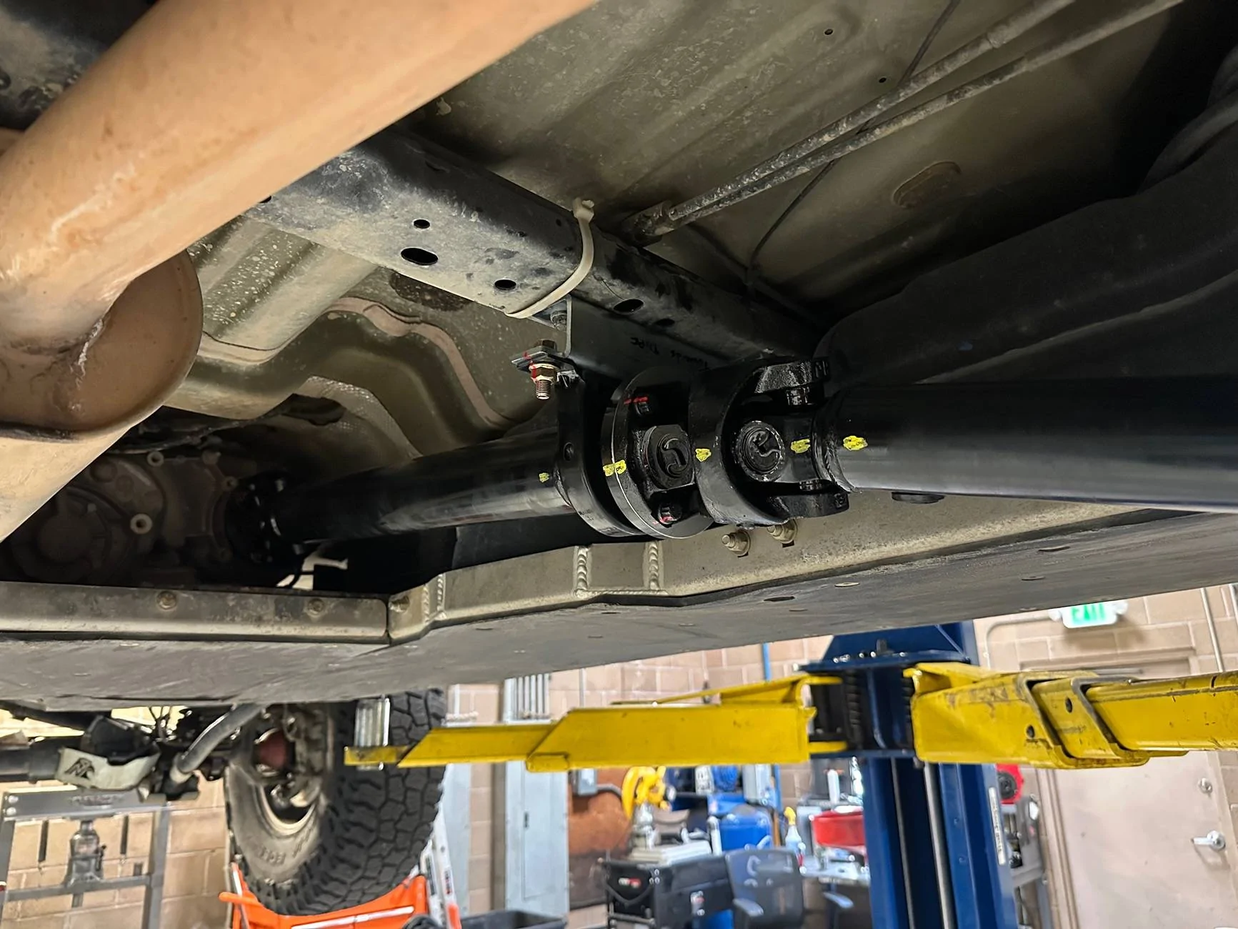

Here’s a picture of the one from Adam’s. The offset makes a tone of difference with clearance. The reason for the angle of the rear section is droop. It’s on a lift getting new rear end bearings and seals in march.

I've seen those for pickups but did not know they made them for jeeps.
definitely something to look into.
