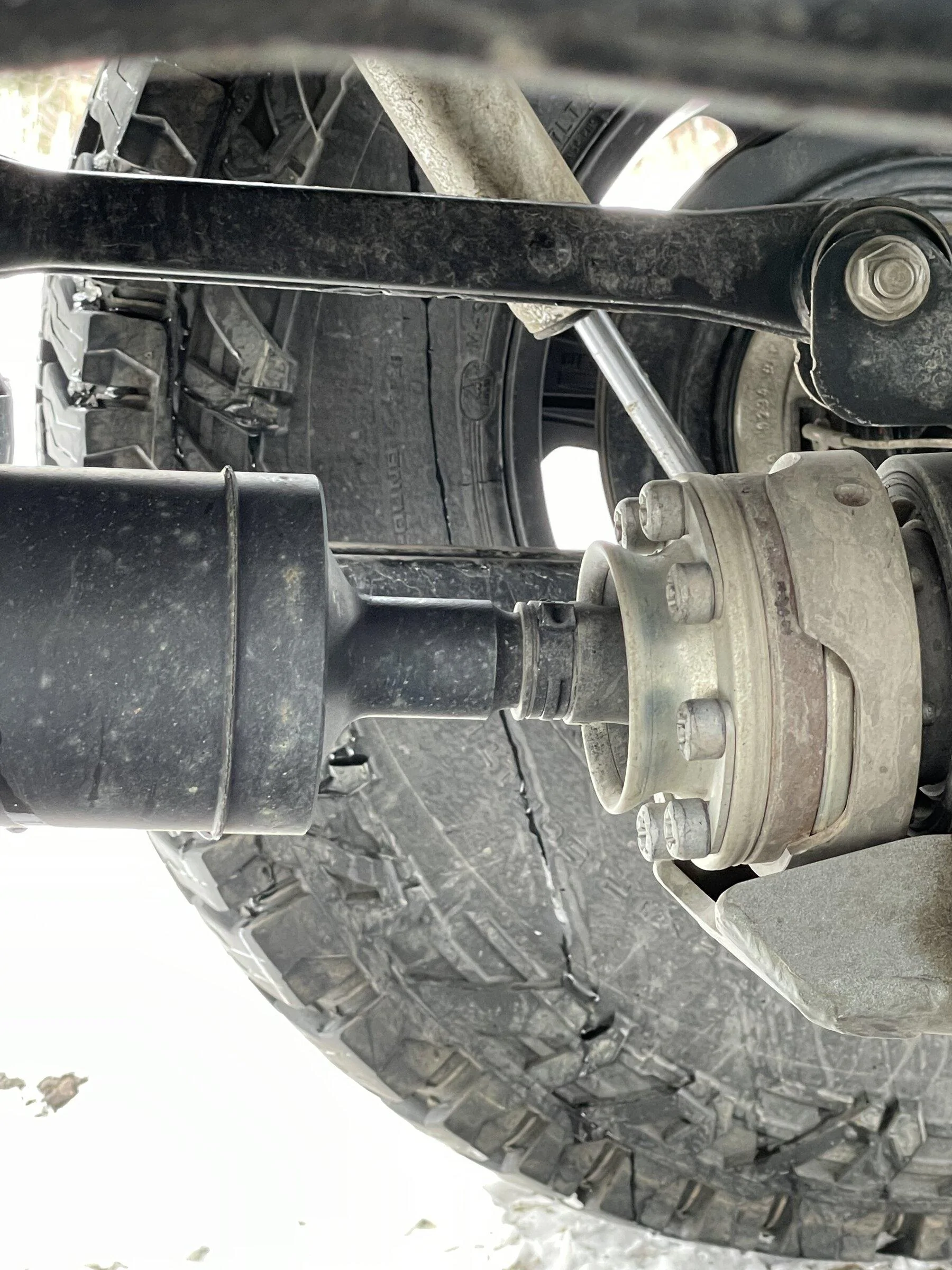

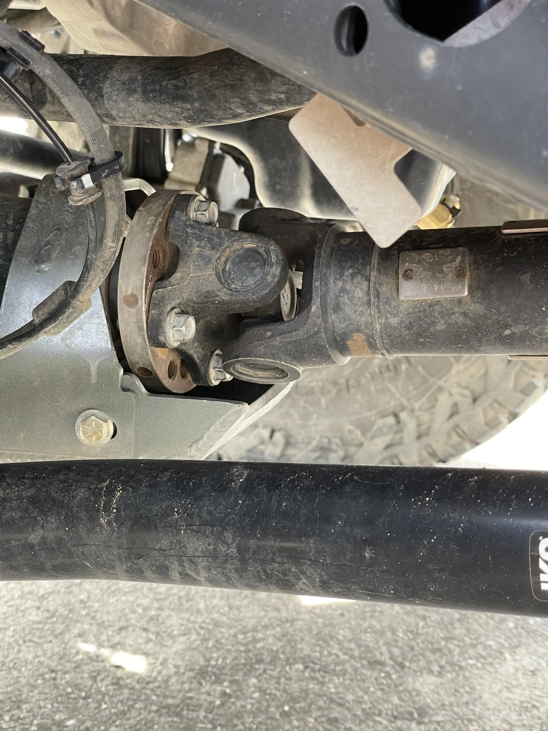

By looking at this picture of the drive shaft connection to the rear diff, can someone tell me if a spacer would be necessary? I really like the idea, but don’t know enough about the angles, as zero is apparently bad as well. If not, thanks anyway.

If the rear is lifted more than 2 inches with stock arms, you can benefit from a spacer. It looks like you need one from the photo but its best to measure the difference between the shaft angle and yoke angle to be sure.

The rear is stock control arms and 3.5-4 I’d guess. It started with the 3” JKS lift, but I have ram 1500 springs in the back as an add on, so it’s likely 4 in the back. Any opinions between the rock hard and Dana spicer options? I’d probably lean towards Dana if no one has a good reason otherwise.

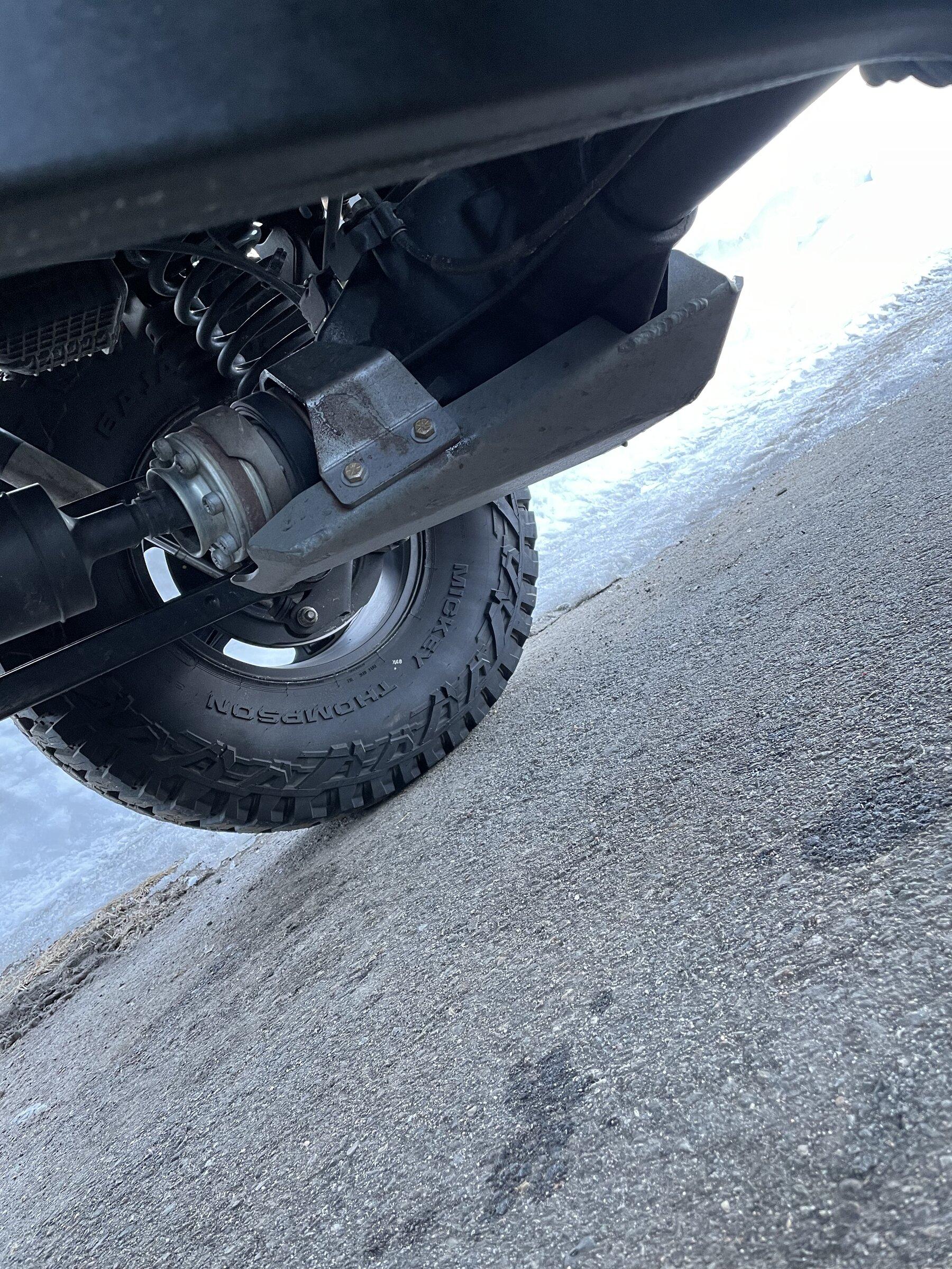

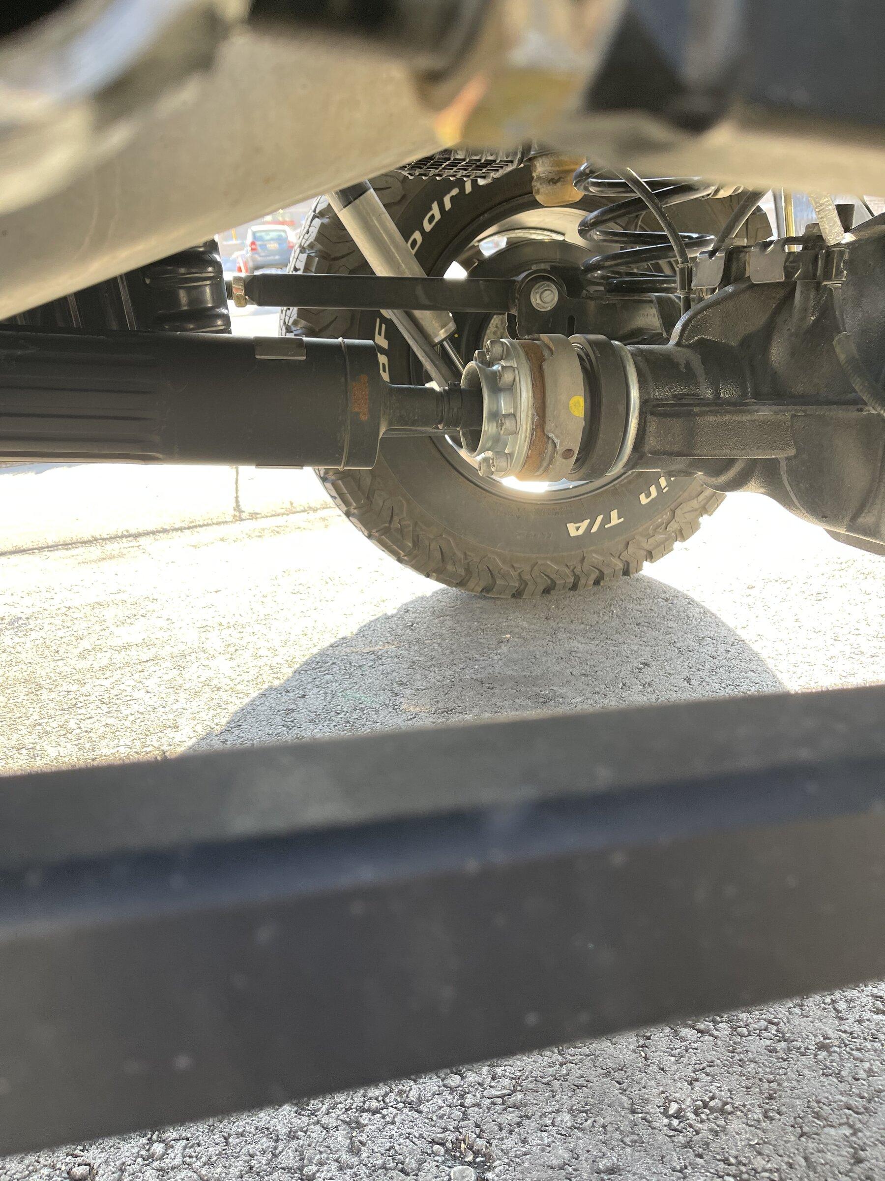

Anyone have a picture of a stock rear pinion angle to diff? This is mine with the Clayton 2.5” lift. I also bought the rock jock spacer, yet to install it though.

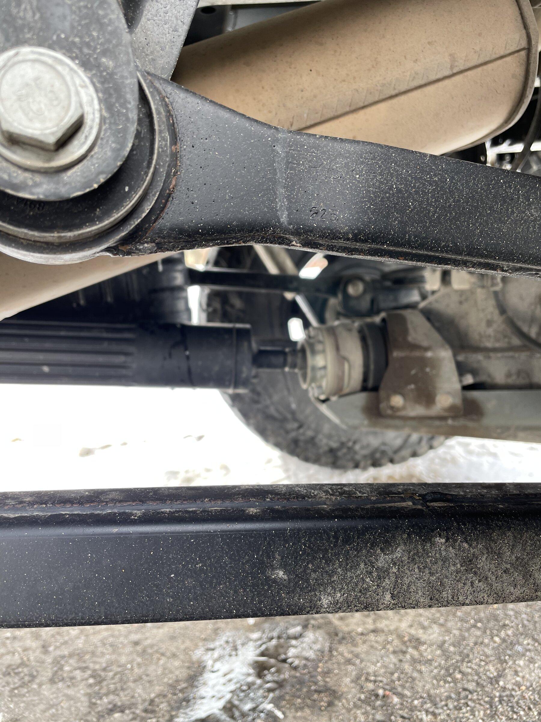

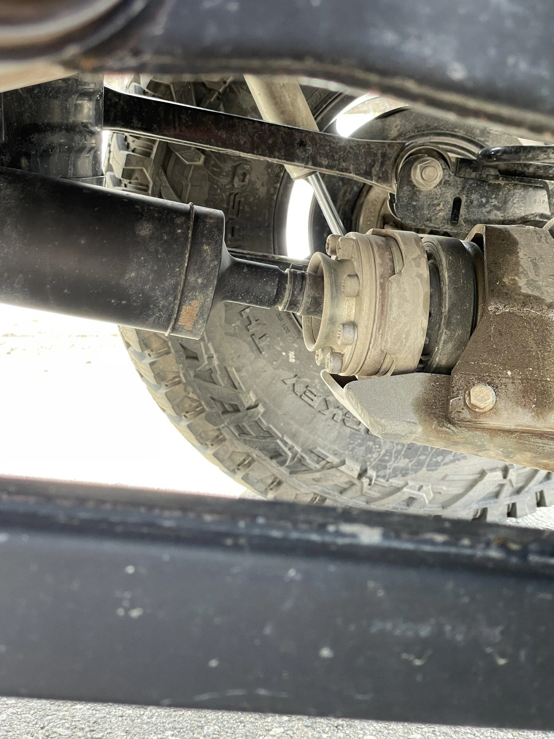

Yours looks super tame compared to mine. If mine looked like that I wouldn’t bother with a spacer I don’t think. But if that’s 2.5, and mine looks the way it does. I’m getting one. Here’s my front picture. Harder to judge with u joints visually.
Jeep Gladiator Carrier bearing spacer for rear driveshaft 7D6A9E0E-A70D-4D9E-880A-53407DE95DCF

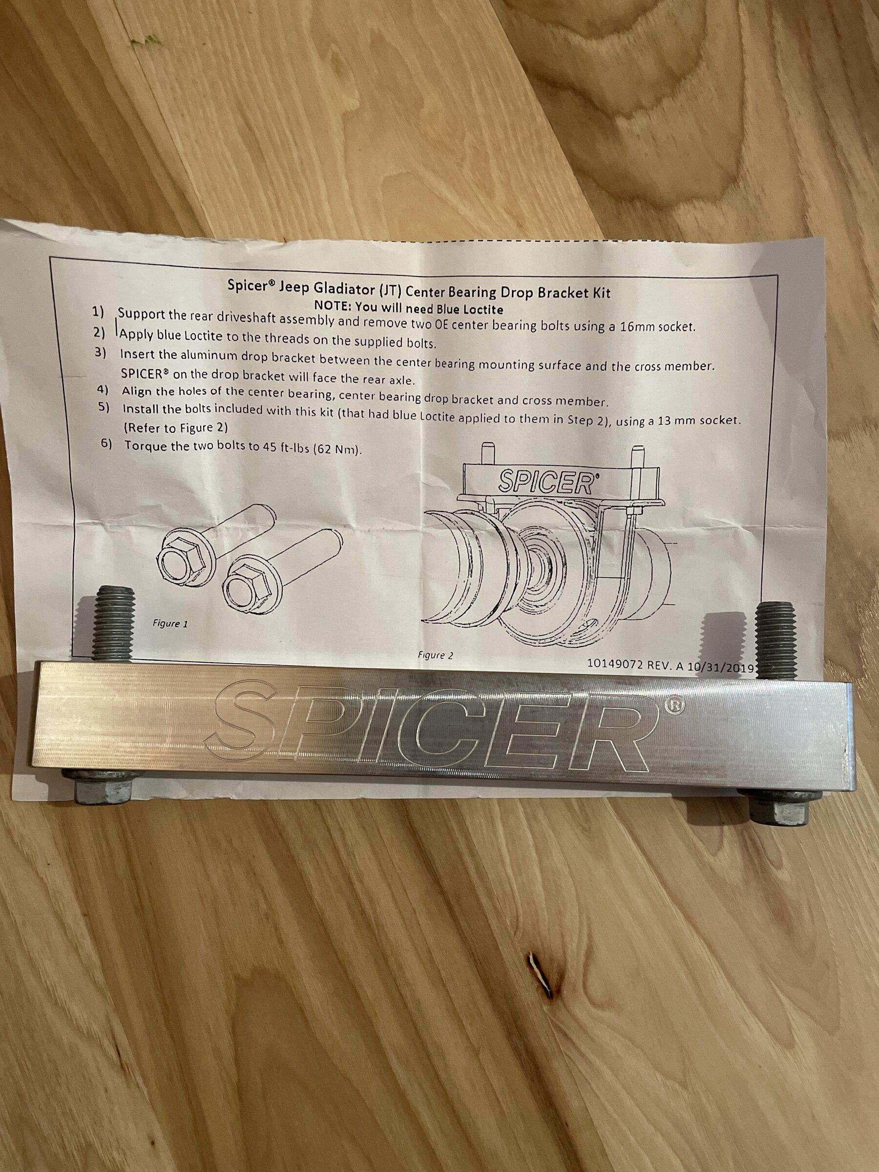

This just arrived. When it’s warmer later this week I’ll throw it on. Looks like a 20 min job max, but don’t they all. Thanks for the heads up on this everyone.

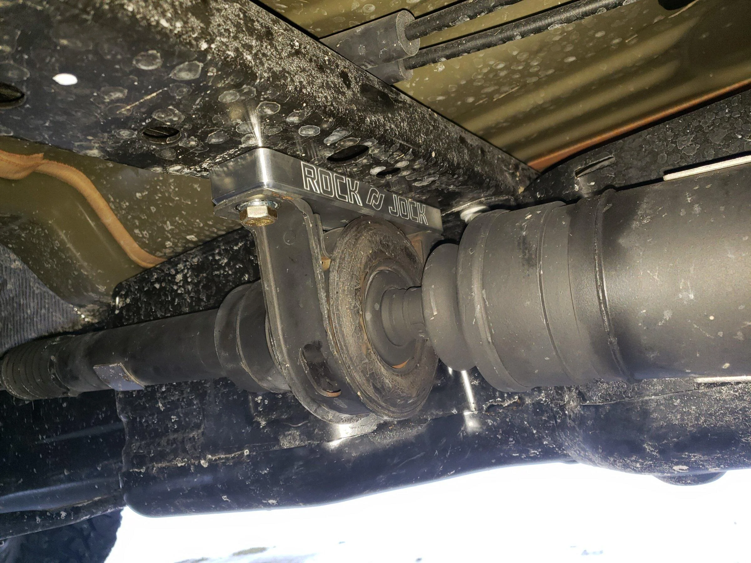

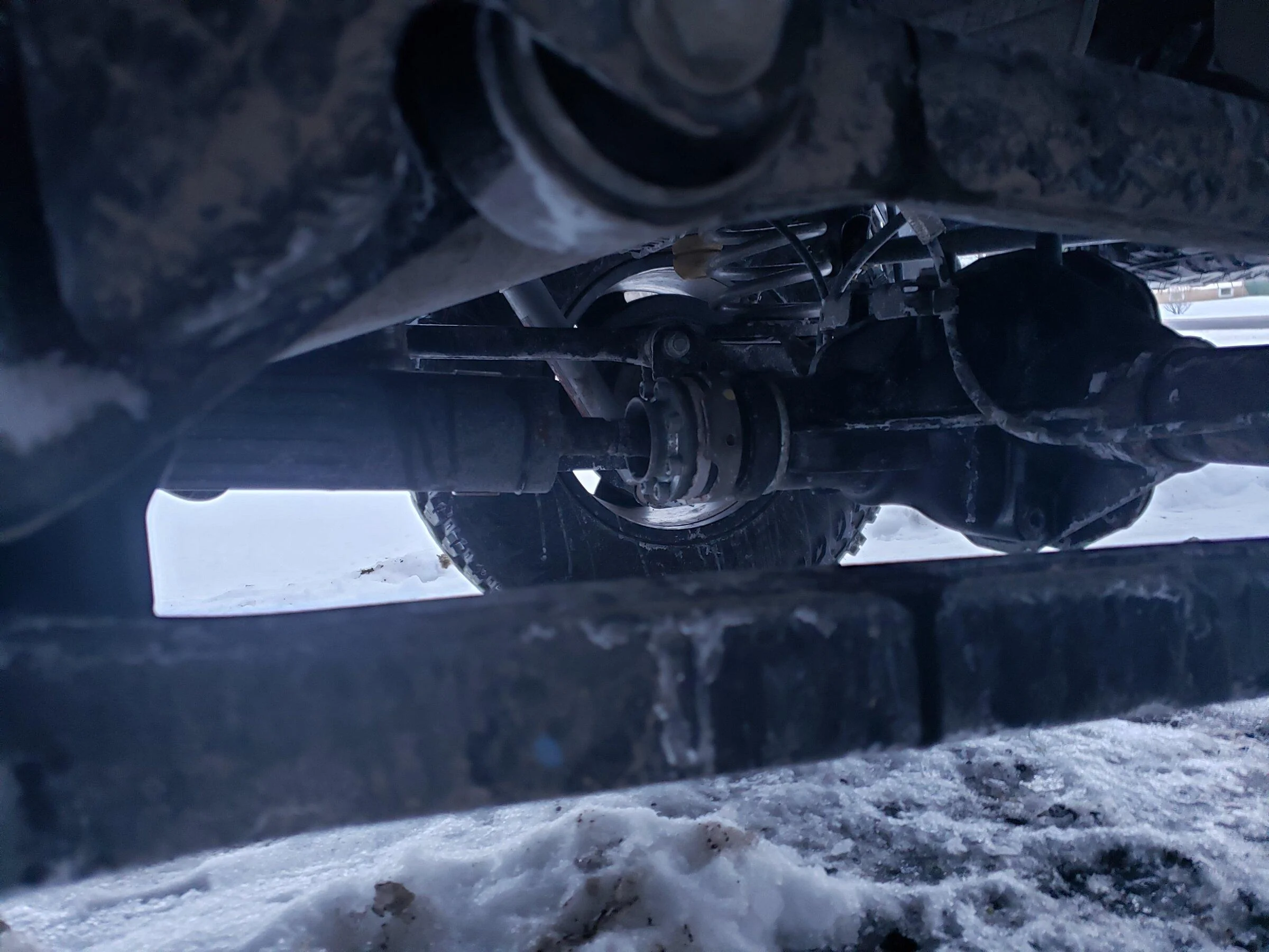

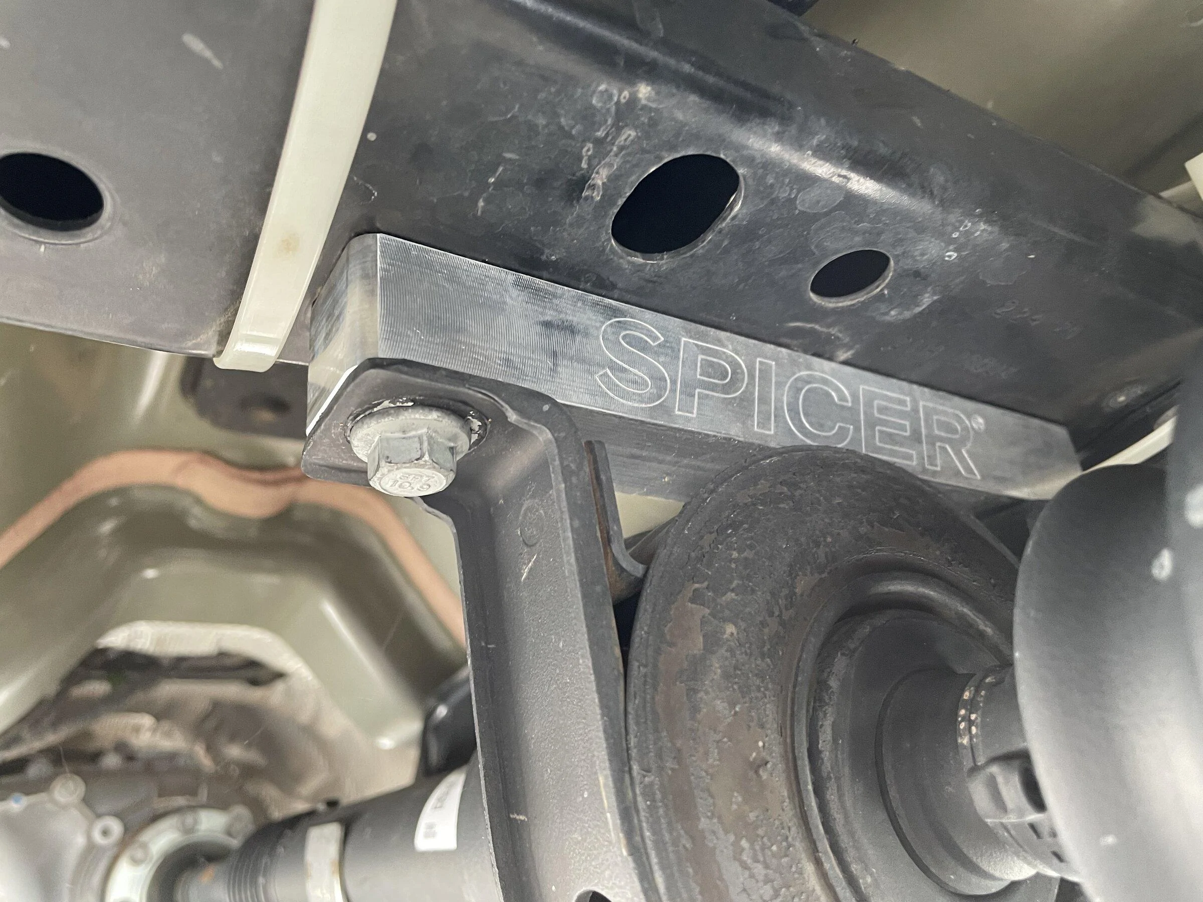

Threw it on today. Very easy. 10 minutes. No issues I can see. Did maybe 25 miles with a max speed of 65 so far, but no vibrations. Here’s the before and after pictures of the pinion angle, along with a picture of the spacer installed. The pictures aren’t perfect. The angle is way better at the bearing. 45 ft lbs didn’t seem very tight, but I trust my wrench and used blue loctite.
Before
Jeep Gladiator Carrier bearing spacer for rear driveshaft 20F19BE9-D012-4AE1-BA5D-0751C689336F
After
Jeep Gladiator Carrier bearing spacer for rear driveshaft EFF1A53F-4F2E-411A-850C-C6868A6008D9
Jeep Gladiator Carrier bearing spacer for rear driveshaft 728CC9EB-9AA9-46F2-8DE3-AE208ED3FD8F
Jeep Gladiator Carrier bearing spacer for rear driveshaft CF282D3A-9D12-494B-9882-C6A7D02B727F
