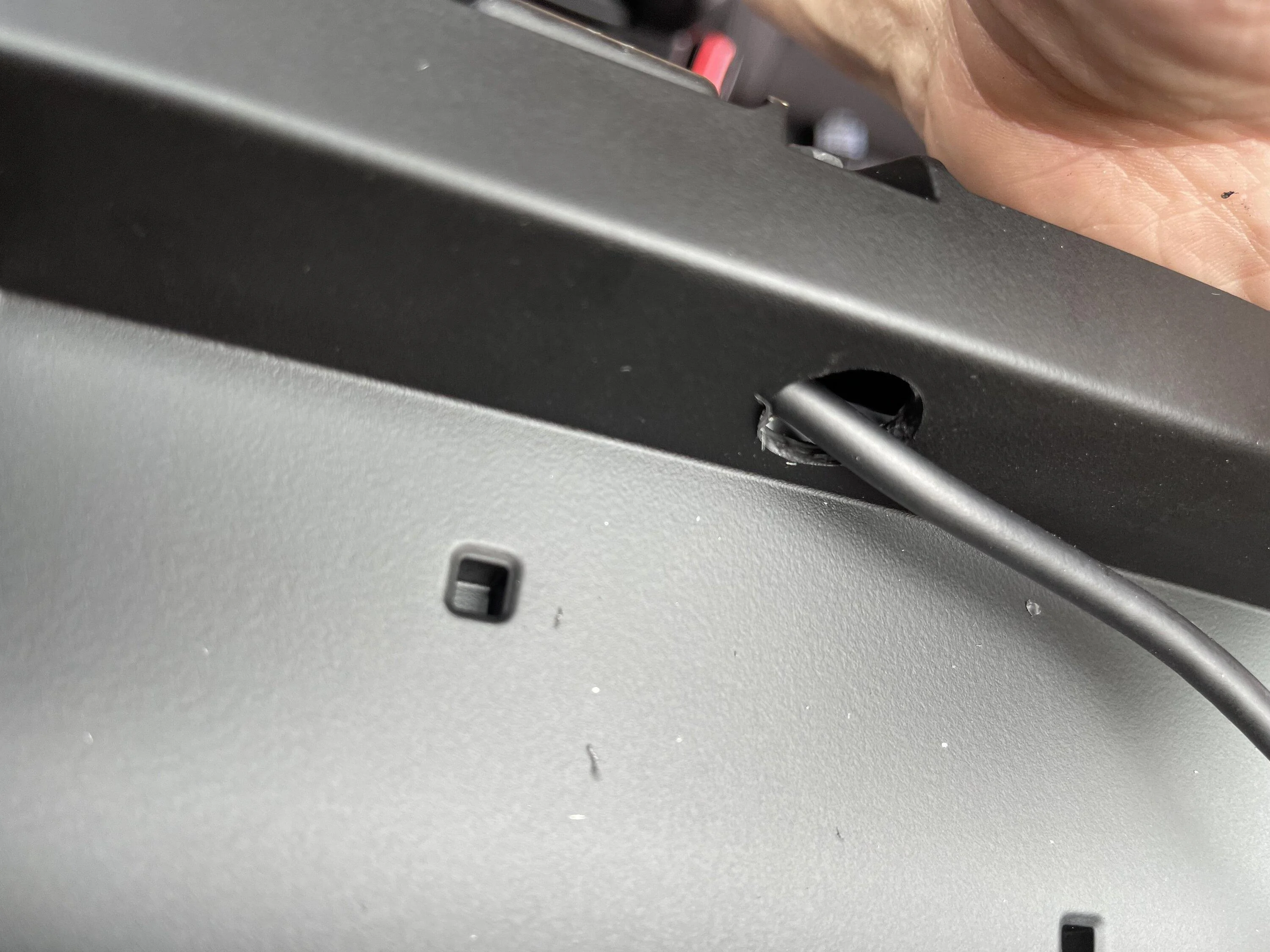

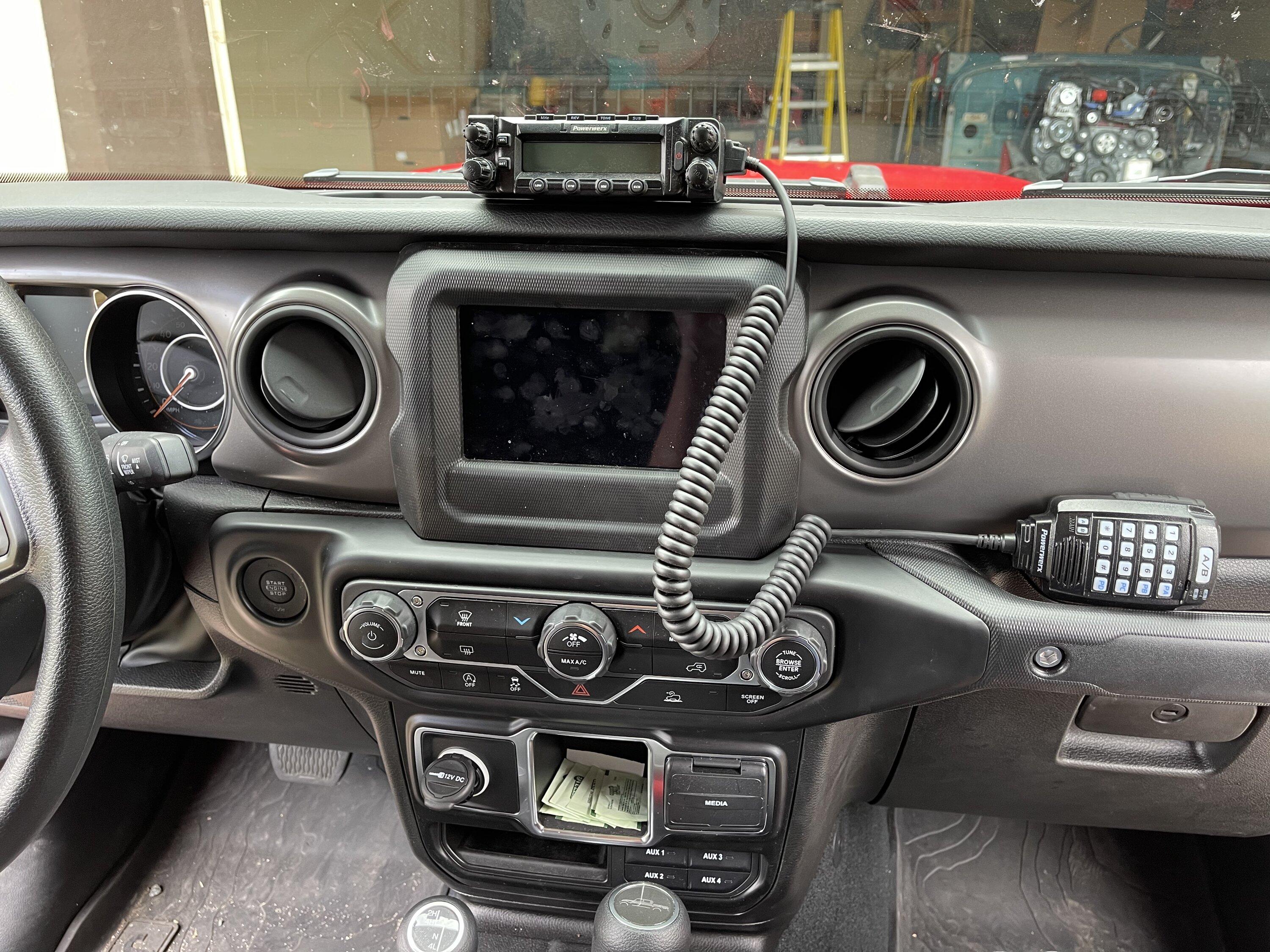

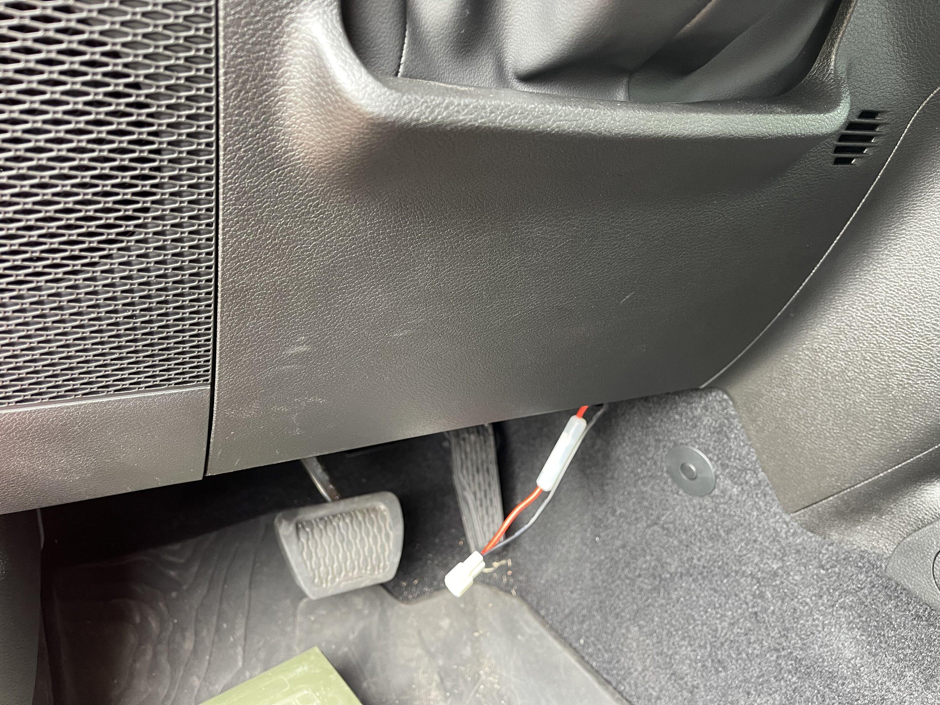

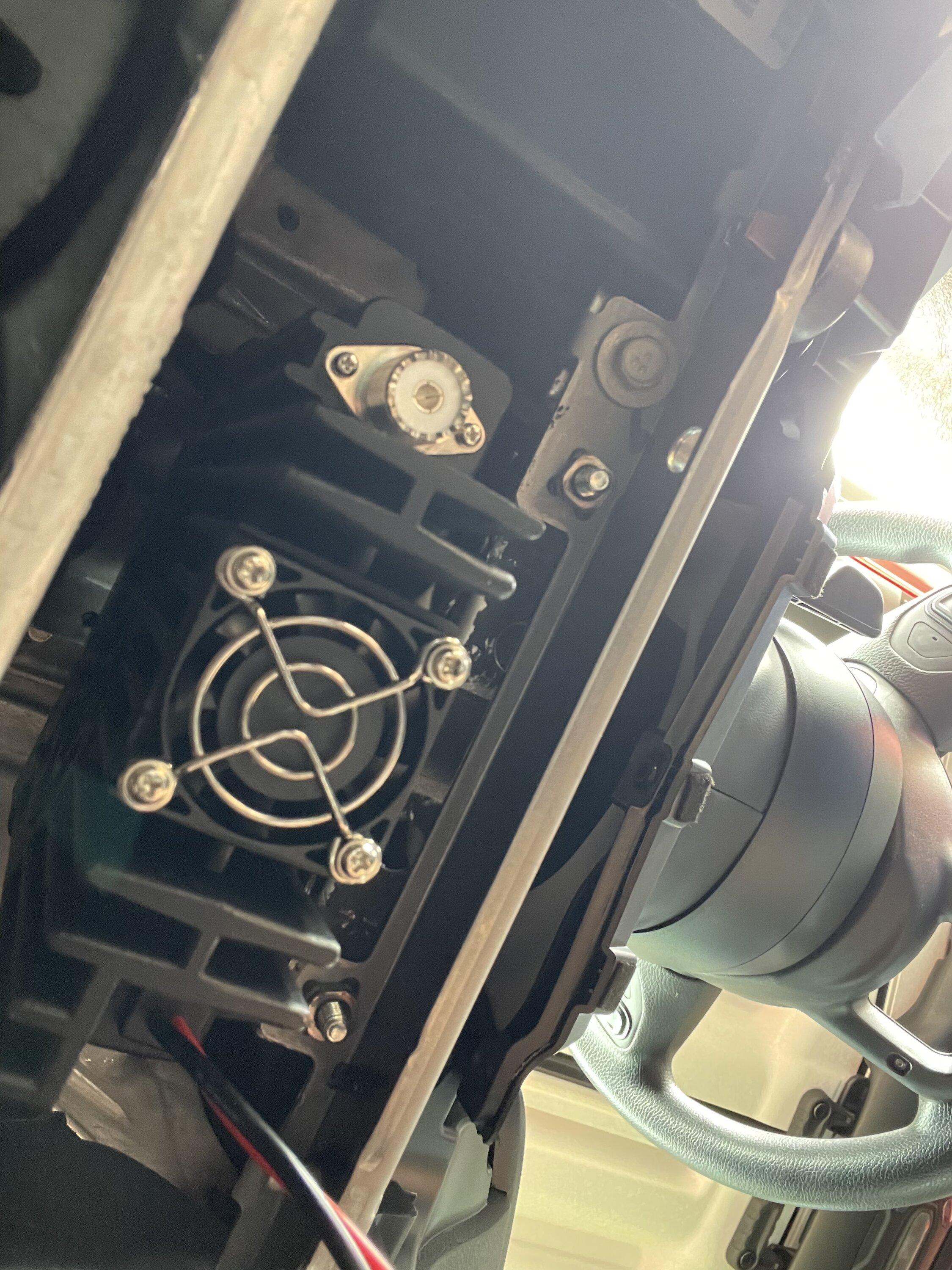

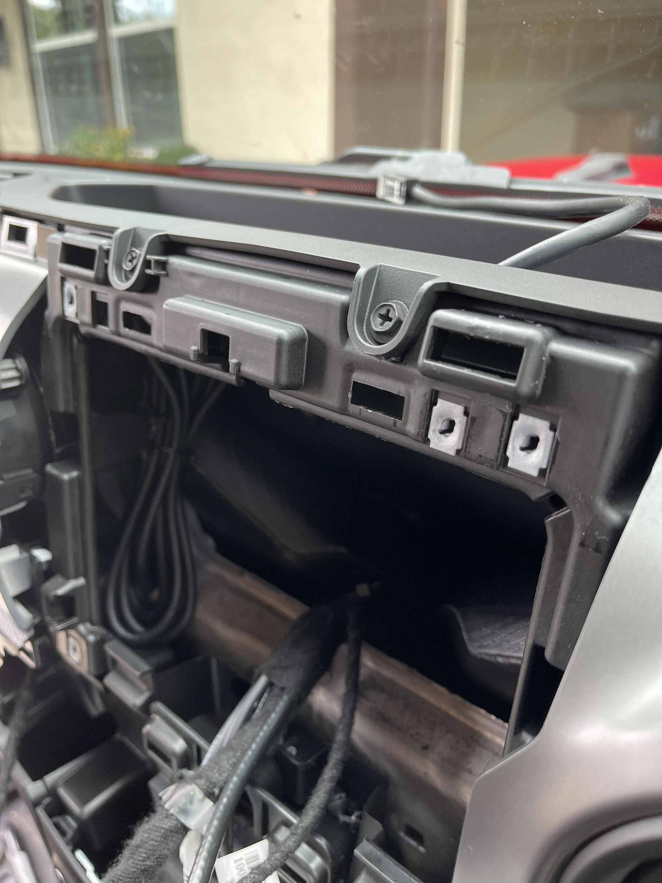

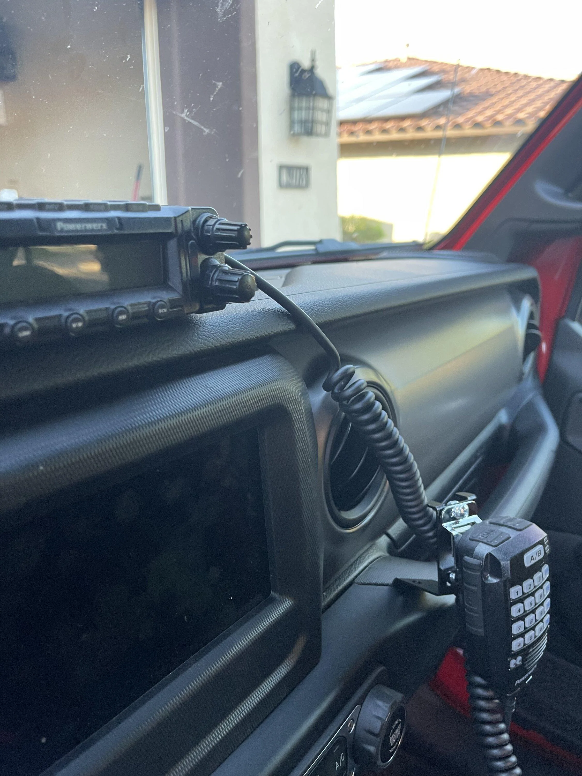

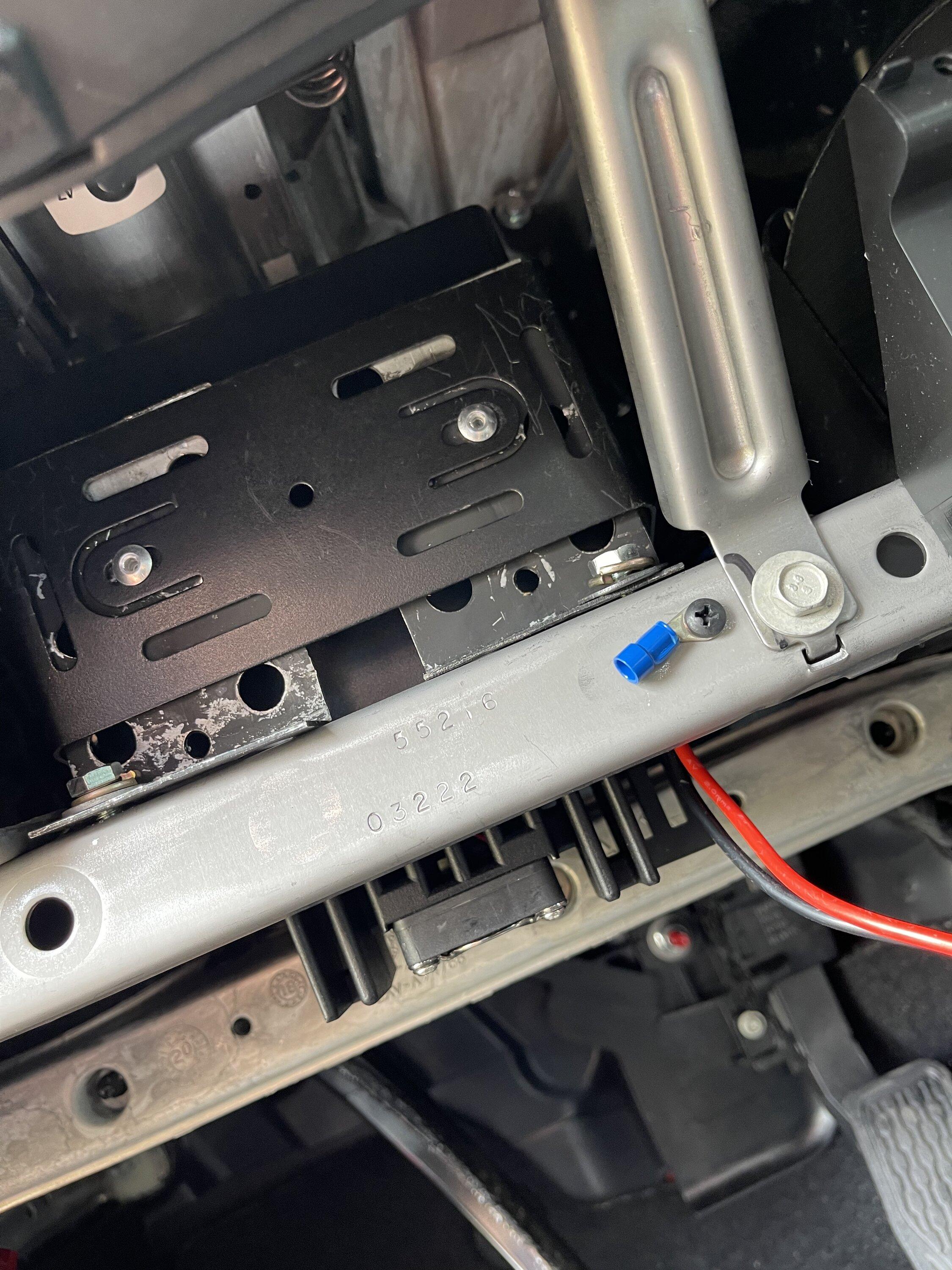

Dual band VHF UHF Powerwerx DB750X and Diamond dual band with UHF connector.
Clean instal. Easy. Only made a hole in plastic tray blind side and the firewall plastic plug for antenna and power. Wire to battery.
Topsy antenna mount and mike hanger. You can see where I mounted the antenna so that it works. Bullet point mounting solutions in the mail.

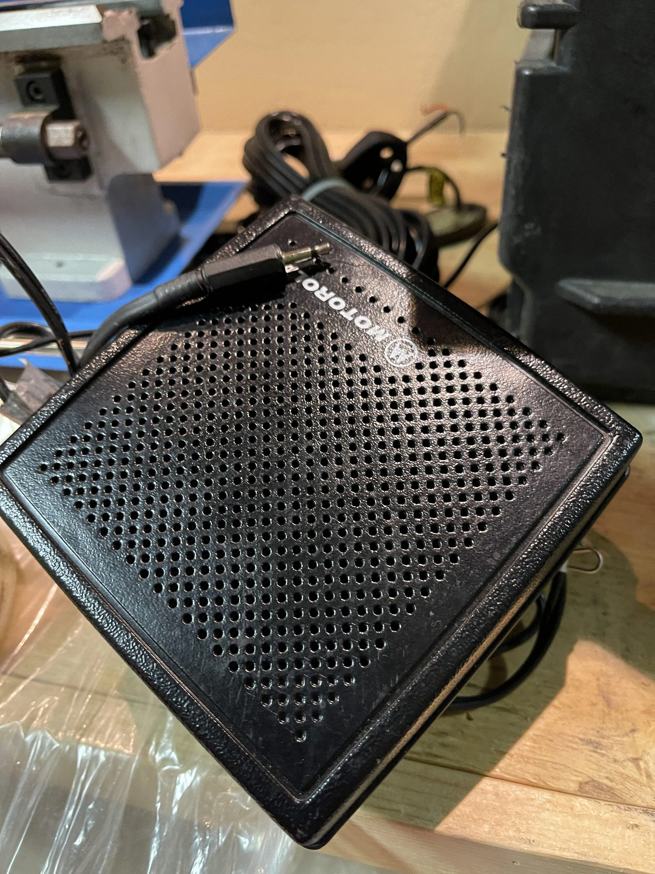

Motorola speaker and improved power distribution next to do. Debating where to put speaker. On sound bar or to the junk tray under rear seat or ??

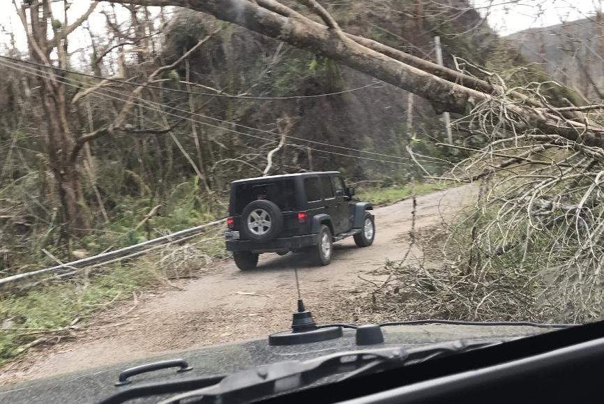

I added a photo of me driving a JKU in Puerto Rico after Irma and Maria hit. The JL/JT have alum hoods so don’t waste time and money doing a mag mount in the meantime. Also note , low hanging trees and wires. Things I’ve learned in my experiences make me decided on certain things. Like not have a tall vehicle would be one. And why more than one comms are important. At least for a while no mosquitos and every tree had an iguana perched on it.
Been eyeballing that radio….would love to hear your thoughts on in once you have some time with it. And, been trying to figure out where to put a speaker as well. Good luck! :)

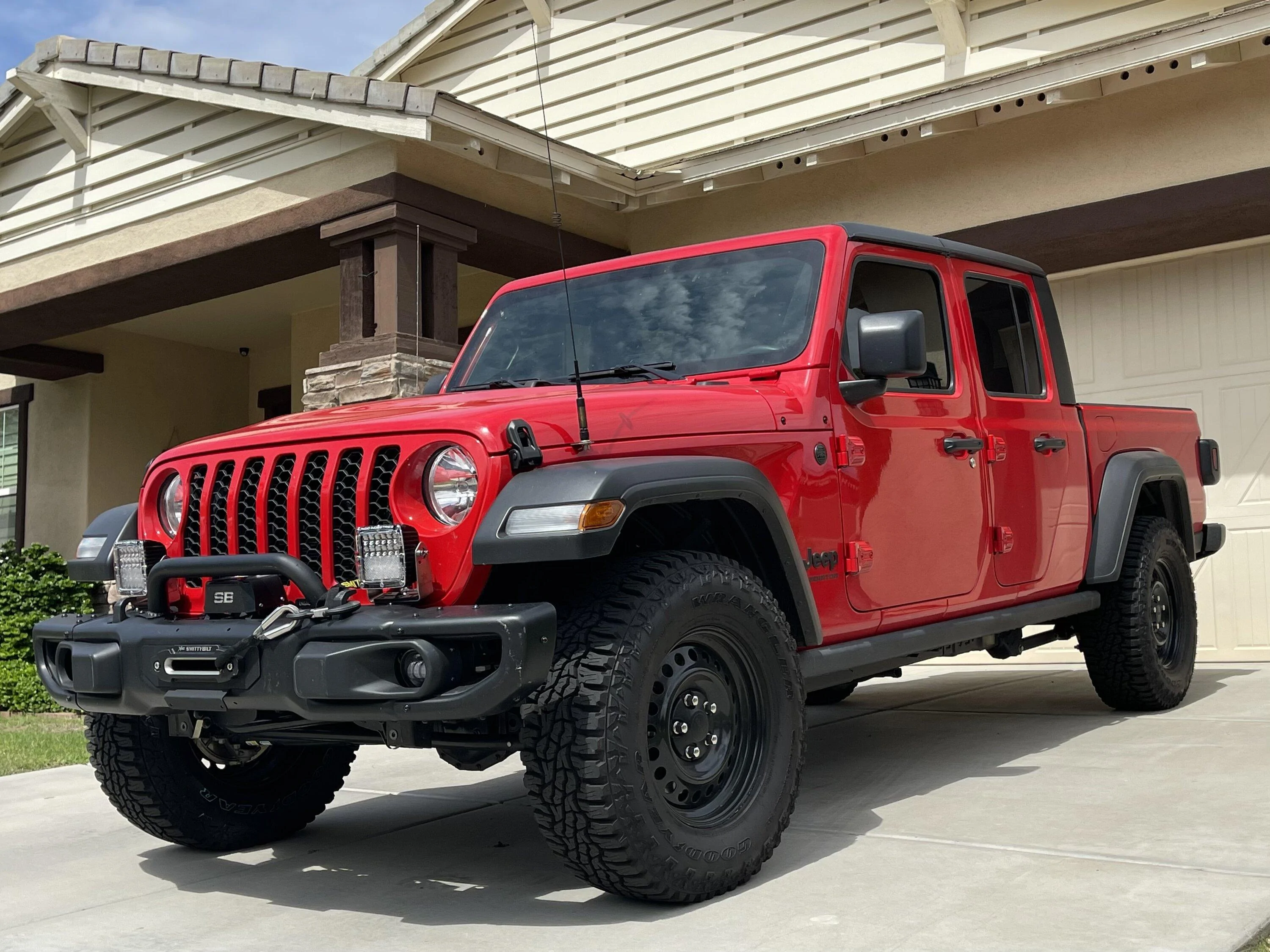

I grabbed this guy. So simple it's stupid and works quite well. I'm just using it for a ghost antenna, anything over 3 feet (like my CB antenna) and I'd use something different mounted behind the cab.
https://www.amazon.com/gp/product/B07W5XHRY2/
I have this mount too (or identical anyway) and only issue I had was I needed to dremel the antenna mount hole larger to fit the RF antenna to it. It's a great location, and out of field of vision.

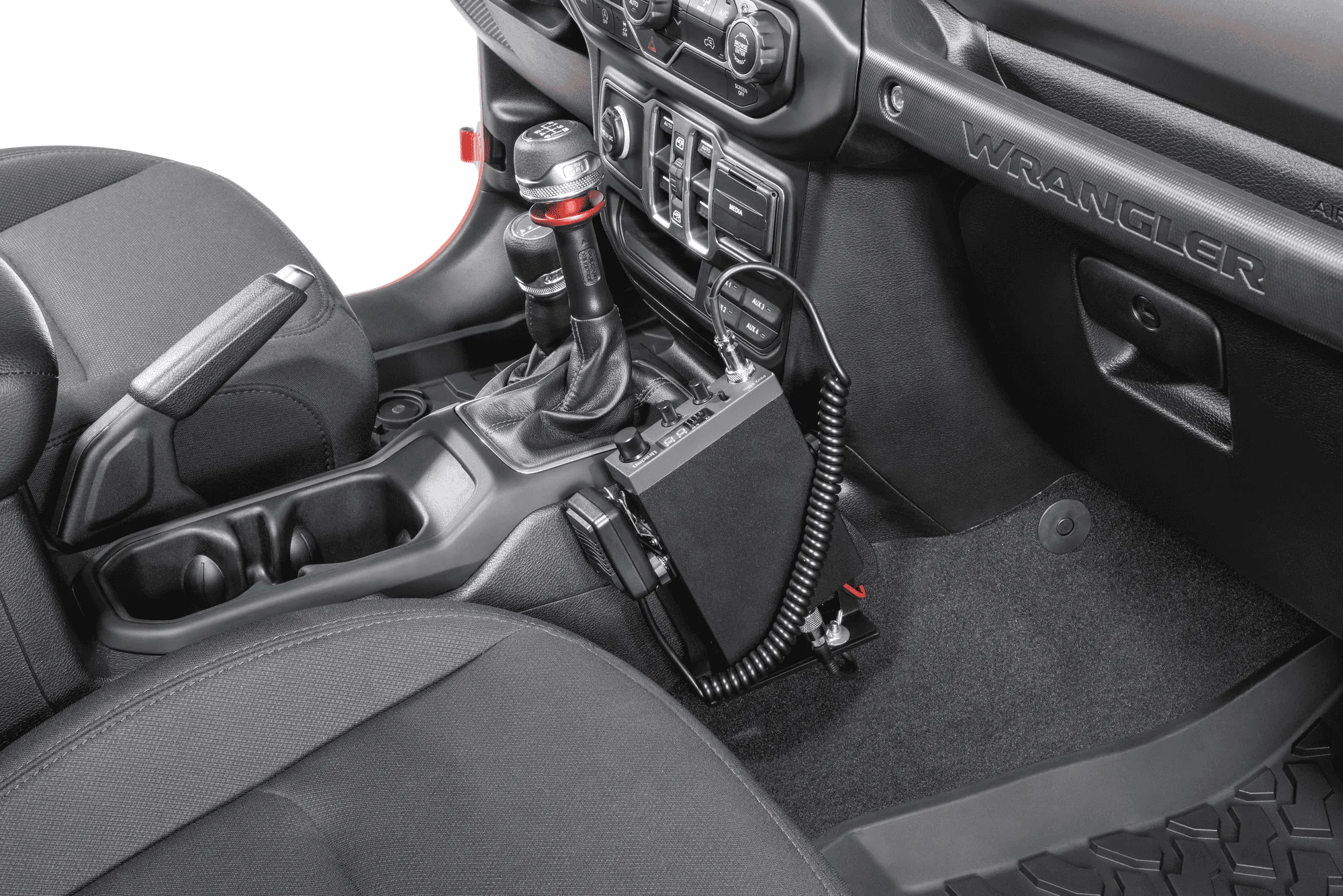

Mounting my radio, I built a mount out of 1" 8020 and mounted similar to pic below. It is only attached via a bracket that I slid behind the console mounting screw on that side, and the 8020 rests securely on the floor. Radio does not bounce around, and is very secure... plus I have enough 8020 exposed to install other possibilities too..
Jeep Gladiator CB and GMRS Install 1659964880828
