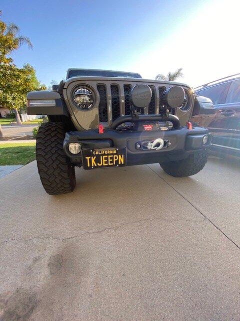

On my Rubi, I added a Mopar Steel Stubbi front bumper, Mopar off road lights, Mopar skid plate and winch mounting plate and a Warn vr EVO 12-S winch and got absolutely NO vehicle rake, difference in handling, fuel economy (not that fuel economy is synonymous with a Jeep) or vehicle performance. None, zip. nada.........
