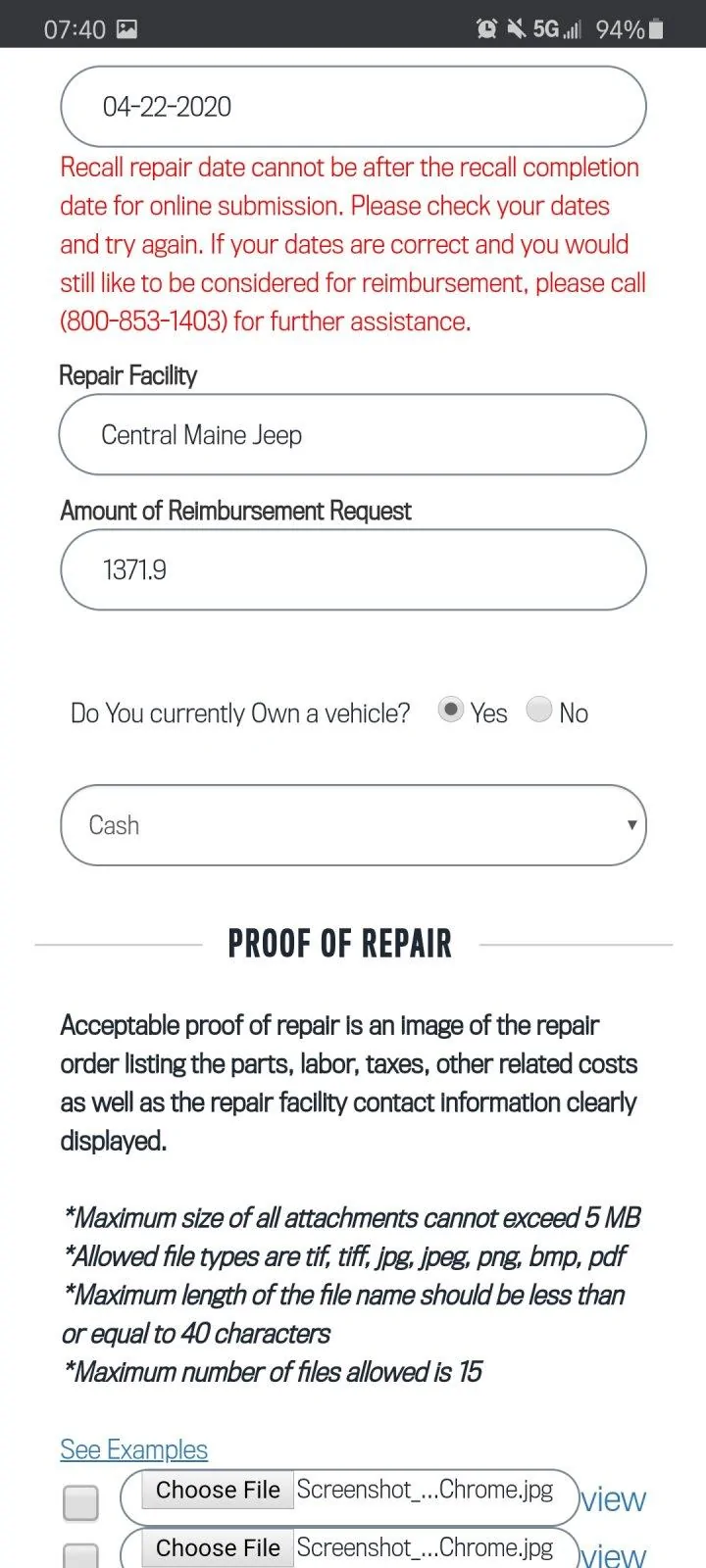

Thought it was worth trying to submit for reimbursement on a KDF157077 - Dual Friction , Clutch and Flywheel Kit but no matter what date I pick I get "Recall repair date cannot be after the recall completion date for online submission. Please check your dates and try again. If your dates are correct and you would still like to be considered for reimbursement, please call (800-853-1403) for further assistance."
Just waiting for my dealer's service dept to open up to phone them.
Only thing I've noticed is reversing in 4hi... Even if I'm off the clutch pedal (I swear I'm not riding or slipping it) I can sell a little burnt clutch.
Edit: Just phoned my service department. they said they don't know the replacement parts yet but I would get a letter in the post once available. They also said with the federal recall like this they are mandated on the repair order to have specific parts listed, and cannot put the centerforce clutch in, nor split the difference of the upgrade cost.

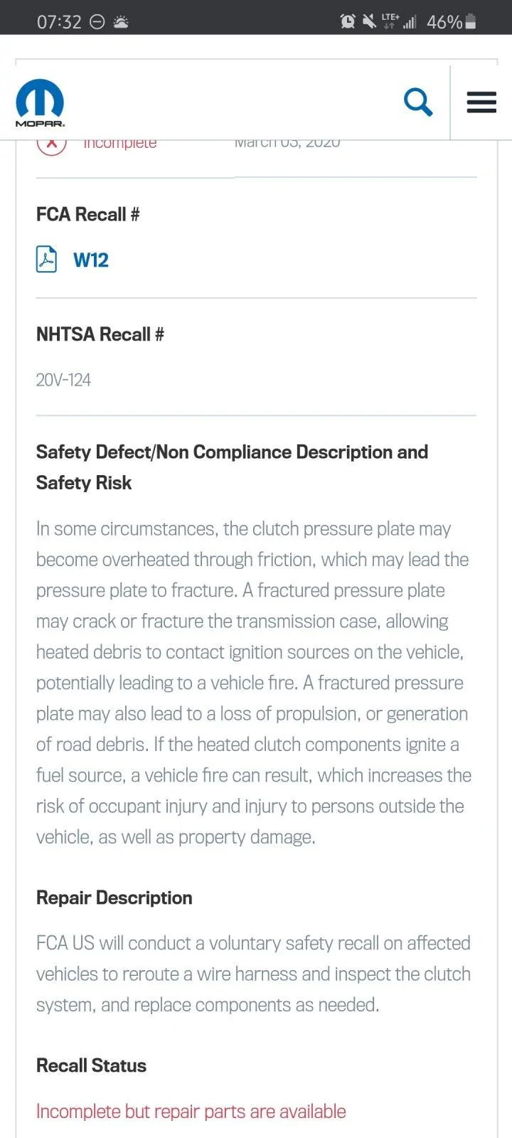

Any body notice this changed to "repair parts are available"?
Nick
Feb 14, 2019
86
136
Leonardtown, MD
04 Explorer Sport Track, 04 Suzuki VL800, 06 Lincoln Zephyr, 16 Jeep Renegade
I'll take this as good news. I'd like to know the details of what improvements they made to the replacement parts.

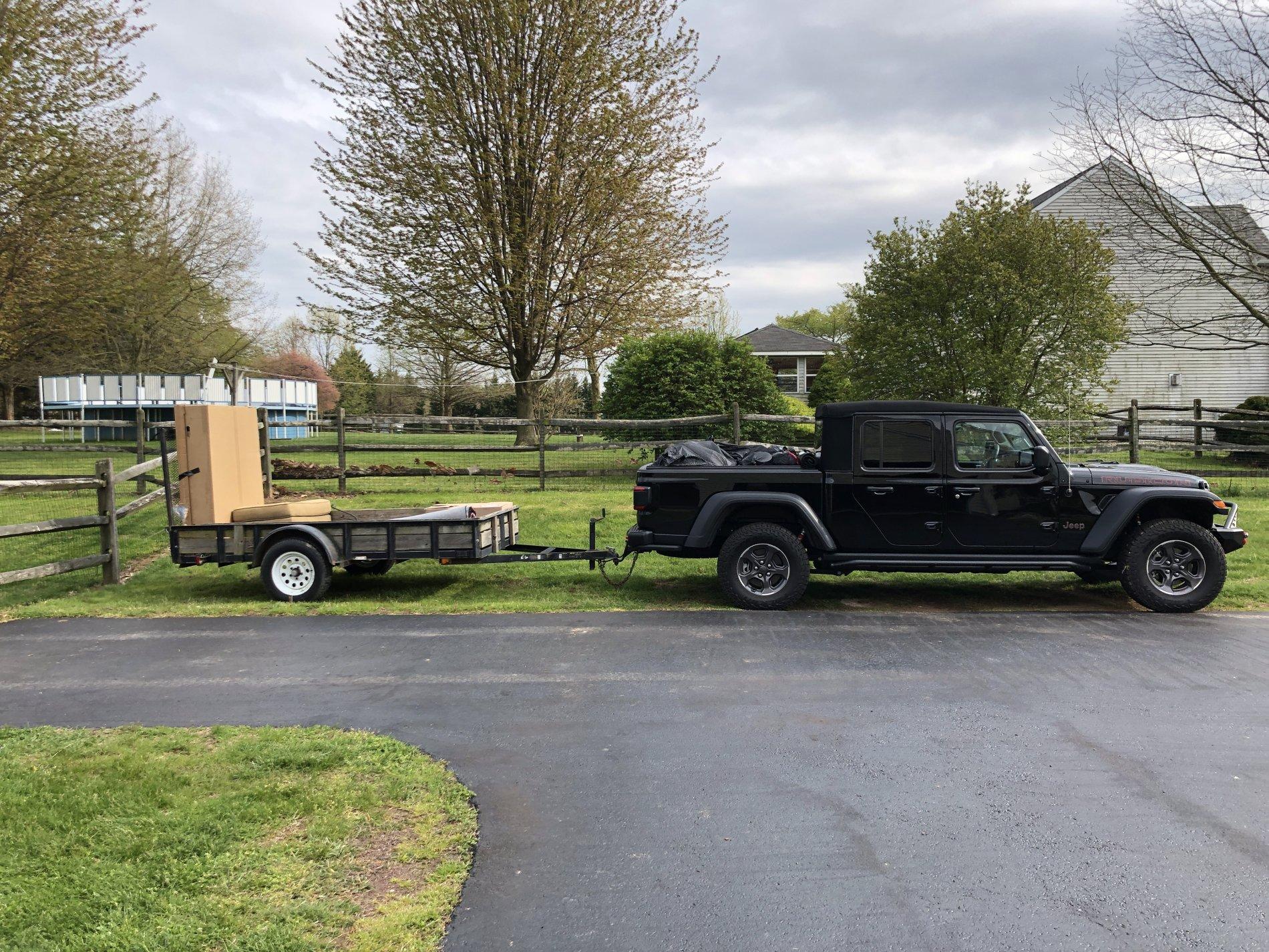

I’m not really worried about it. Only about 2300lbs but zero issues. Planning on skipping the recall and upgrading to Centerforce
