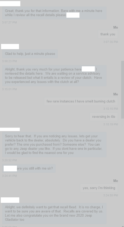

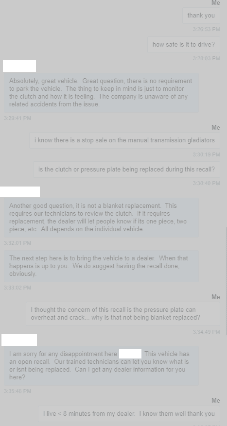

@Nick I messaged into Mopar today. sorry the chat is grey and hard to read. I did not screen shot until the agent closed the chat. names withheld for privacy//respect.

@Bbannongmu
I feel like what I got out of the chat session today... makes me just want to wait until my clutch needs replacing and save this recall as a free clutch replacement down the road. Seems like If I do it now its only going to be an inspection and wiring harness move.
