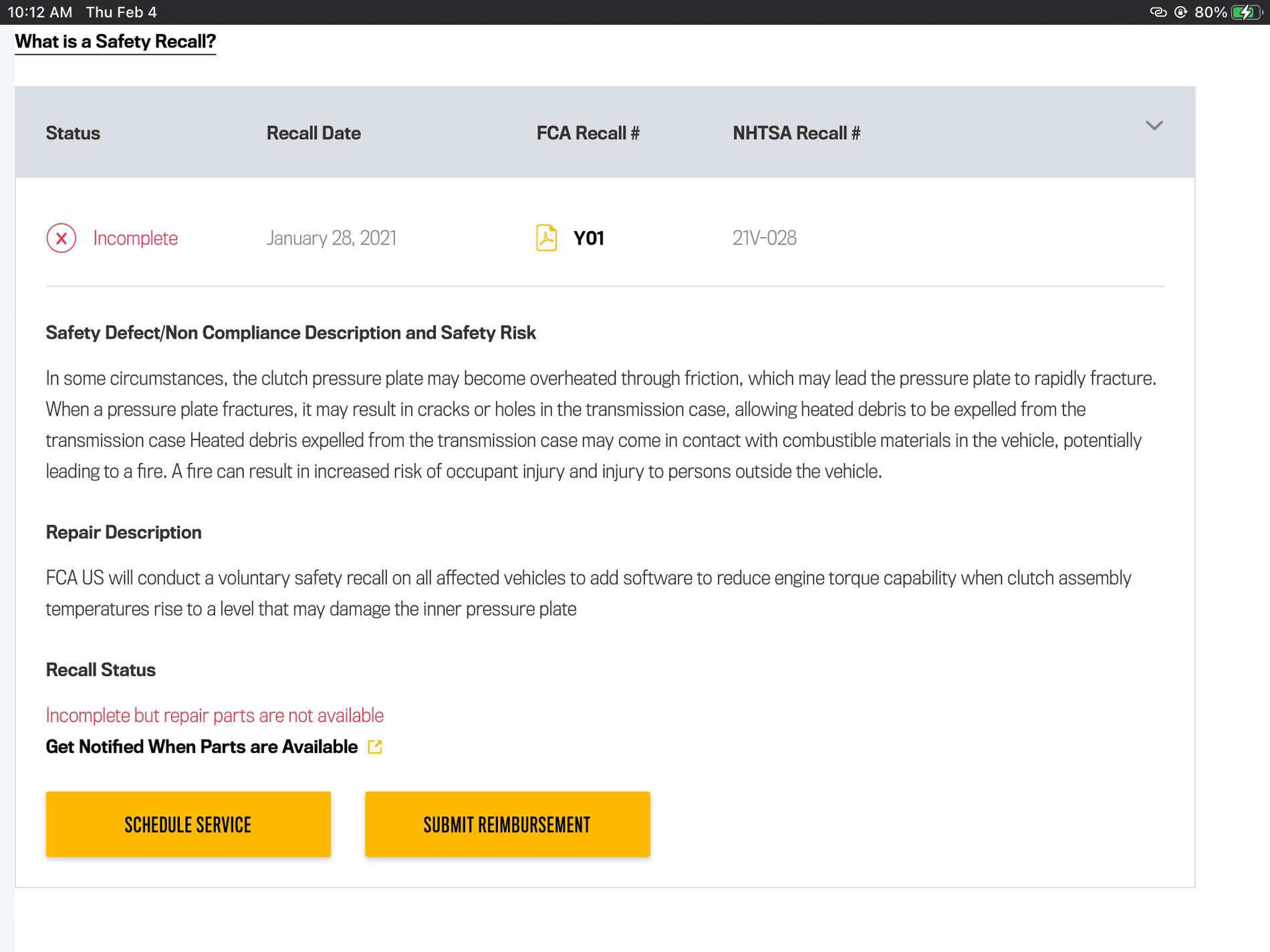

Edit....I just entered my VIN and mine is affected....Ordered on 10/1/2020 took delivery just before Christmas...
“FCA will...add software to reduce engine torque capability when clutch assembly temperatures rise to a level that may damage the inner pressure plate.”
Thats some fucking BULLSHIT! Put in a pressure plate that can handle the heat!! WTF?! I’m pissed...

Entering my VIN, I see a recall and a software remedy to reduce torque (what torque? )
Exactly what torque you're afraid of losing. FCA fucked up massively on this one because the Aisin AL6 transmission is only capable of holding 370Nm of torque. That's 273 lb-ft in freedom units capacity behind an engine that can put out 260 lb-ft of torque.
It's probably a decision around size (the AL6 is freaking tiny) and the super short first gear but that doesn't change the fact there's very little margin there.
