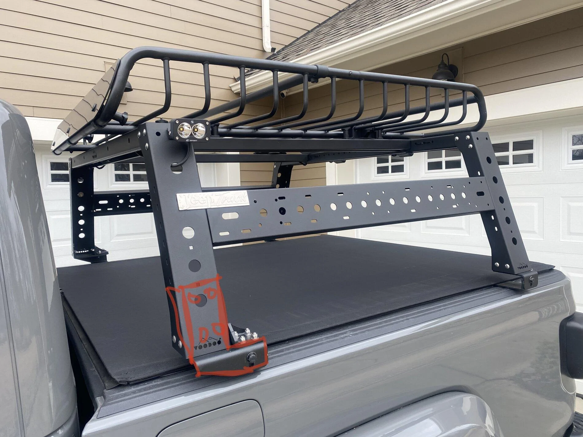

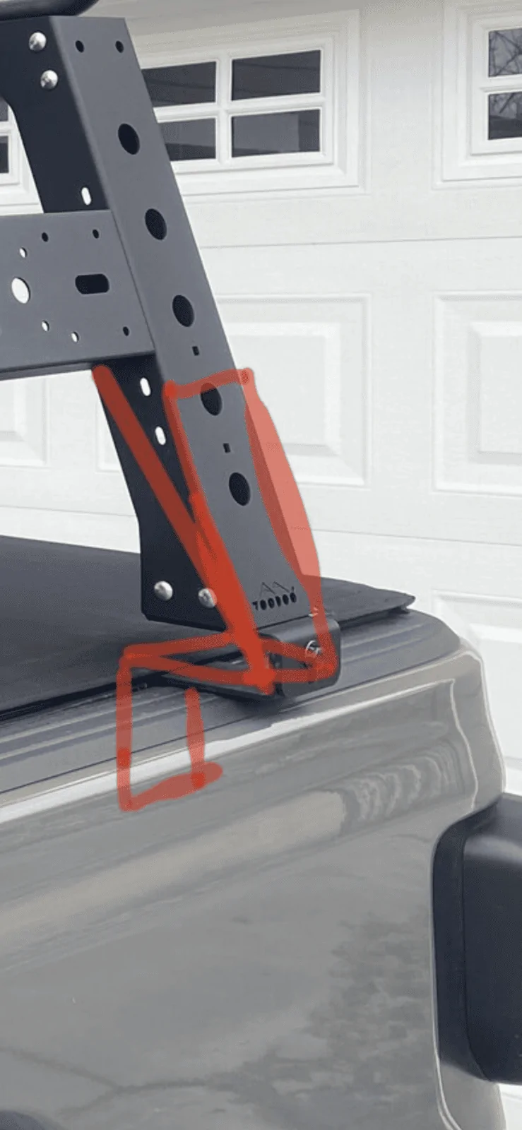

@Max Modular Why do the tonneau brackets have to be C shaped? Why couldn’t they be L shaped, still mount under the tonneau and then angle up either have the uprights slide onto them or wrap around the outside of the uprights? This would give you a clear path for rolling the tonneau.

Not looking to answer for @Max Modular , but there is little gained relative to roll up with an L-Bracket. You still have to clear the thickness of the bottom of the rack. It would take a redesign of the rack legs which would most-likely raise the price. For my tonneau, if the legs were 1/4 inch thinner. I would be able to roll the tonneau the entire way back.
