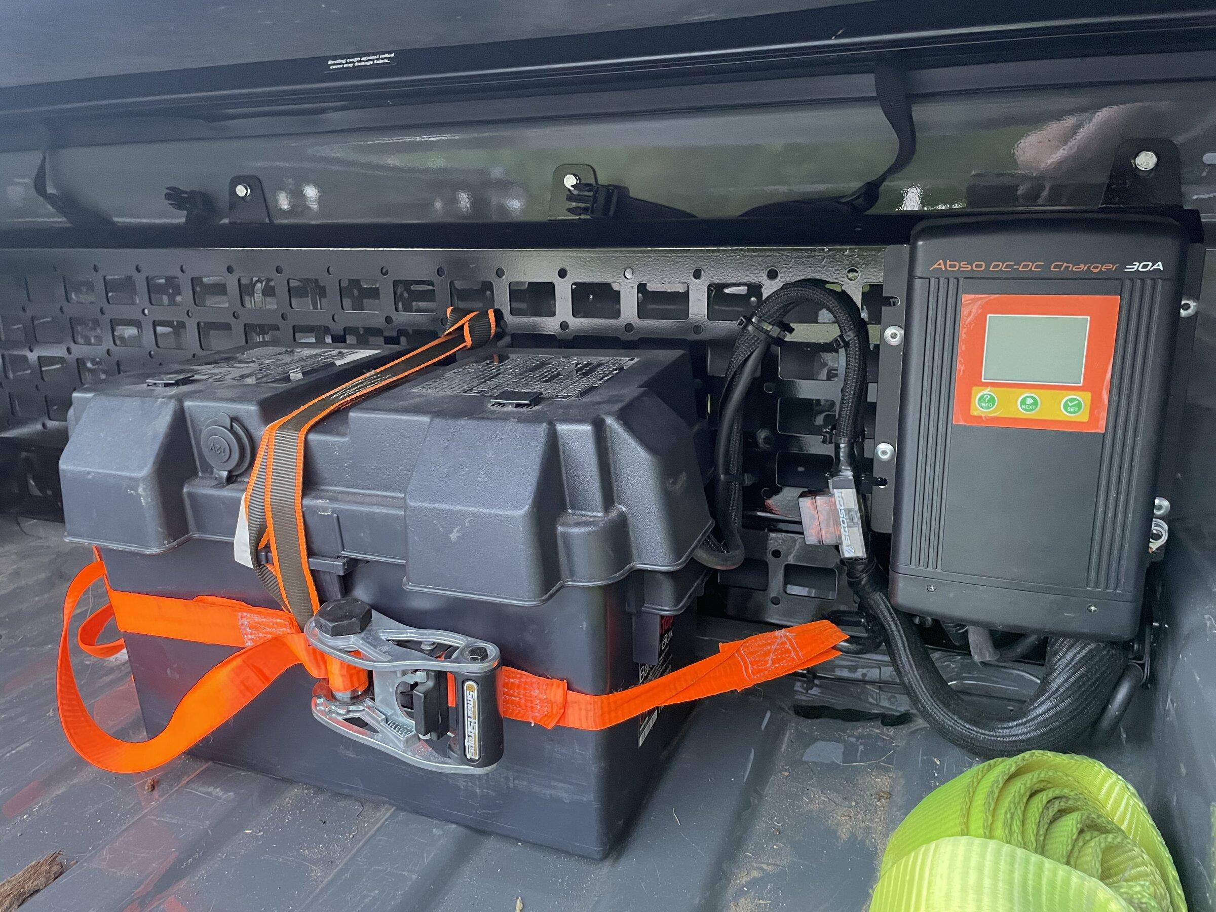

I run my fridge with a second (third) battery isolated with a kasei 1230 DC-DC plus solar charger $200 mounted on a motobuilt molle panel. You can run the fridge off the main car battery but its not ideal at all and if you don't drive the truck for a couple days it could draw it down enough to not be able to start or your fridge may cut off or both.''
I just bought the largest deep cycle from O'reilys and stuck it into a battery box. I am going to switch over to a lipofe at some point just to save space and weight.

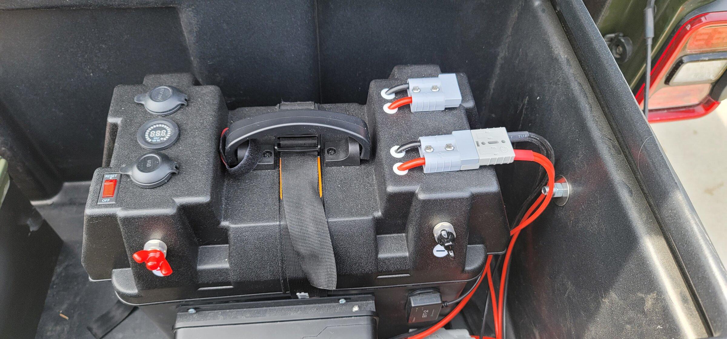

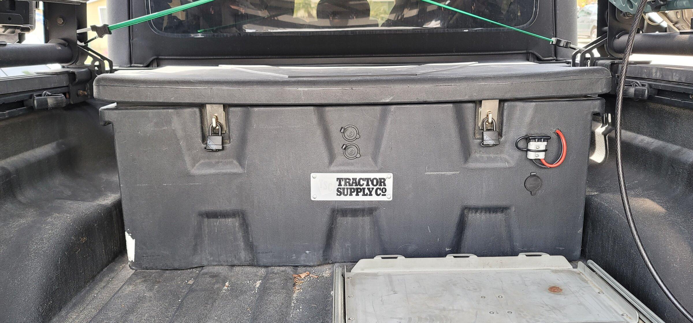

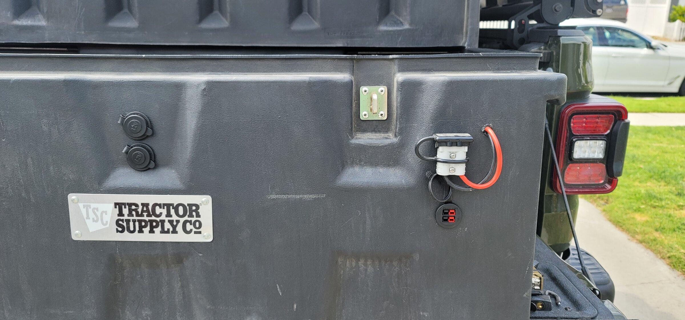

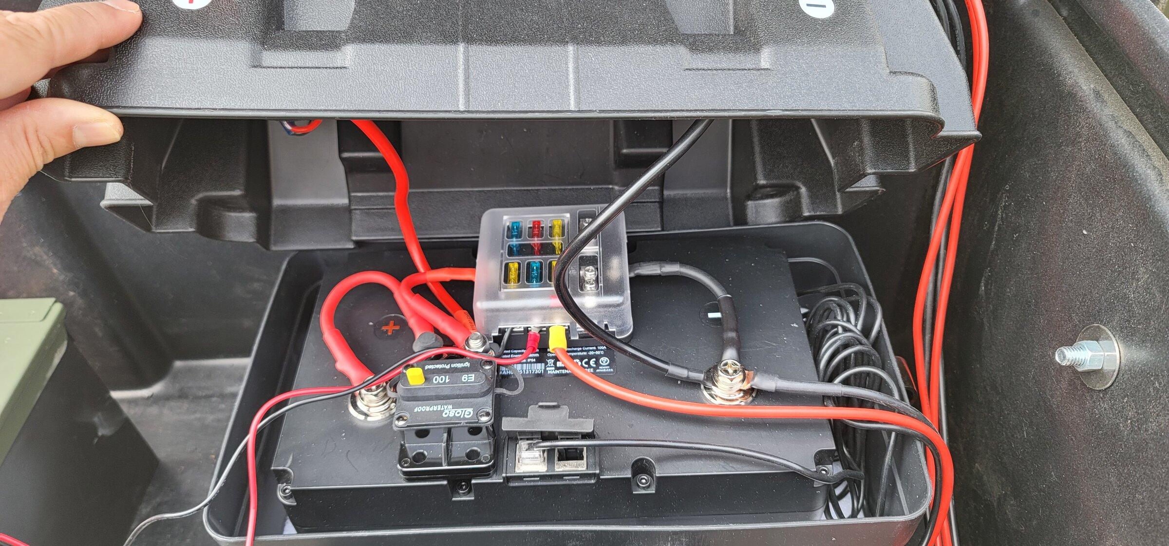

I did something similar with a 100ah lifepo and 20a mppt solar charger with a portable battery box mounted inside a tractor supply utility box. Also mounted to the exterior of the tractor trailer box 2 12v cig, an andersone connector for the solar panel and 2 powerpoles for fridge and diesel heater. Used it this past weekend for a 4 day trip and only had to charge it up once with the solar panel.

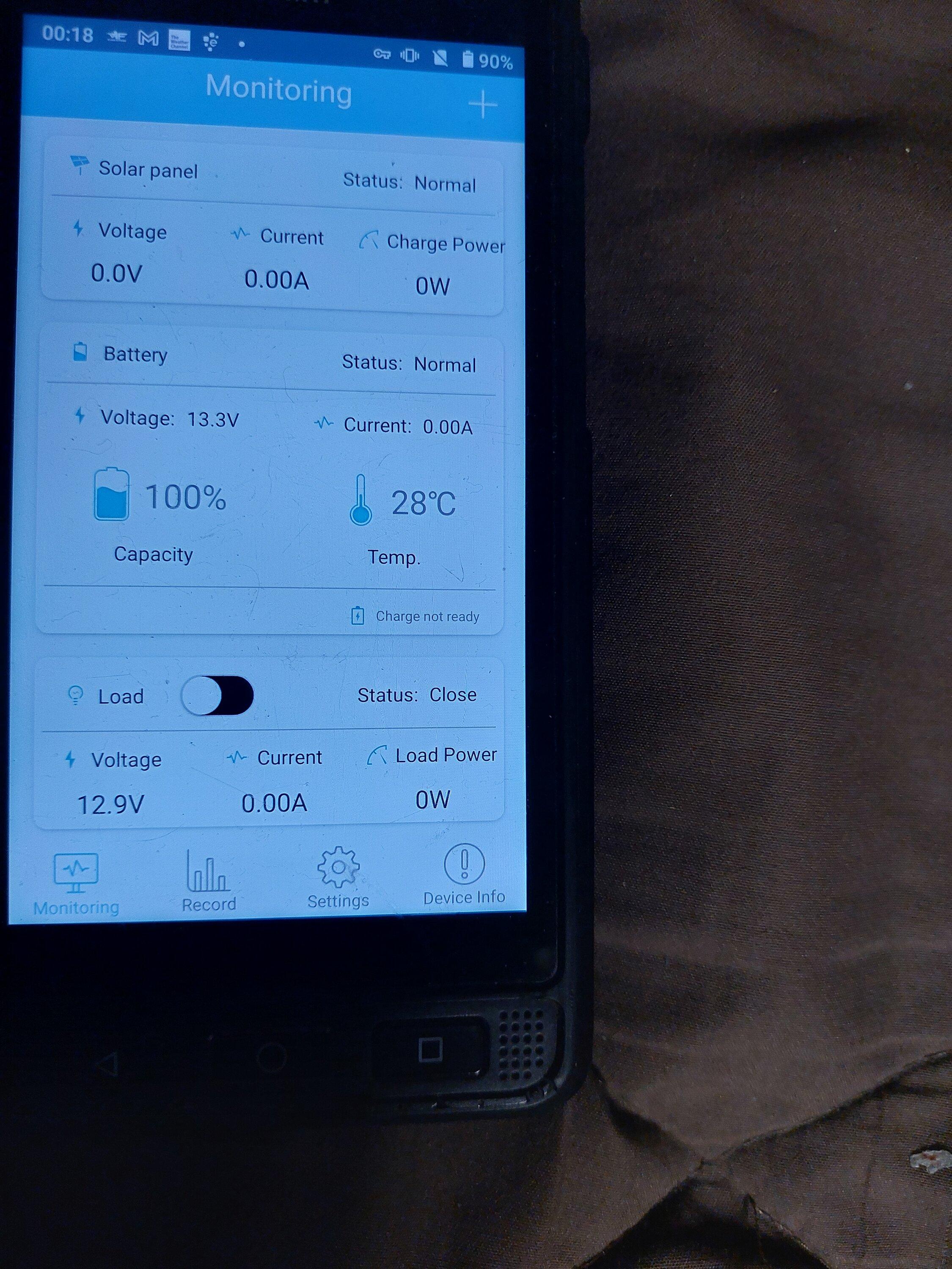

I did the Cascadia solar system for about a year then I added a second solar system with "house" battery. The fridge freezer in mine still going over 2 years non-stop set at 34° F / 5°C. Only times it's shut down is to clean it out. I didn't start my JT up or drive it much in last two weeks. Been driving my LJ mainly what little I've been driving. Starting batteries 12.9v house 13.3v at 12:15 am.

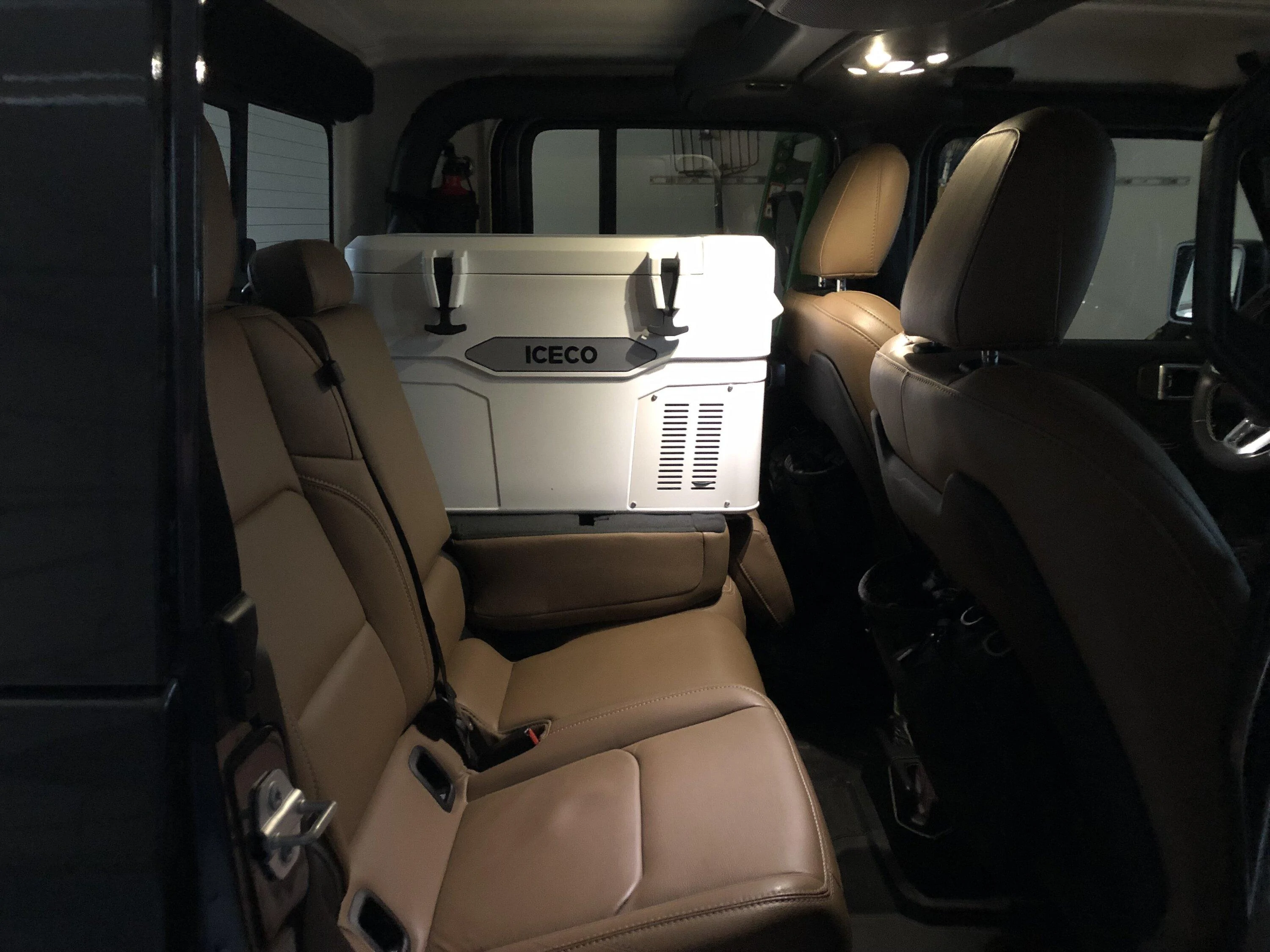

This is a great question, Heavy Duty Cooler vs. Fridge. I think price made my decision easier. The Yeti I wanted was about $400 and the fridge I wanted was about $450 (on sale). I waited for a 15% sale and picked up the ICECO JP42. It's like a Yeti with a compressor.
I installed a $25 kit to make your cigarette lighter run continuous, and the ICECO has battery protection in it, so it won't run down your starter battery.
I'll let you know how it works this summer, but so far a cool gatoraid or beer after a summer mountain biking run is pretty incredible. Most of the time the fridge is flipped so I can open from the outside door.

Good info. What app is that?
