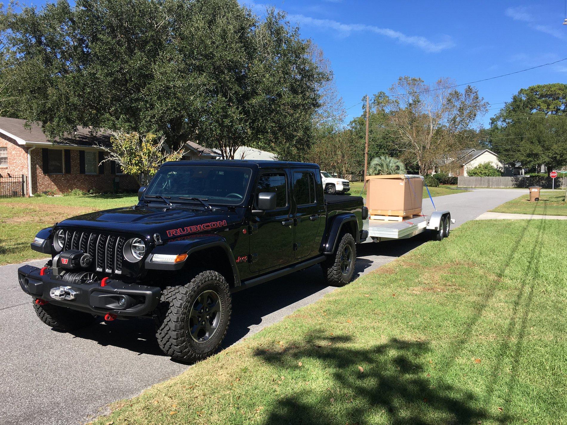

I installed my diode into red wire on my C51459 harness and it seems to be good to go. Towed my trailer yesterday and the brakes work great.
Jeep Gladiator Curt Brake Harness C51459 IMG_6455
