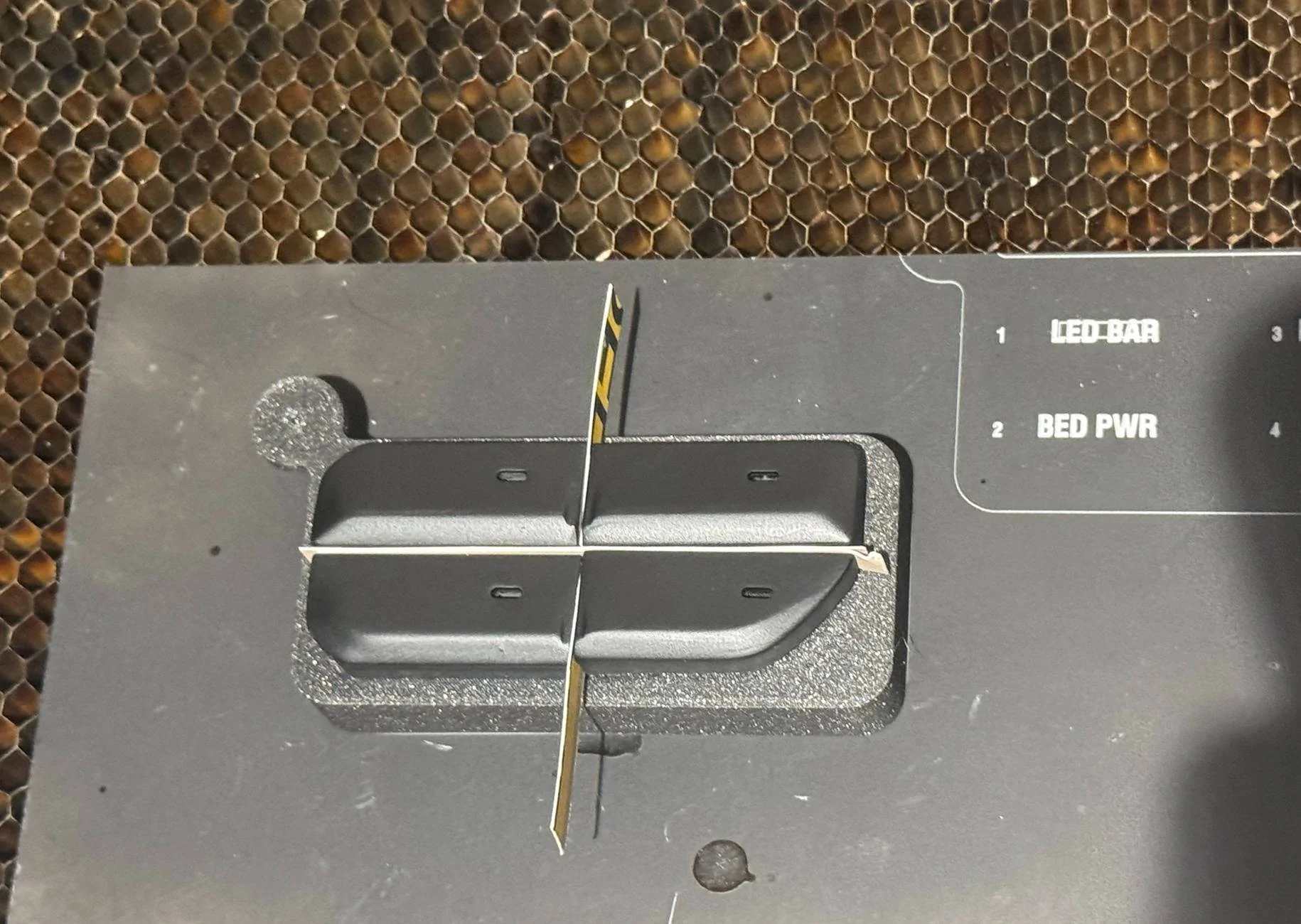

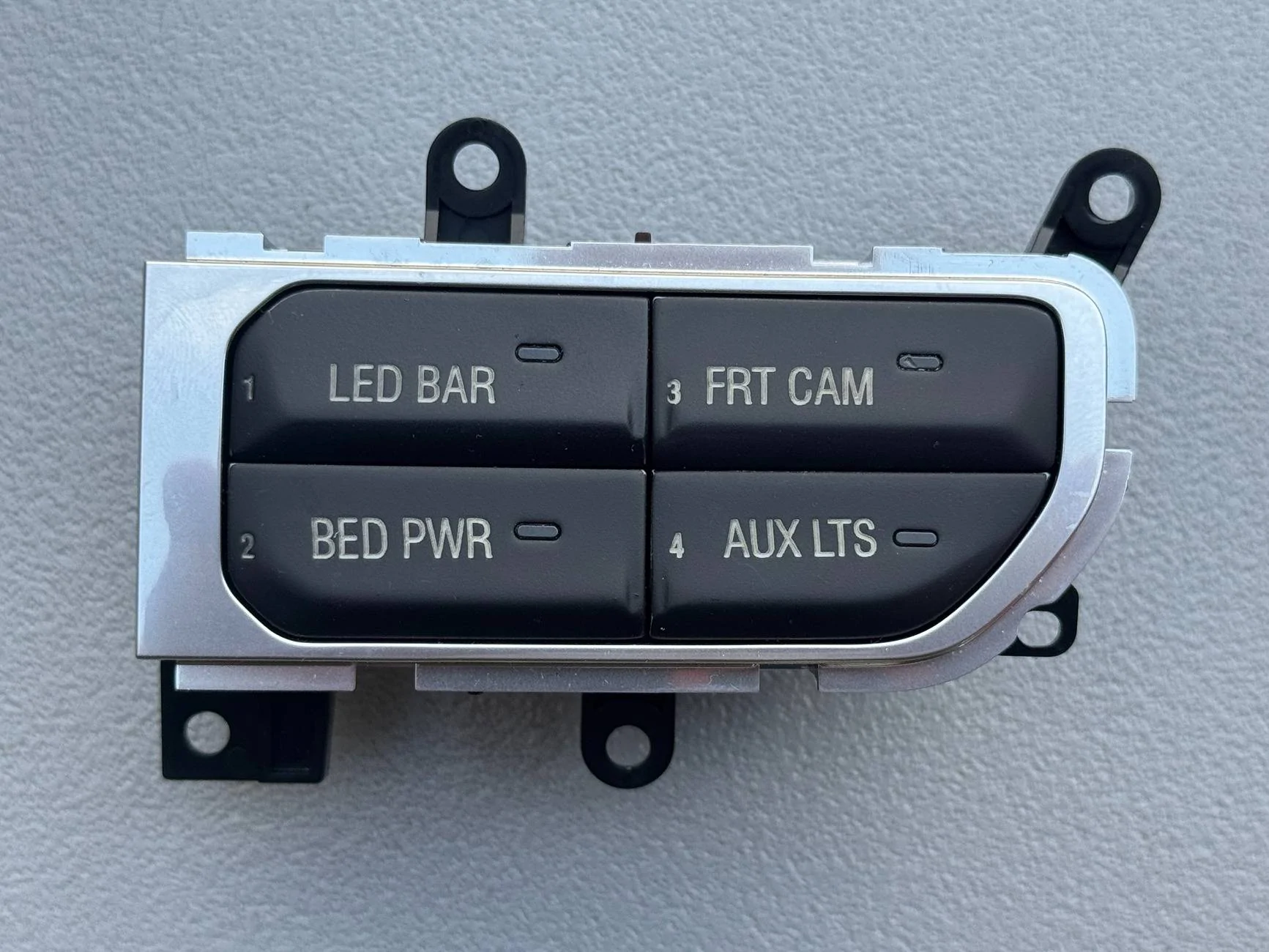

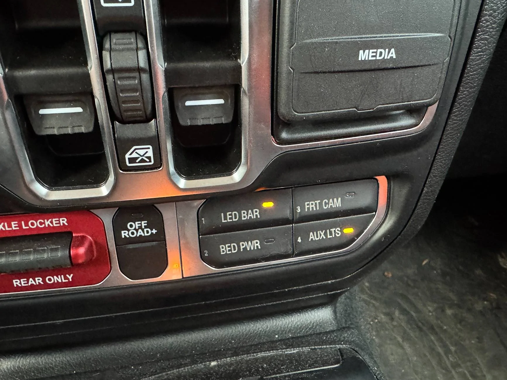

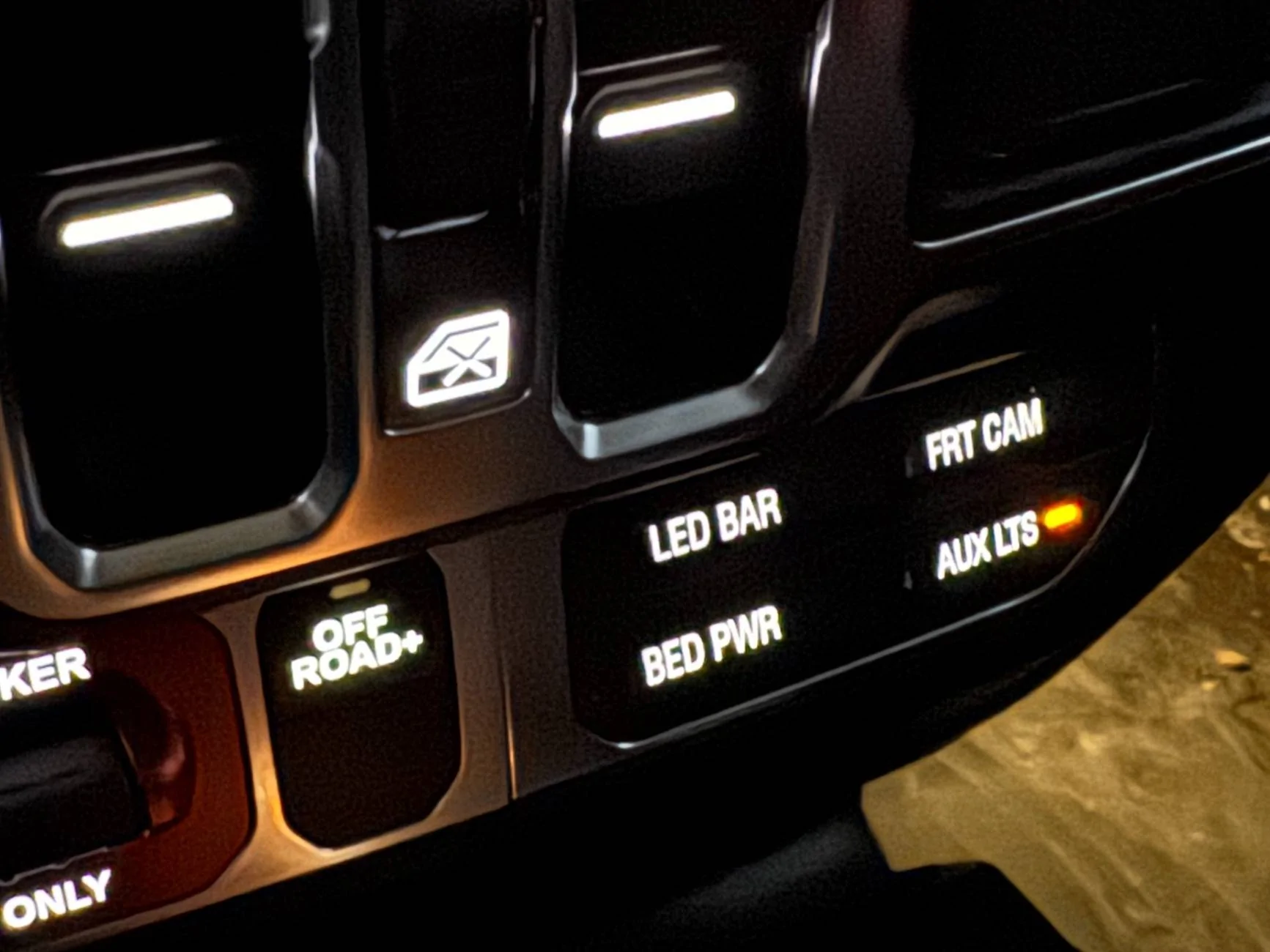

It has always bugged me that the only way to rename the factory Aux switches in my JTM was to put a sticker on them (I used black DYMO tape w/white letters). Once the labels were stuck on the text on the buttons was no longer visible at night… and frankly they looked like crap. I searched all over for somebody who offered custom laser-engraved Aux switches for the JT & JL’s, but couldn’t find anything, so I decided to tackle the project myself.
I removed the buttons from the switch housing, carefully sanded & re-painted them, laser engraved the new text, and reassembled. It was a lot of effort, but I think they came out pretty good.
