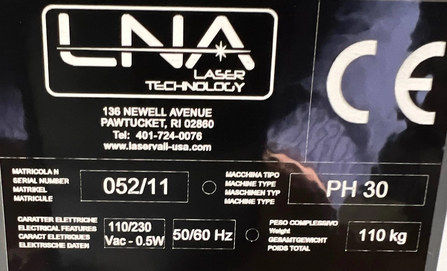

I’d also like to know how difficult/expensove/space-required it is to get into laser etching. If anyone would like to share, I’d be interested.
We had one at work. It was a LaserVal. Around 15 years ago they sold for $50K. I’m sure they are much cheaper these days. The foot print was about 30” x 36” and around 30” tall for the cabinet. And there was a computer tower along with it. There was a filter system (important if you don’t want to breath fumes) that was a stack of five filters and about 2’ x 2’ and about 36” tall.
