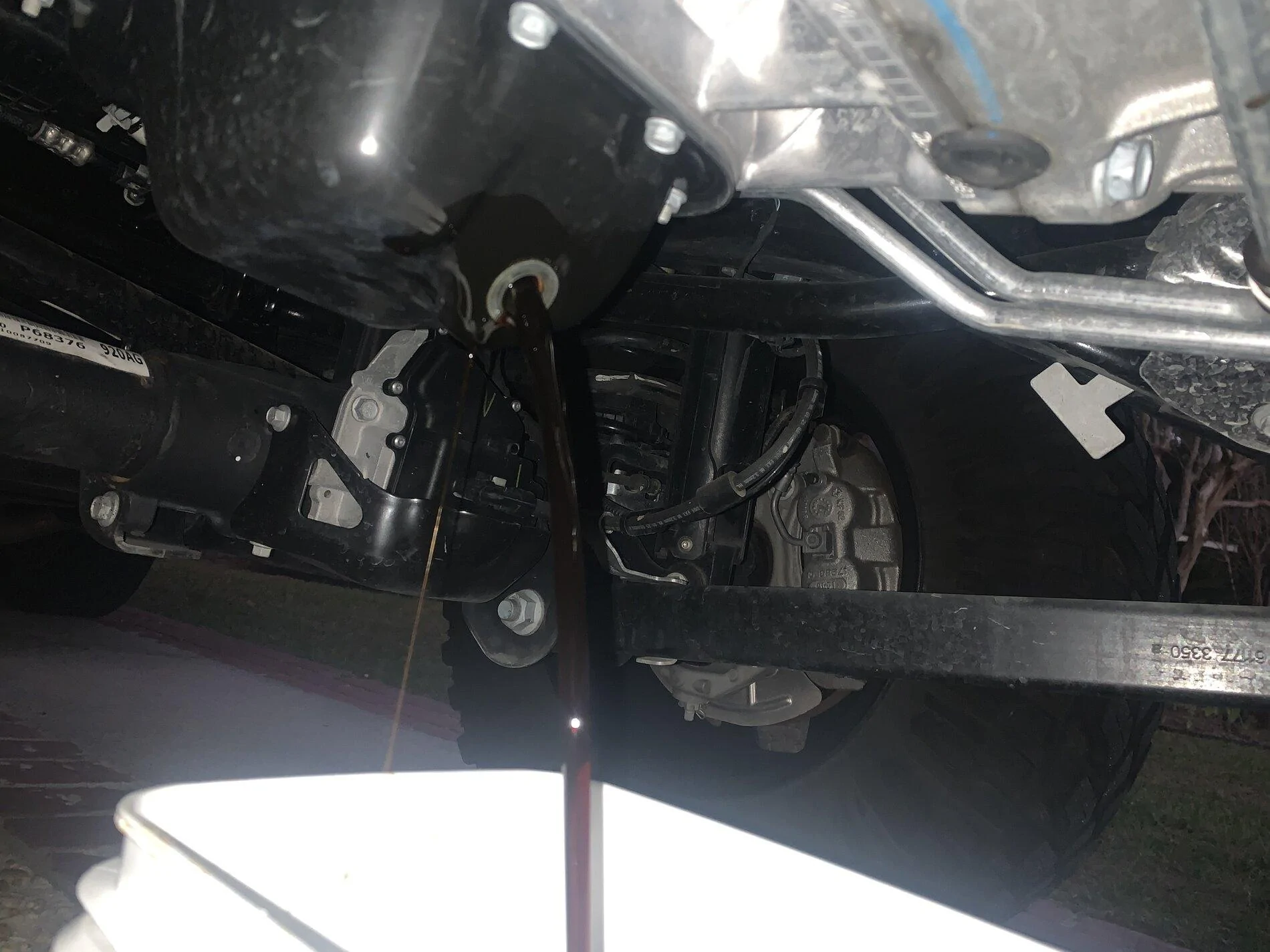

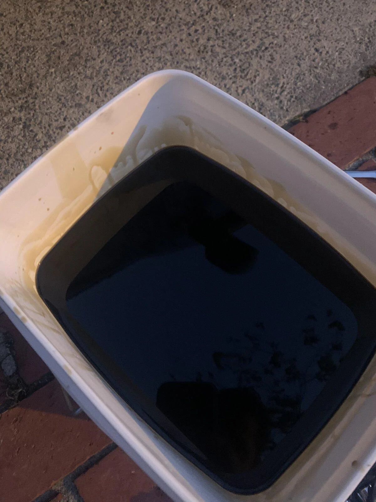

I get home, pull out a clean bucket and drain the oil. My only intention was drain, and use 5 of the 6 quarts they used to fill it back to the right level. When the oil runs Out I get some good old Texas tea and not some nice Colorado gold. Take a look at the pictures and please tell me if you think the oil was actually changed. Iā€™ve changed oil plenty of times in my life and Iā€™ve got my opinion. The oil in the pictures is what I got out tonight after a 65 mile run straight home from work down the interstate. There wasnā€™t a drop of oil or cleaned oil around the plug and the only thing that may have been done was a filter change by the look of the filter. After some further investigation as the sun was going down thereā€™s dirty oil all over the top of the radiator, and around the fill hole. See the second picture of the dirty oil on the Mopar label.
Iā€™ve gone ahead and done my own oil change tonight and plan on siphoning a small bit out of the dipstick after about 65 miles for a comparison. Please let me know what action I should take with the dealer if you all agree with me that old oil was reused or even drained at all. Please no dealer flaming, yes there are good and bad ones and many good people working in bad dealers and vice versa. I took photos as the oil was draining and saved the oil off for analysis of that can help determine oil age and if that would even help for anything.

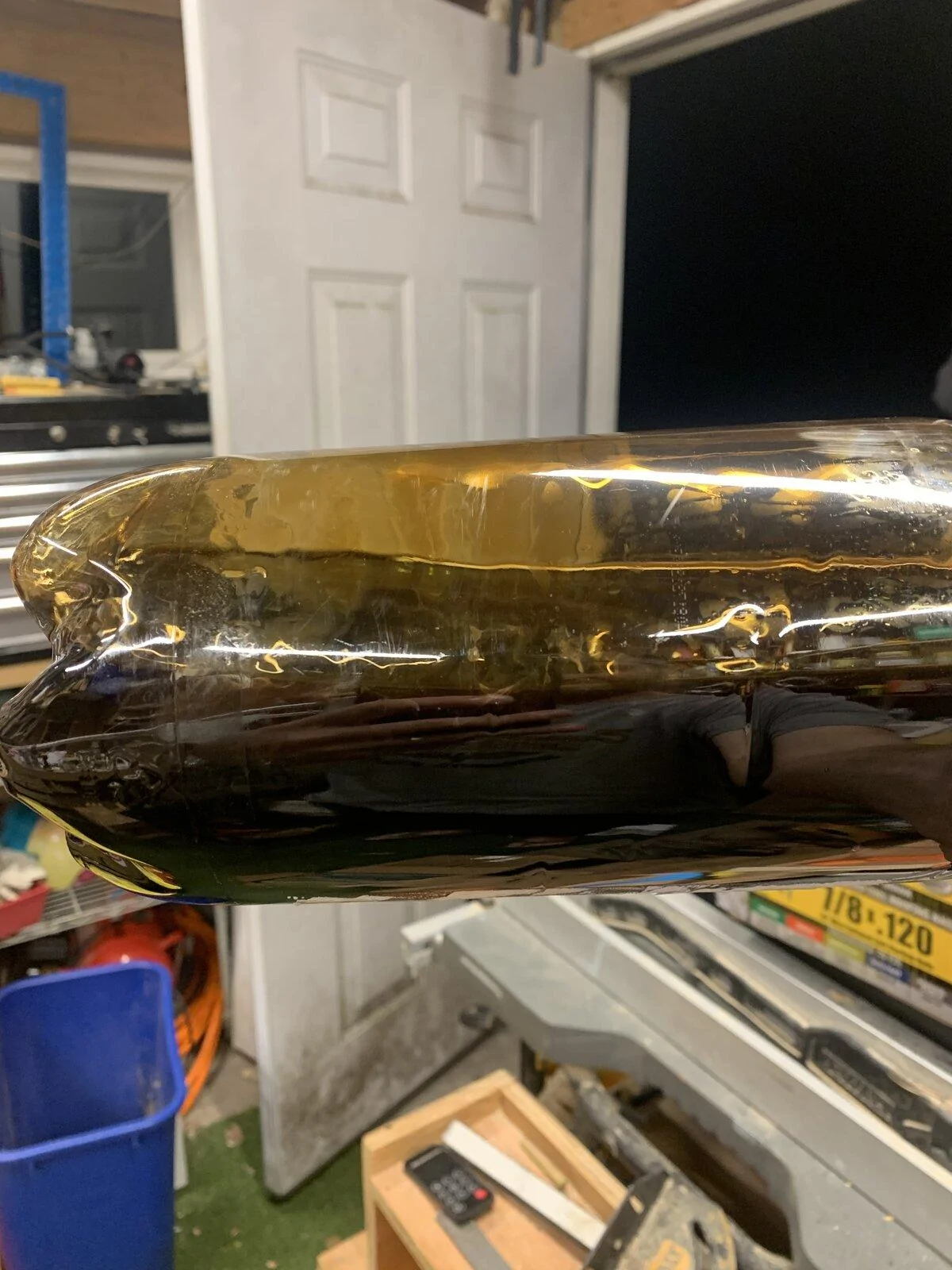

Oil just after draining
Dirty oil over mopar label
dirty oil draining
Oil in a 2l bottle for better viewing.

Dark isnā€™t a bad thing or an indication oil is dirty. Itā€™s how detergents work in oil. Iā€™ve seen lots of oil analysisā€™s after the suggested change intervals come back from the lab to say oil is still good and change isnā€™t required.
So doing a shade comparison isnā€™t accurate. A lab analysis is.

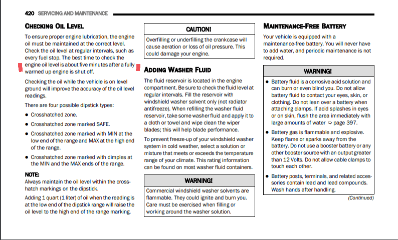

Are you starting the vehicle for a little bit before you check the oil? Oil settles in the pan after a bit so you have to start it and warm it up before checking the level.
Horse poop. An accurate level check comes after the engine has been off long enough for the oil to drain completely into the pan. Drain it cold-that is when the contaminates are sitting quietly in the sump
In my experience, no. Honda contracted with Valvoline to provide 55G drums of their oil to dealerships. The same viscosity and formula you can buy at ________.
Right out of the owners manual. The difference in oil level after a few minutes and lets say overnight is huge. Often I have customers who check their oil after its been done for 3-4 hours or in the morning after getting their oil change to make sure we did our jobs "right" and they come back screaming how we are going to blow their engine up. I then go check their oil and the level is fine. I'm just sharing my experiences and making sure people are checking their oil level properly.

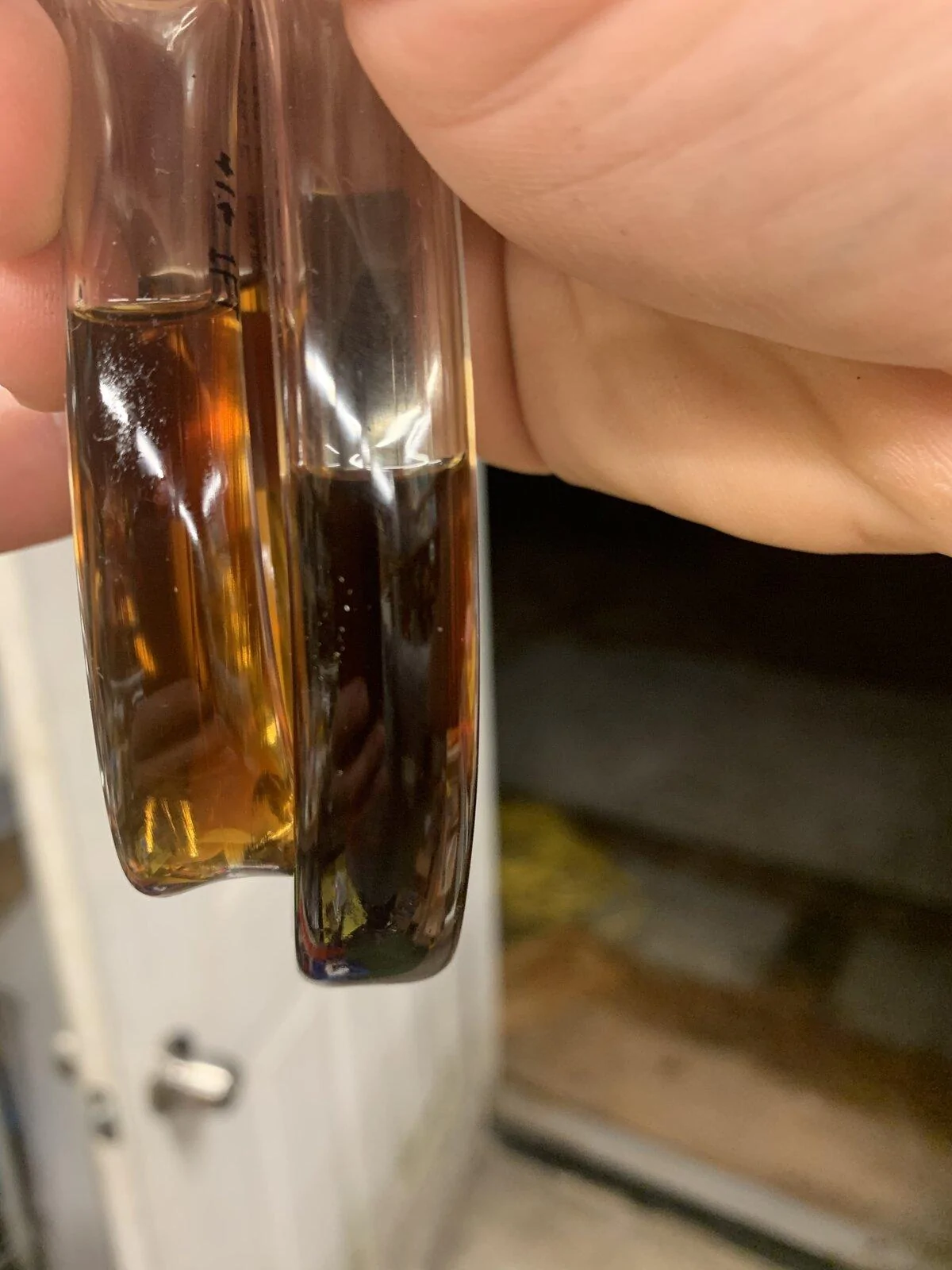

That said, below is the oil I pulled out after after changing it. The oil on the right is what I pulled out when it was overfilled and after 65 miles of driving. Changed-drove 65 miles home from work and pulled the oil.
The oil on the left is what I siphoned out of the engine after I changed it myself. This I drove about 130 miles before sampling.

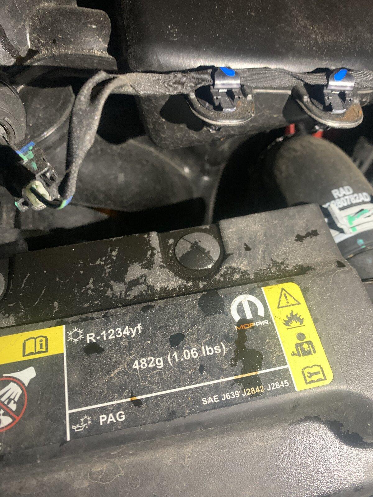

My best guess is that the dumbass changing the oil somehow made a big mess over the engine with the oil filter somehow. Iā€™m not sure how since Iā€™ve never made a mess when changing our Dodge van with the same 3.6 and filter setup. He also probably left a good bit of the old oil in the pan and didnā€™t drain it all the way out. The oil I pulled out is already going to come out cleaner as I let it drain for a few hours in the evening and it it and the filter probably absorbed a good bit of the leftover contaminates.
Iā€™m glad someone finally found the ā€œcorrectā€ way to check the oil level. Thatā€™s the way I checked. It was definitely overfilled by at least a quart, maybe a bit more from what they left in the pan. Stupid dealer.
