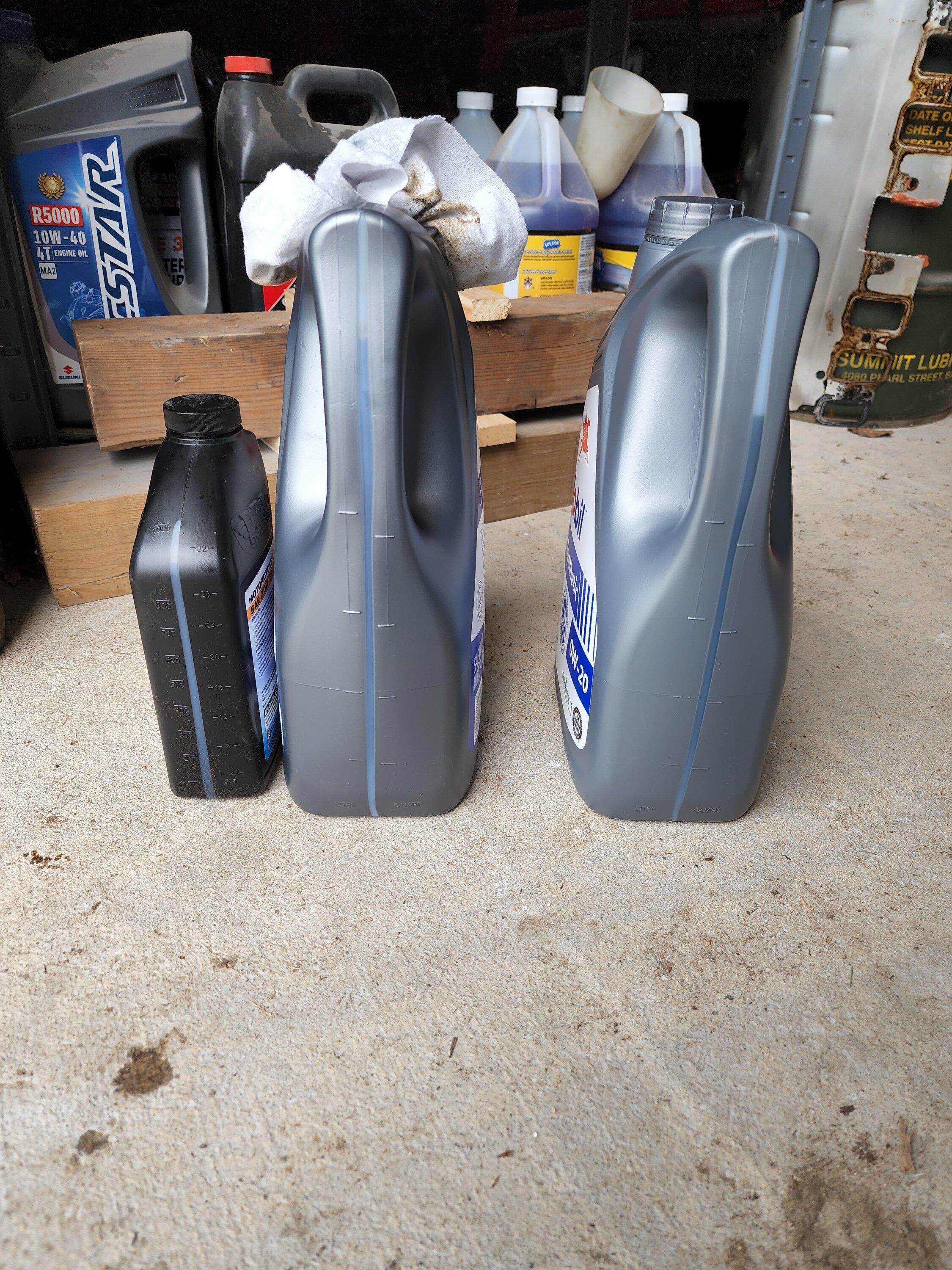

Did the first oil change on both my JT and the wife’s JL 3.6, and 5 qt filled it exactly to the correct spot on the dipstick, corroborating what the manual says, not that I was surprised.
Just surprised at some of the dealerships and their mindsets/practices ?
Sticking to my own maintenance like usual.

I had the pleasant surprise of finding out after my first oil change at home that my dealer has been overfilling my engine by about a quarter and a half. That is of course unless my Jeep makes oil. I am so excited to call them on Monday and find out exactly why this is. I figured it out very scientifically. If I drain the oil out, install fresh, and then dump the old into the container the new came in it should be perfect. There shouldn't be enough to fill a quart bottle beside it and have more in it then a new jug. Old oil is on left, unopened 5qt on the right.
Just another reason to continue doing my own maintenance I guess.:angry::headbang::swear:
The same thing happened to me on my 1st free oil change also. I checked the vehicle over good when I got back home. I drained 1 full quart of oil back out and saved it in a old oil bottle I had. The dip stick did show it was way over full. It's hard to read when overfull because it is a braided cable above the full dot. You do not want to leave it overfull. I'm sad to say I almost expect this

It shouldn't be over-filled, but it doesn't do damage from my observations (and imagine the ordinary owners who have their JT serviced, and simply drive it until the next oil change, or don't notice it's a quart high until days or weeks or month later, if at all. These apparently have decent windage control.
If it's 1 quart over it would be roughly the same distance over the full mark that full is over the low mark.
The first time they did mine was 1 quart over as well. But then, hey, they hadn't see or worked on hardly any Gladiators at that time so it sort of made sense. It was 2, maybe 4 days later I got time and opportunity to go back to that area. I talked to the service manager, showed him the FCA info on these engines, and he instantly had it taken back and a full service done on it again. I mean all new oil, new filter, checking and making sure the fluids were topped off, the whole works.
It hasn't happened since. Yeah, I check, but that was the first, any only time, it happened to me there.
