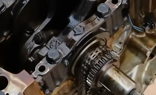

Gee, if only I could tweak dynamic compression and change combustion chamber pressures by managing valve lift and valve timing............ I wonder if 70 degrees of intake valve timing variation is enough. Hmmmm.
I wonder - would 4 bolt mains help? If so, would 6 bolt mains be even better, with a block girdle. I wonder why FCA didn't think of that - oh, wait, they did!
Jeep Gladiator Decided to supercharge over a swappina to a Hemi 1765479503150-6d
ChrisNLA
Jun 7, 2022
2,145
3,873
Louisiana
2022 JT Sport Max Tow
Don't bring sensible things like variable valve timing and variable valve lift into this, Bill.
Or a shit load of main cap bolts, either.
