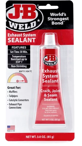

You could try some of this I suppose if you wanted to avoid the dealership.
Jeep Gladiator Delete Screen Shot 2023-06-28 at 11.52.52 AM
