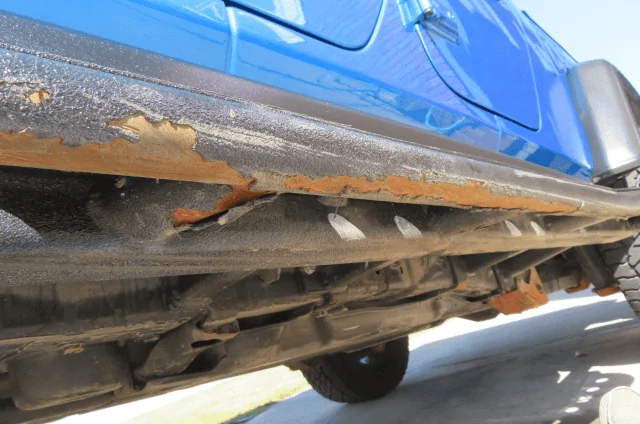

On my rock rails. I have them LineX. and use a rattle can bed liner spray for touch up. Thinking of doing the rattle can bed liner spray for the skids when I get them.

Wonder how durable that line x would hold up on it. How does it hold up on your rock rails?

I peeled it pretty good at Rausch Creek. I used the rattle can spray bed liner for touch up. I knew that I was going to peel it at some time. It happened on my first offroading trip. Next time out. It will be sitting on Clayton 2.5" diesel springs.
Jeep Gladiator Diff cover or diff skid? 1676773325540

Yeah you tore those up good lol. Next time you hit up rausch let me know! I’d be happy to tag along if you need another vehicle. I’m bout two hours away in MD. I signed up for the krawlin for cops event in June, but I would love to go sooner.
