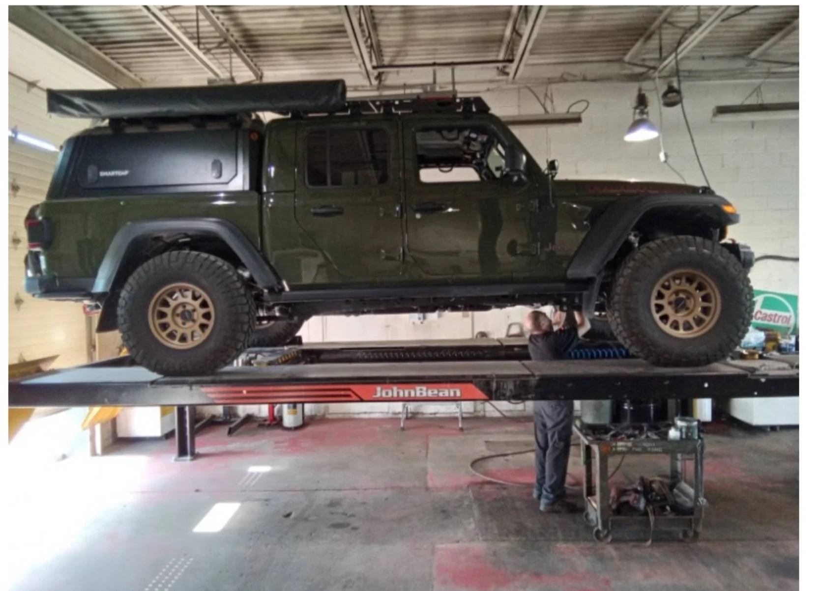

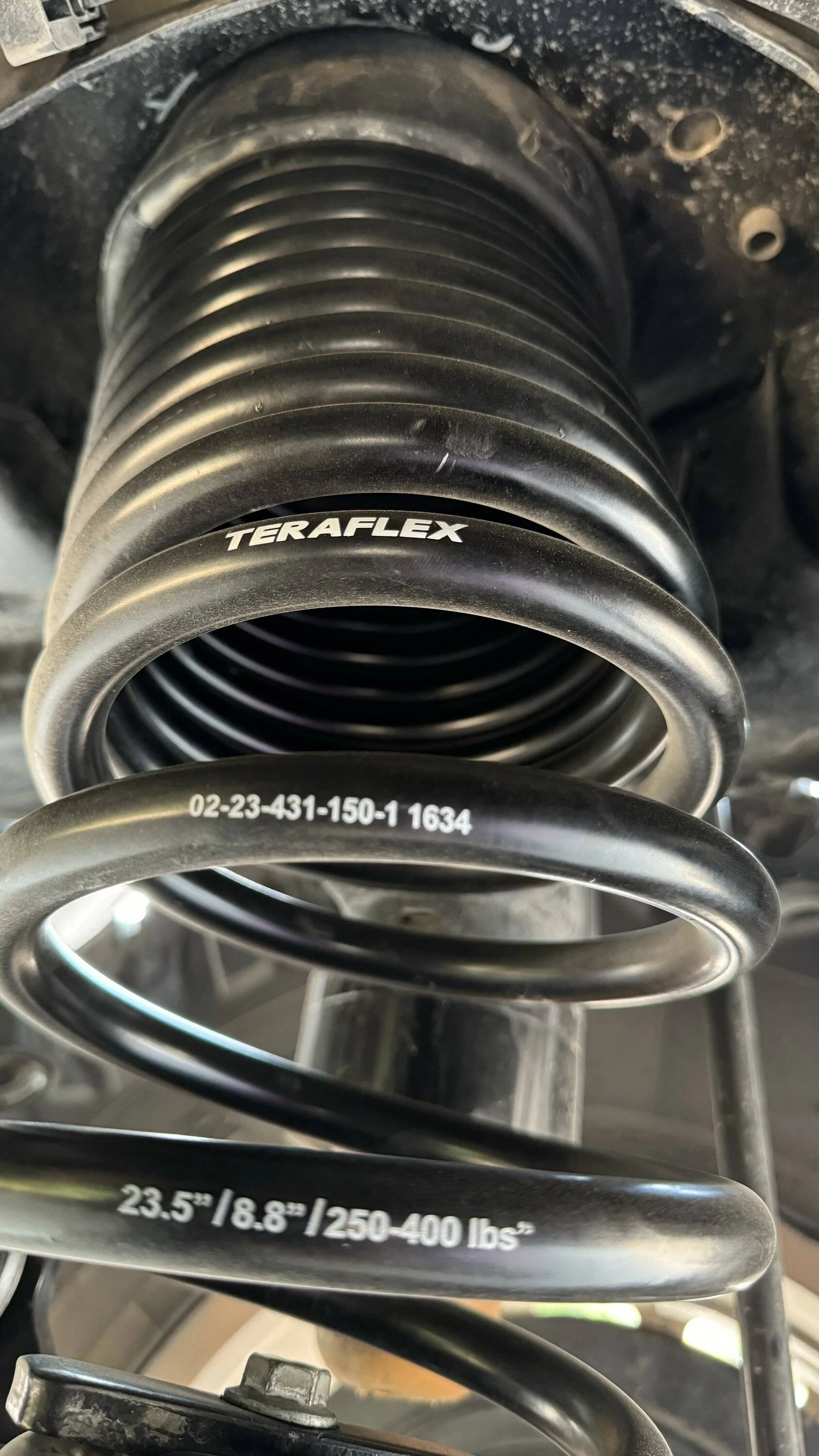

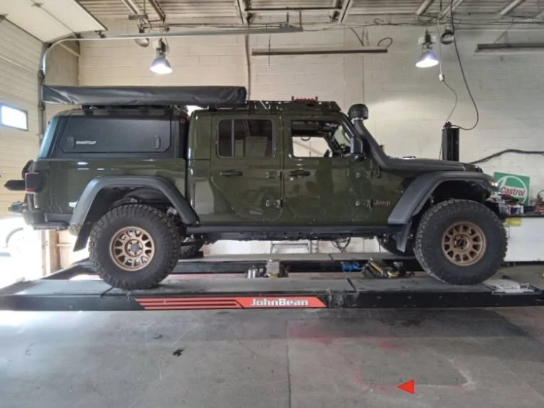

Good day,
Just finished having this kit installed, and the included springs were totally insufficient in the rear. Lots of sag right from the get-go. TF was great and sent out their Outback HD coils to try and it was more of the same!!
Ended up having to temporarily put a 2” spacer above the coil and a 3/4” below to get the Jeep stance correct.
My rig is an overlander with a Smartcap, Bedslide, Fridge, recovery and camp gear. No RTT mounted, so it could potentially be heavier than it is!
Wondering what others are doing, and if there’s a better spring out there I should be using?!?

Am I reading that right… you have 6 1/4” of lift in the rear and it’s still sagging that much???

You are not. The coil compressed too much, and the advertised 3.5” isn’t valid. We added 2.75” of spacers in addition to this compressed coil to get back to where things look appropriate.
11,491
30,616
Should weight your truck with all your gear to see how much weight you have on the front, rear, and combined. Give you a better idea of what's going on.

Spacers are not the solution. AEV has HD springs that are meant to work with a constant load on 400-700 lbs. You should have a rough idea of the constant load your carrying and then find springs rates to match.

Clearly not the solution. This is as temporary as possible. Looking into Clayton (but they appear to be the same 400lb rating as TF Outback but with a third progressive zone), AEV and Dobinsons (both linear). I’m hoping the next set of coils I purchase is the last. A little curious about the progressive vs linear, since the Teraflex lift has 16” of action in the rear that I might not see with a linear coil.…
