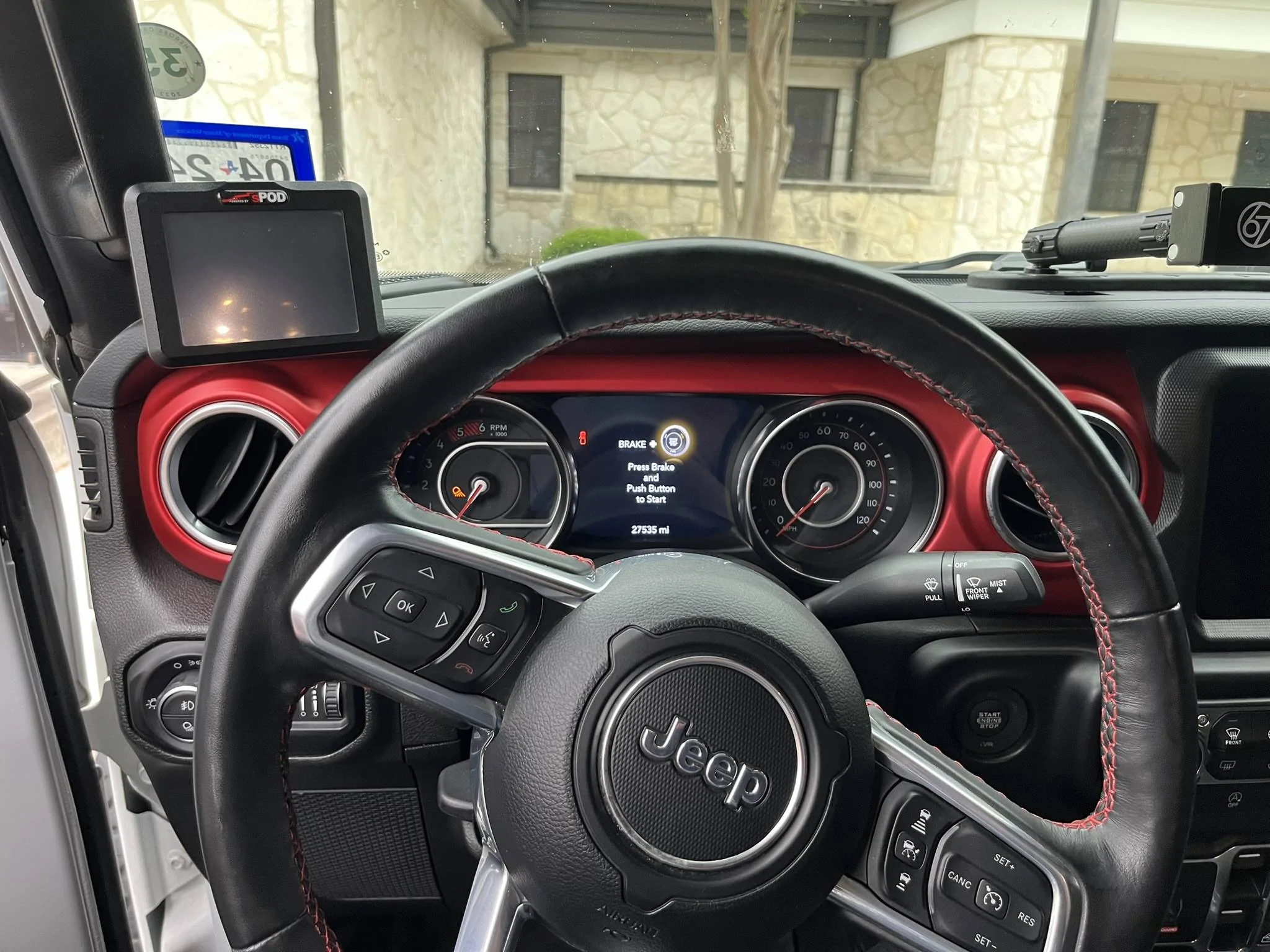

There is also the sPOD Bantam which can control 8 circuits rated at 30 amps at 12.5 VDC per circuit and can be expanded to add additional sPODs for more circuits if needed. I would suspect lower amp items wouldn't be an issue for it. My Gladiator came with it already installed but so far I have not hooked anything up to it.
sPOD BantamX Touchscreen
Jeep Gladiator Does anyone make a low current set of auxiliary switches? IMG_2464
