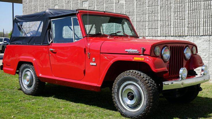

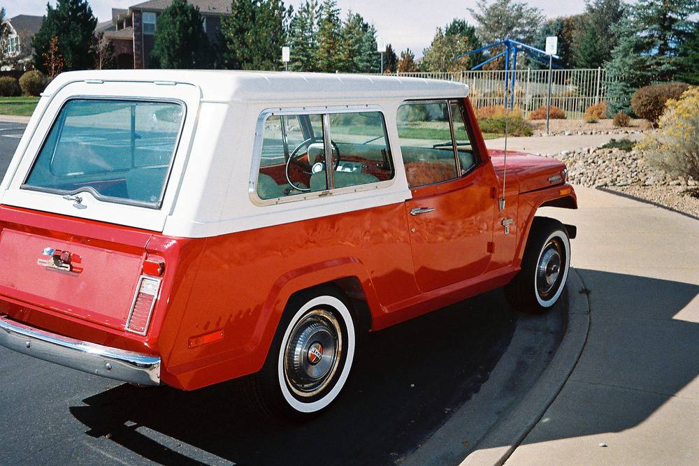

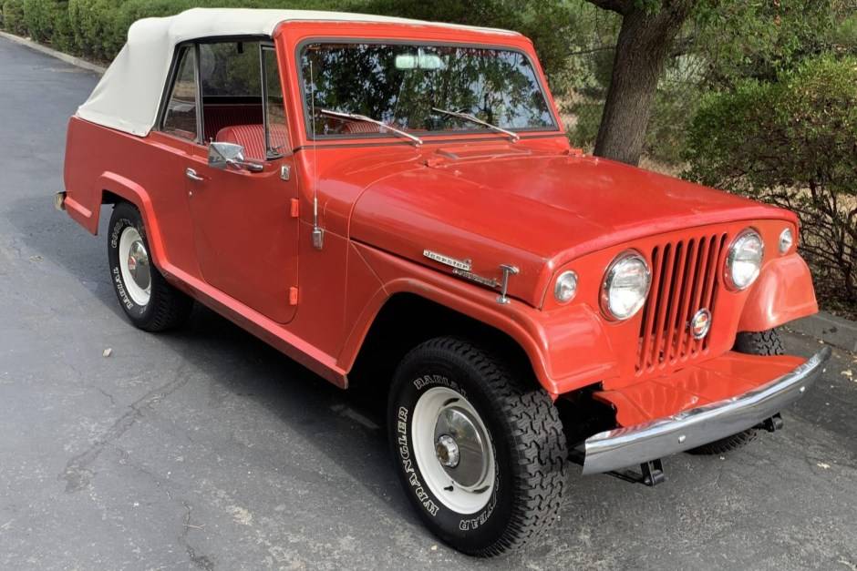

I heard a throaty engine coming down my street yesterday (highly unusual here) and looked out the window just in time to see a sweet, mint looking, purposefully dull red early 70s Commando with the cj-style grille and that classy sloping rear and, wearing a full black soft top and chrome dome hub caps. A thing of beauty for all the senses!

These days, that guy probably paid over $100k for that ride.
