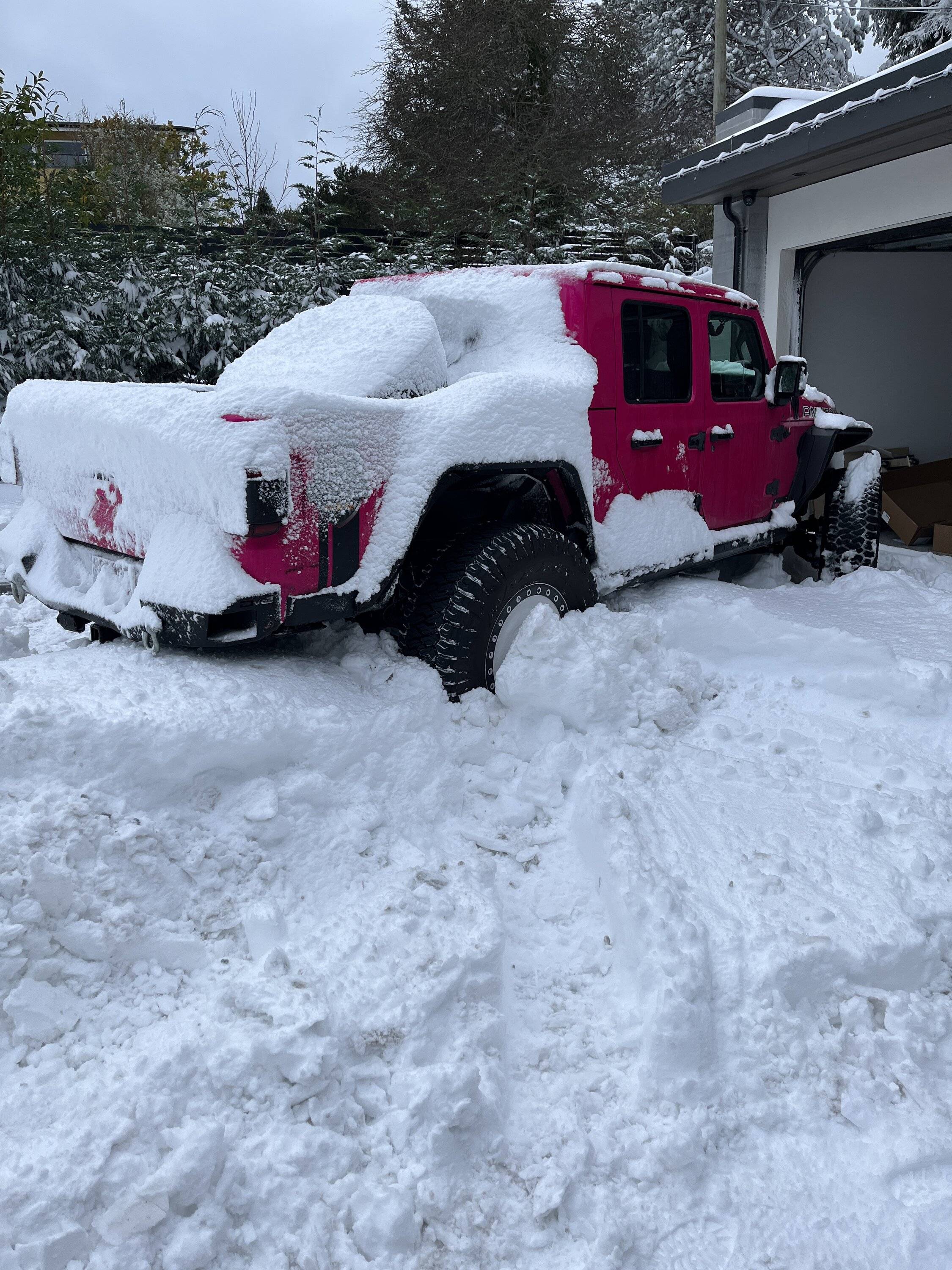

Nice, I had no idea there were any AT's out there in a 40"! That's cool :)
With it being on 20's you have a bit less sidewall to grab at and help clear/push past, so that could be a factor. The higher pressure is definitely the biggest factor that I can see. If you lower that pressure down to about 20-22 you should be able to "float" on top a little more, rather than just digging holes.
If nothing works, just keep spinning until the snow melts and your tires get hot lol. I used to do that all the time in an old work van I had.

What load rating are the tires? Mickey Thomson recommended that I run 27psi on my D-rated 37’s from them. I have no problems at any speed, and they have amazing traction in snow and ice. And they’re wearing perfectly.

To add to this. In my rubicon with 37” AT’s, if it’s deep, like 2-3ft drifts, I use 4 hi auto. It works every time. Easy on the pedal like you’re crawling. Just enough to move and it goes through virtually anything.

I don't think anything outside of snow tracks would be able to get you out of that first pic without any sort of engineering before hand. That's a lot of powder. Times like these, I'm glad I live in the desert - most other times I too think it is silly.

There is no one "solution" to your problem, since different snow conditions demand different strategies. But one thing you need to do is drop that air pressure. Start at 10lbs and work down from there as needed. You'd be much better off with 17 inch wheels beadlocks (preferably Icon Rebound Pro's type) rather than 20's. At least your tires meet the 3PMSF standards. But your #1 determining factor is driver experience.
From the sounds of it, you're new to 4wheeling in deep snow, so I'd recommend getting out into the snow and practice, practice, practice. Snow conditions don't just change from day to day, but from hour to hour, lower to higher elevation, wide open to tree covered, and from one side of the mountain to the other. With experience comes the ability to "read" the snow and adapt your strategy to compensate.

Flotation is the best method, so airing down is best. You'll have to rock it a bit to be able to get enough speed to float on top instead of pushing & compacting the snow.
Then as the snow starts to melt and turn slushy, you want thinner tires so you'll have to air back up.
