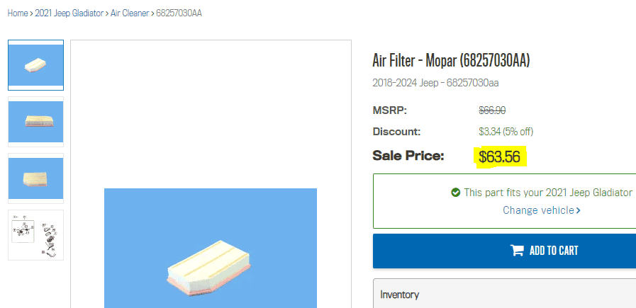

Why would someone steal an air filter?
I think it's because they are almost $70 MSRP and with the right tools you could pop one out in less than 30 seconds.
