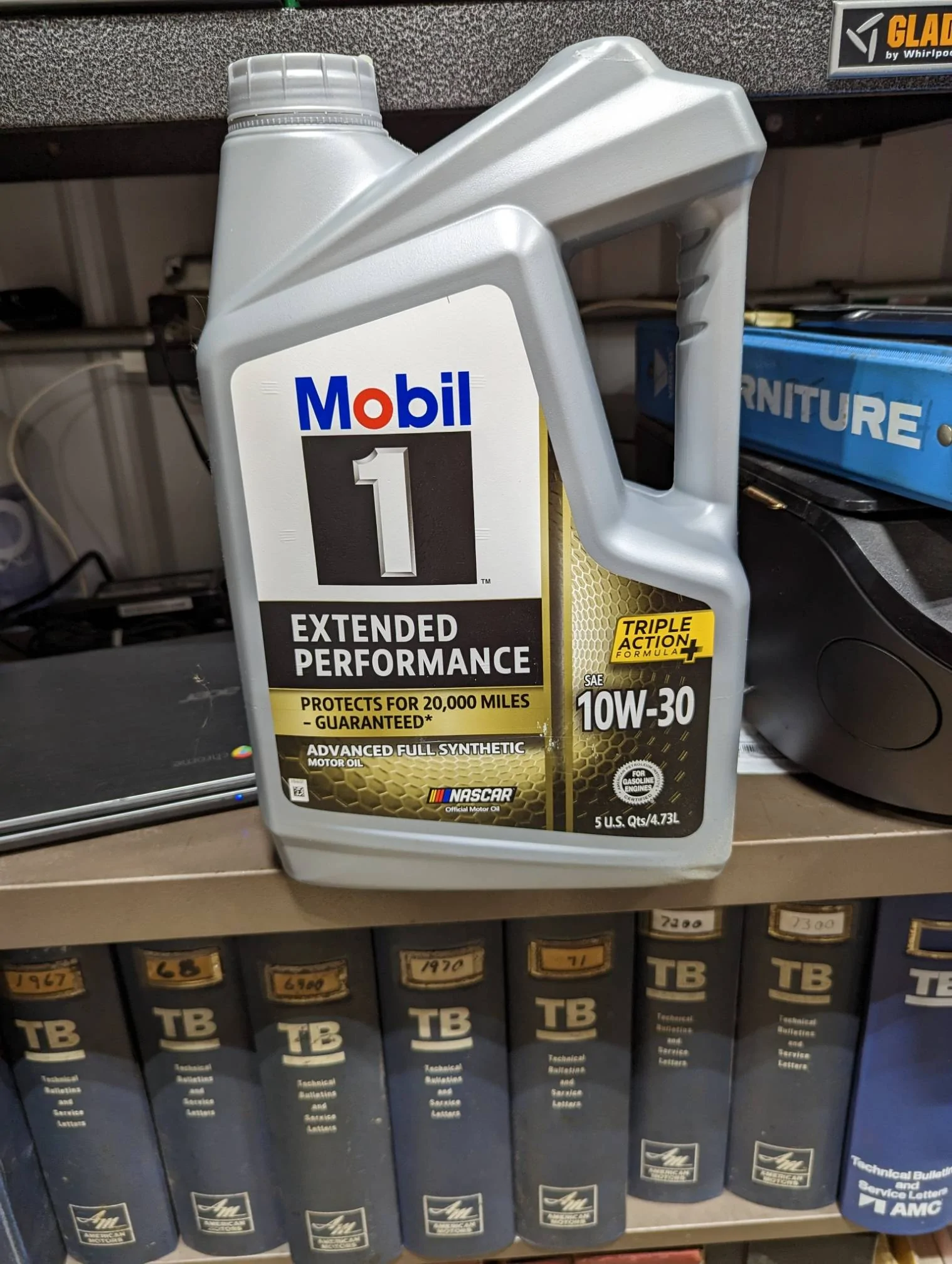

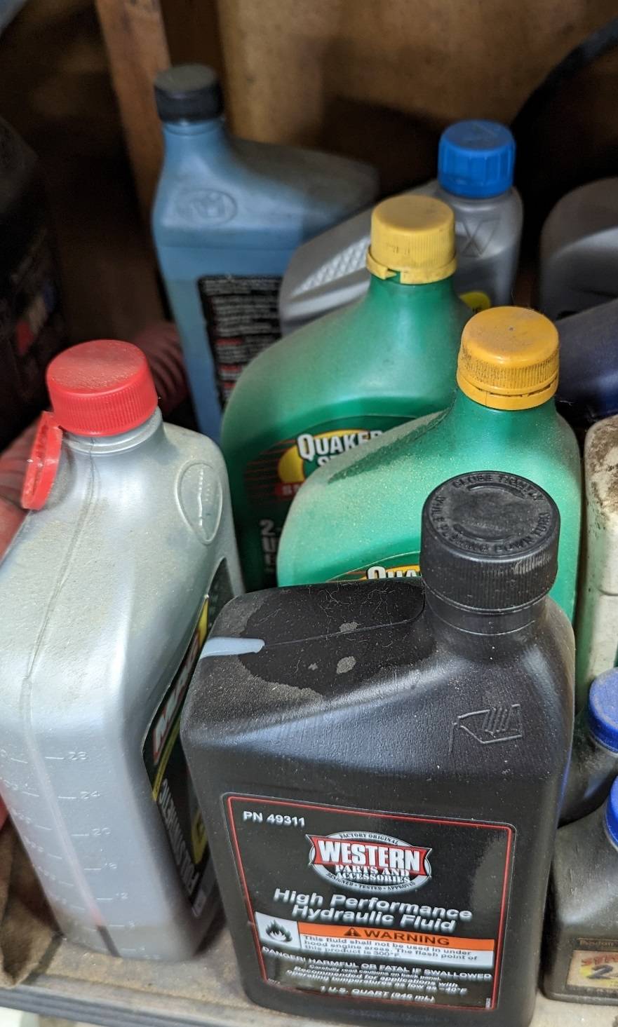

I didn't dig back, but a couple of bottles on this shelf look suspiciously like they came from Walmart ? Yeah, I've used their products. And yes, in a rather high compression performance engine.
Jeep Gladiator Engine oil -- what weight and brand do others use? PXL_20230609_133354744

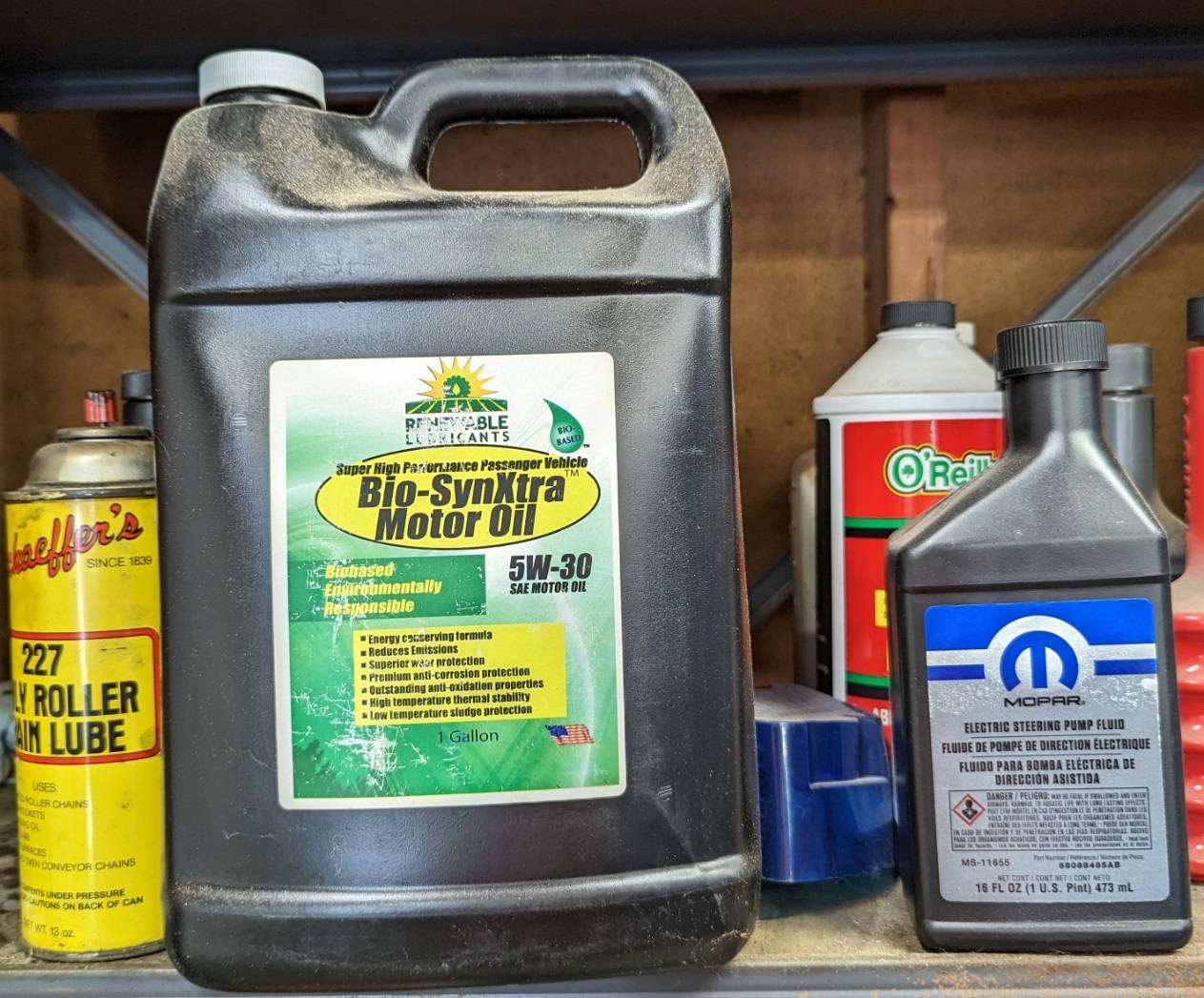

This stuff is amazingly "slick". I had to readjust the carburetors on my 360 after using this for a while - idle speed climbed and even with the cam it's got, idle smoothed out a bit. Gee, did I have sticky lifters?
Jeep Gladiator Engine oil -- what weight and brand do others use? PXL_20230609_133425996
And this just went into my sort of built up 4.0
I've used it in that engine since the very first time it was fired up. I drove it out of my shop with this oil (well, not THIS oil, it's been changed a few times since). I did use the biosyn in it a couple of years ago for kicks then decided heck, it was broke in on Mobil 1, it's not got any oil leaks, it doesn't "burn" any between changes, keep going. It's still a top rated oil. And since the car sits a lot, I don't mind the extended use category, either. It will never go 20,000 miles LOL heck no, but it may sit a few months during the winter so it's good to have an oil that can handle that. (Interesting that most of my shop cabinets and stands are - Gladiator.......)
Jeep Gladiator Engine oil -- what weight and brand do others use? PXL_20230609_133705531
So, brand loyal? I have favorites but hope I'm not brand loyal to a fault!?!
