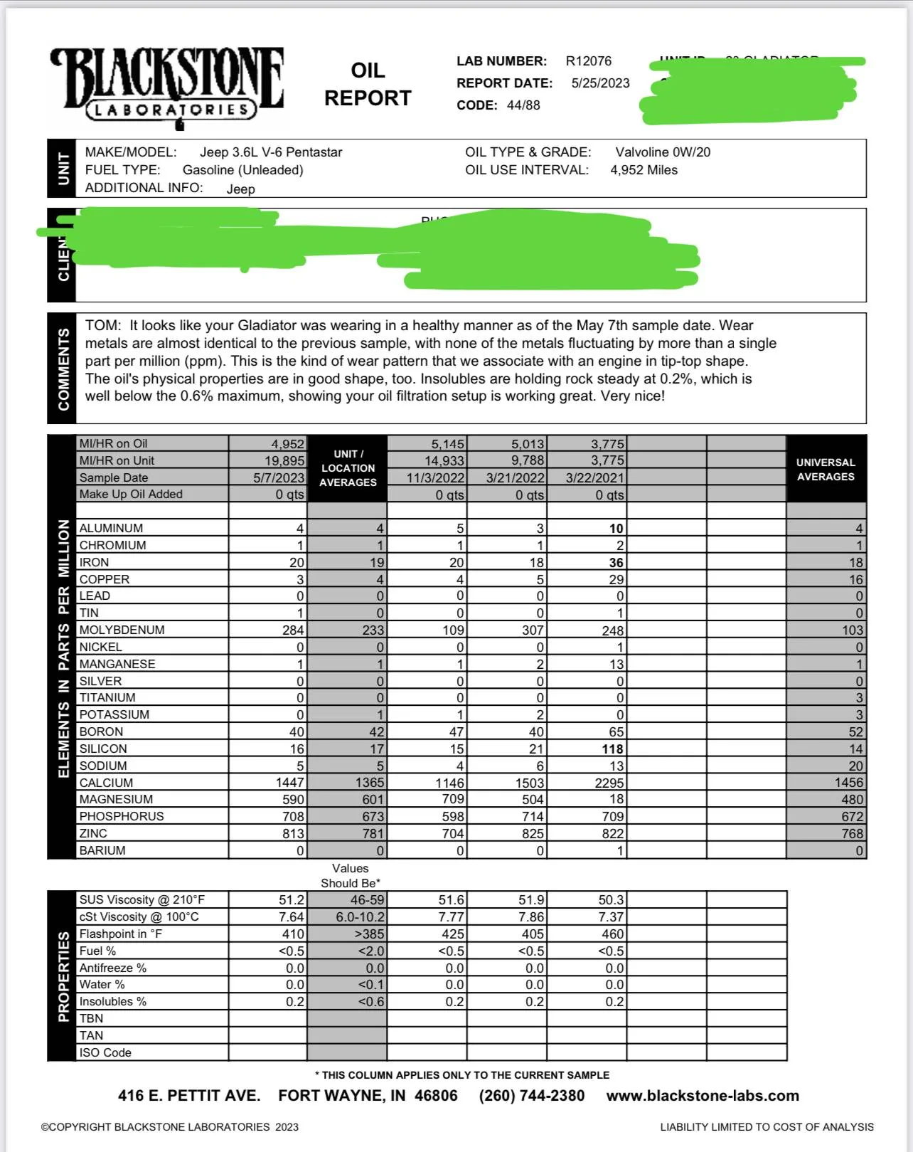

Since we’re resurrecting zombie threads:
Valvoline OW-20 Synthetic every change and you can see my UOA here
Good looking report. Nice to see current Valvoline formulation with a health dose of Moly instead of sodium like they use to.
