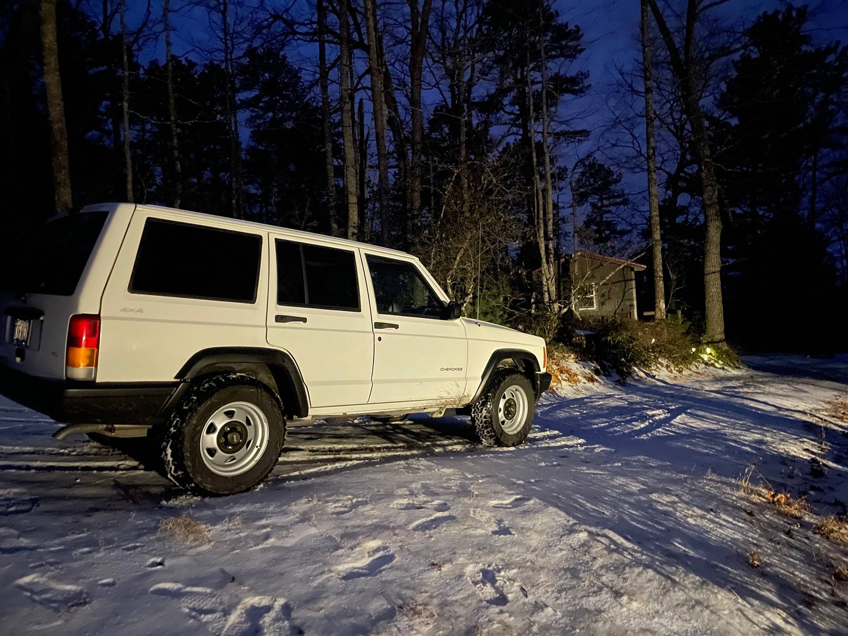

So I just looked up removing the aux battery (to potentially charge it separately). All I can say is WOW, what a dumb location. I’m going to charge them together first just to see what happens.
While I’m perfectly capable of pulling the entire drivetrain…I don’t want to tear apart my new jeep. This might turn out to be a well enough alone situation.
Besides the 99 XJ is always ready to go.

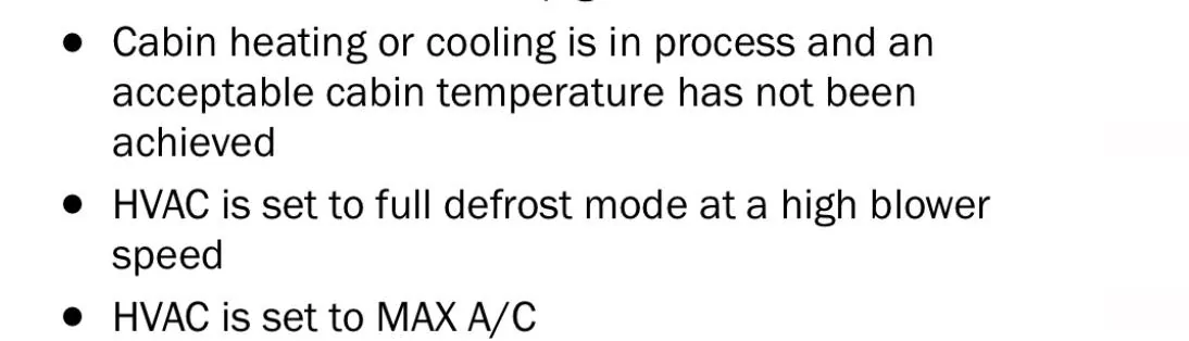

I know it seems very basic, but did you make sure it wasn’t one of these:
Jeep Gladiator ESS not ready IMG_0369
Sometimes it’s the most simple of things.
