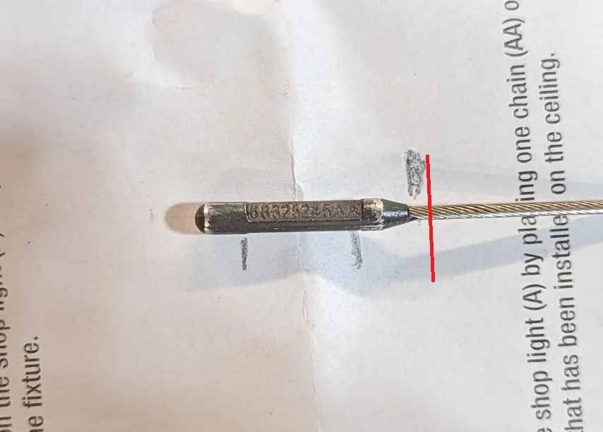

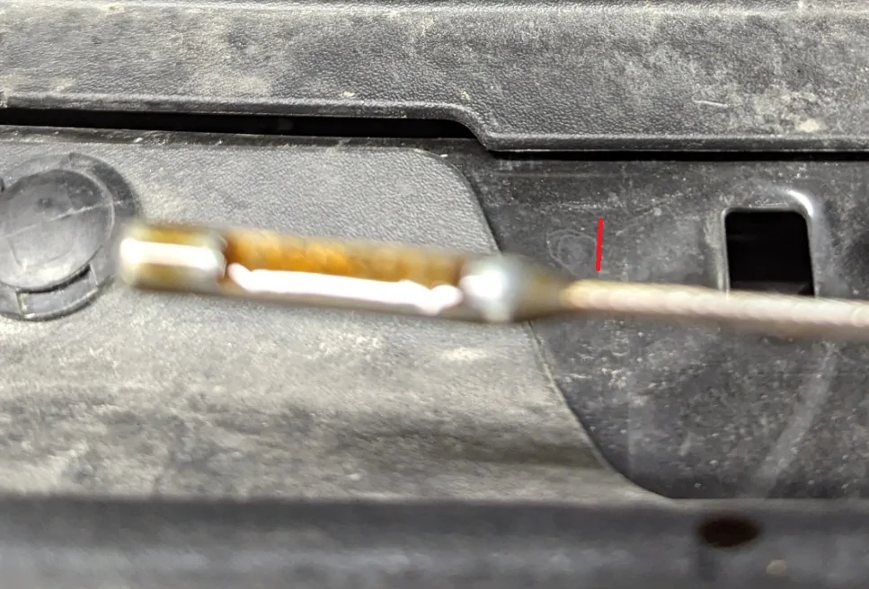

Yeah, 5 qts cold is exactly at the top of the fill range on the dipstick on mine.
I find the Jeep 3.6 dipstick to be notoriously inaccurate.
With exactly 5 quarts put back in, run, then shut off for a couple of hours, mine reads up over the molded part back onto the cable.
Good observation. Mine, 2023, 5 qts. is exactly at the full fill mark, which it should not be when cold. "Cold" in this instance meaning after an oil change, and adding a 5 qt. jug, then waiting fine minutes or longer.
So, is Stellantis increasing profits little by little, like a cm of cable at a time? Joking, but, maybe not...
Only if they own a big portion of the oil companies or the outfit that makes the cable for the dipsticks😂😂
