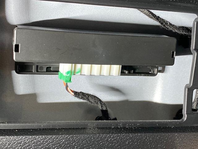

Ok, I pulled the plastic cover off of the rear drivers side bulkhead and I am assuming I have the CVPM but only has the one cable coming out - see photo. As one can see just the one cable (appears to have 3 wires bundled into the plug small grey black, orange/white, and I think solid orange)
My Rubicon specs are: Full LED light package, 8.4 premium Alpine LCD screen/ radio, and just plain old cruise control. Wonder what the other cables are
for on the earlier pics. Hope this helps.
Edit: Wait is the photo of the CVPM or something else? I was assuming earlier that the photo is of the CVPM but I may need to be corrected.LOL!

that is an awesome car. i am an old car person. i have a 1972 mercedes benz 350 sl roadster and a 1969 ford galaxie xl gt convert and my students always ask what is my dream car and i tell them the sunbeam tiger because it was the car that Maxwell Smart drove for Get Smart. as to your gladiator. that makes sense because my overland has three connectors to the can bus and one is from the main assembly and the other two are for the blnd spot monitoring system. the short answer is that you do not have the CVPM in your vehicle because the wiring is not there. i am sorry.
