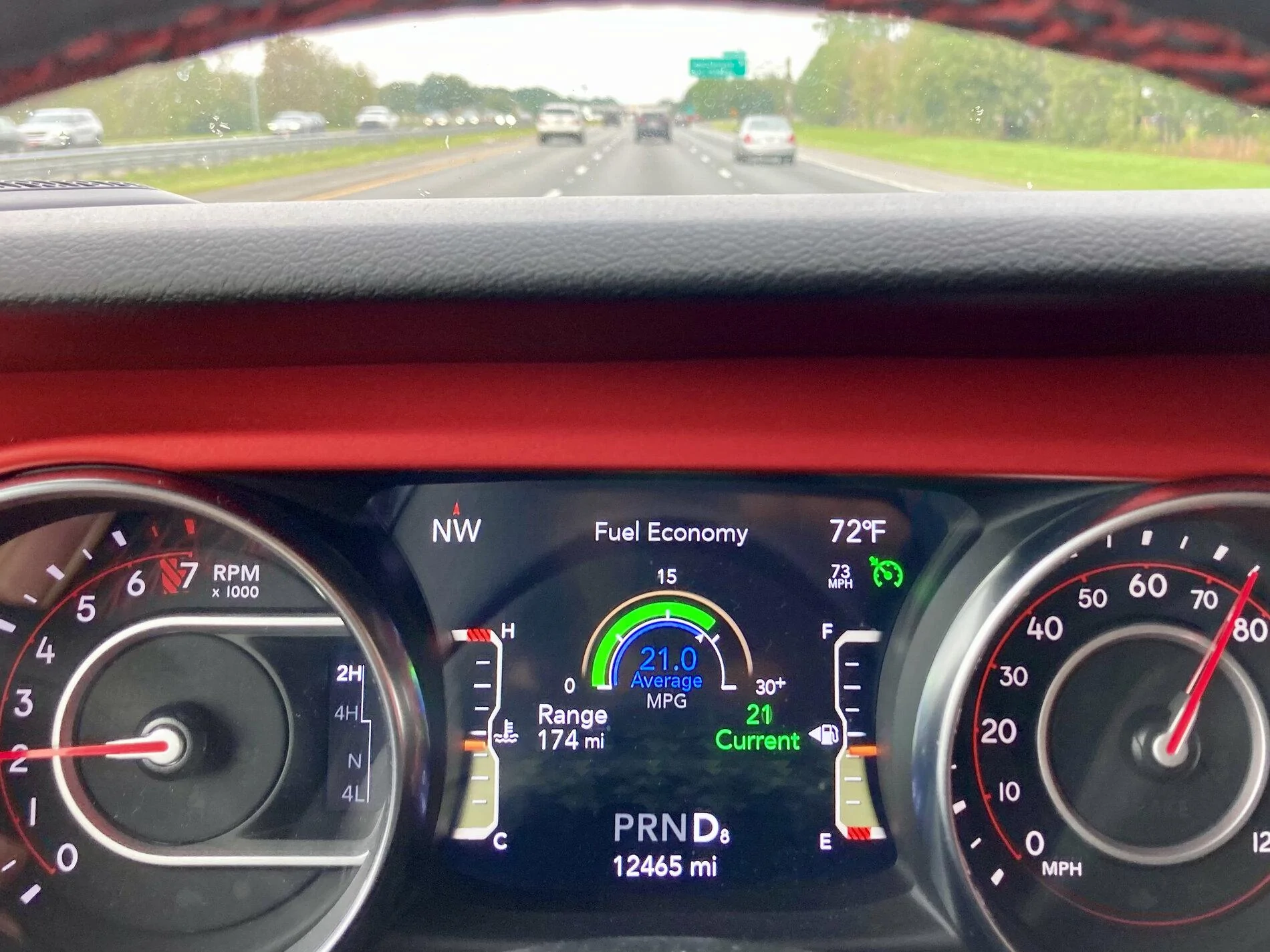

I don’t usually post in a thread that has so many variables, but have driven a similar route a couple of times; SC to TX in stock JTR with 33 inch AT’s. I average 20-21 mpg holding at around 73 mph. Checked manually, and for me the truck’s computer was accurate as long as I reset it for the trip.
I have made drive from SC to Miami many times and always get the same at about 21 mpg, holding 73 mph.
I currently have 13k miles on truck. The first time I took a long trip was with a few thousand miles so can’t say if it was lower before that.
Average mixed mpg is 18, but will drop to 16.5 if it’s almost 100% city.
One factor that might make Mojave worse, is I think it has a 1 inch level lift from factory, which certainly would impact aerodynamics.
