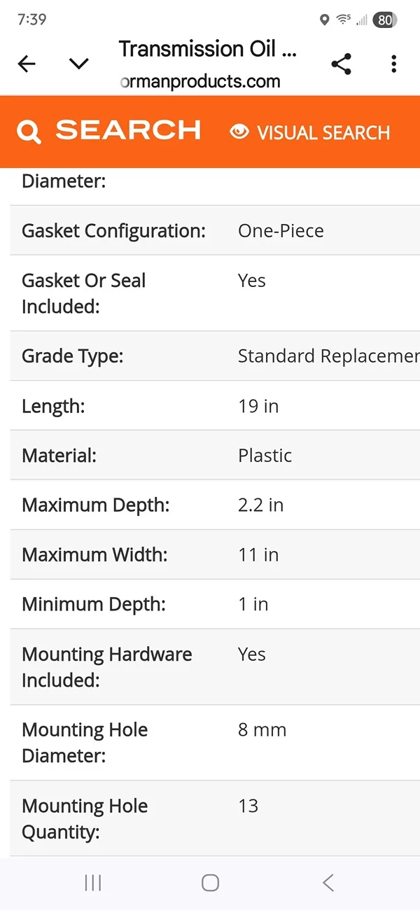

Jeep Gladiator First Transmission Drain and Fill Screenshot_20260112_094713_DuckDuckGo

That is the plastic pan that is usually installed on ZF 8 Speed passenger car and RAM 1500 vehicles.
That is not an equivalent to the steel pan that is installed on JL and JT model vehicles. One would give up some protection installing that plastic pan for the sake of the ATF fluid drain function.
