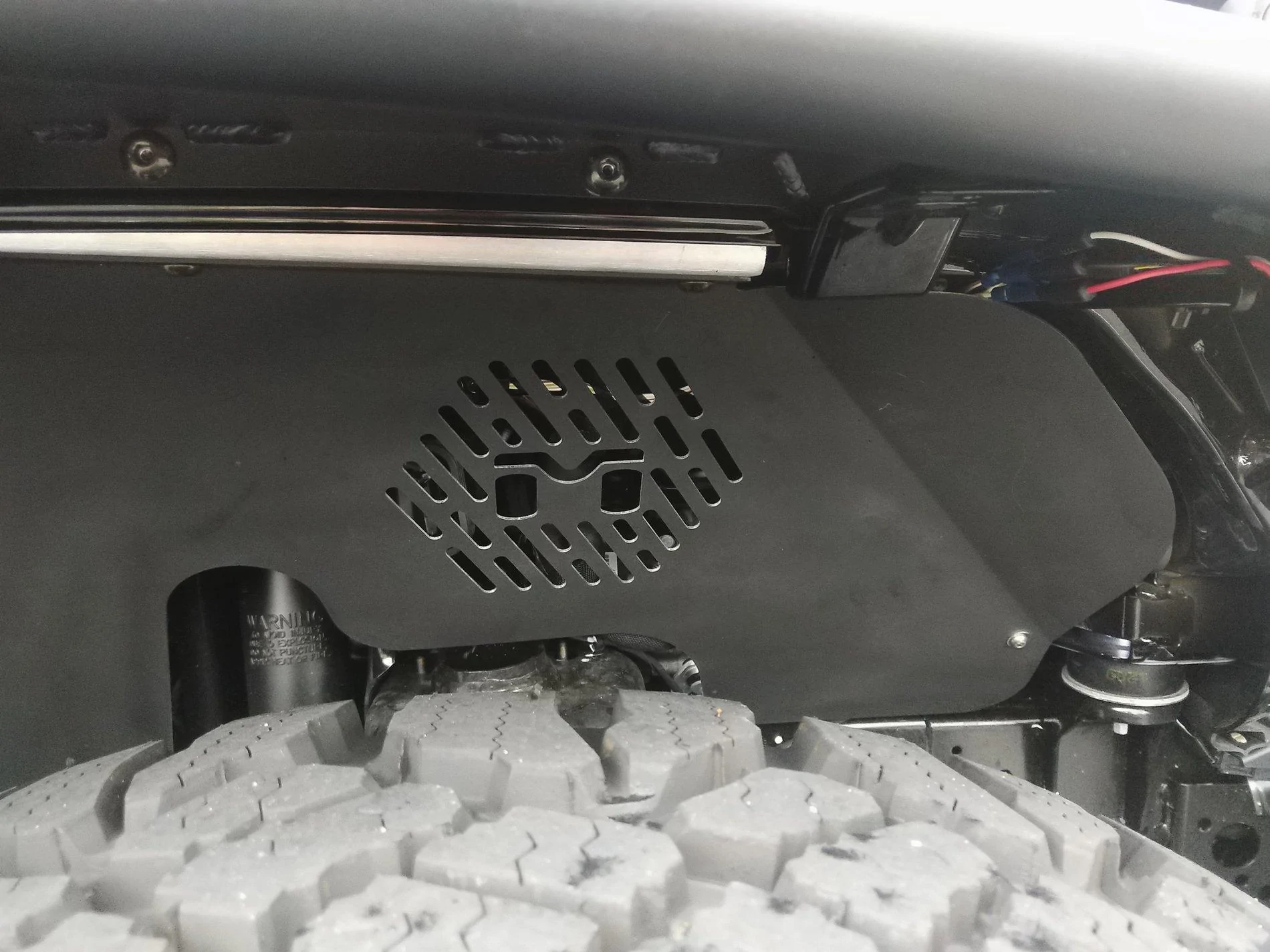

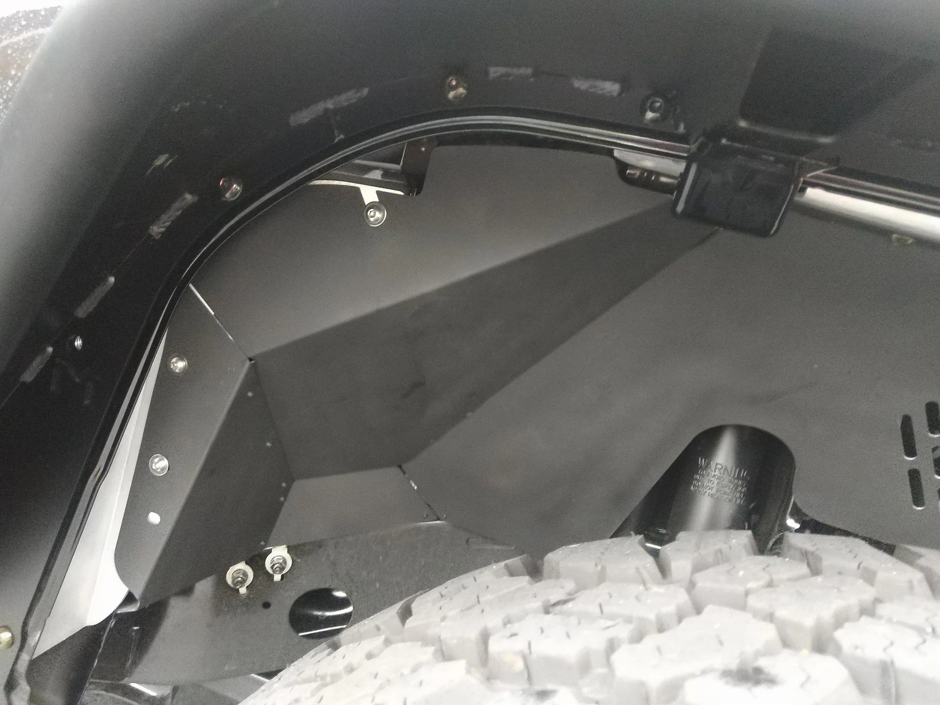

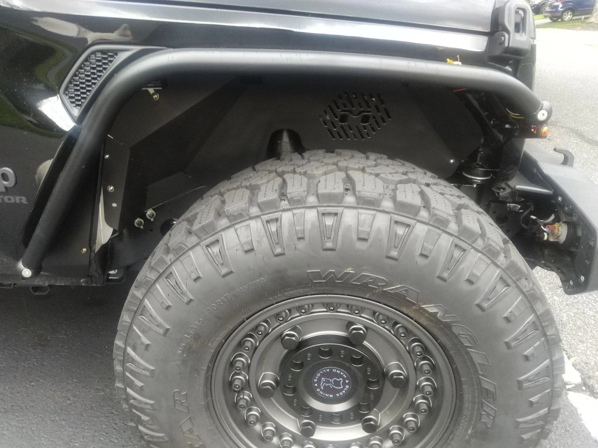

So I've been saying just rip them out and put new ones in. I finally got time during this long weekend to do that, even though I didn't have any problems yet.
Super easy to do and looks a hell of a lot better. MC JL inner linners.

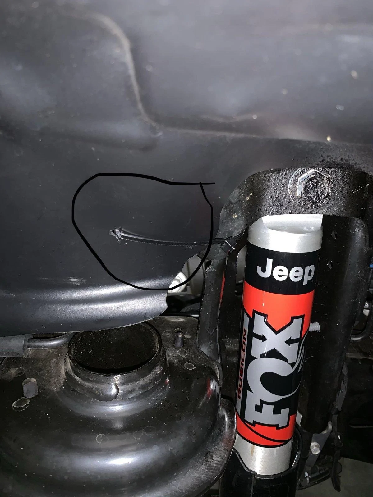

Just discovered this myself. Passenger side, Rubicon 33’s no mods. I just finished an 800 mile road trip the Sierras and back from Phoenix. Guessing it happened on the way or back (temps were 100+ and at 70-75 mph sustained, can only imagine the beating those paper thin liners can take). 7.5k miles on it now.
Guess I will call the dealership and schedule in. Also had a windshield replaced due to a rock chip...took a month to get the replacement due to availability. So now thinking about these fender liners...what kind of replacement time are people seeing? Wondering if I should contact the dealership about parts availability first.

Buy aftermarket and install them. will never have a problem. Much sturdier, looks better and they usually have better venting (like the MC ones I installed).
See my post two replies above.

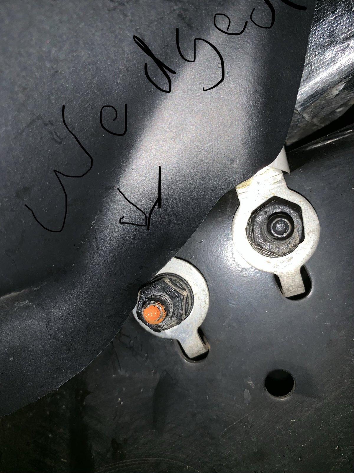

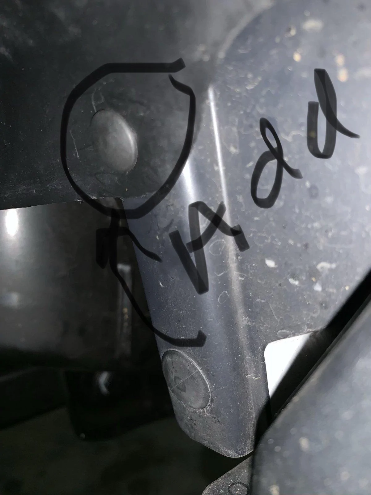

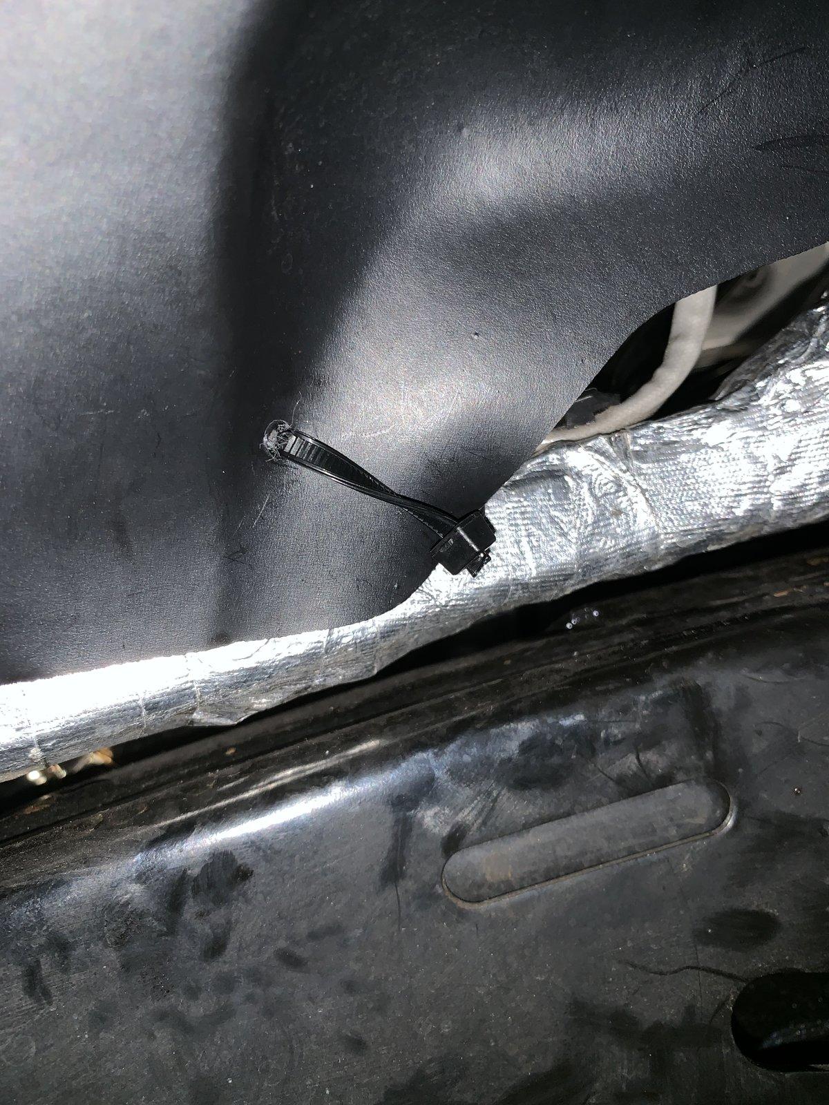

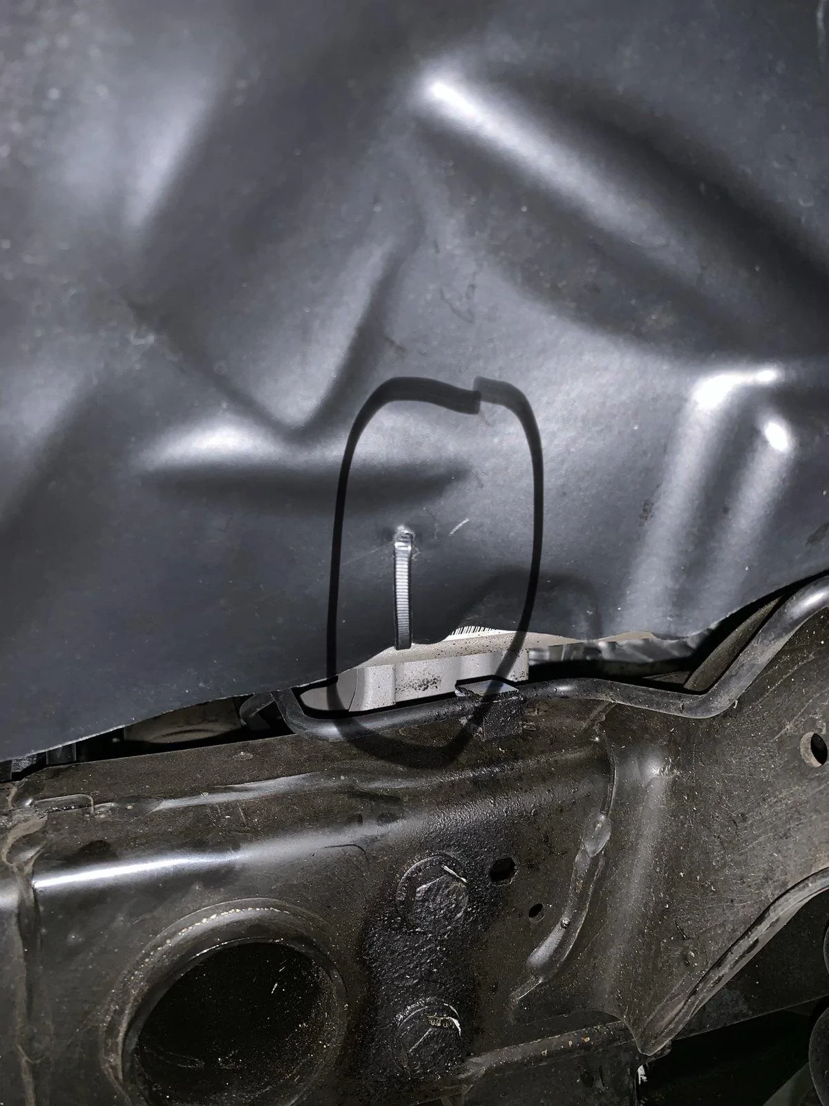

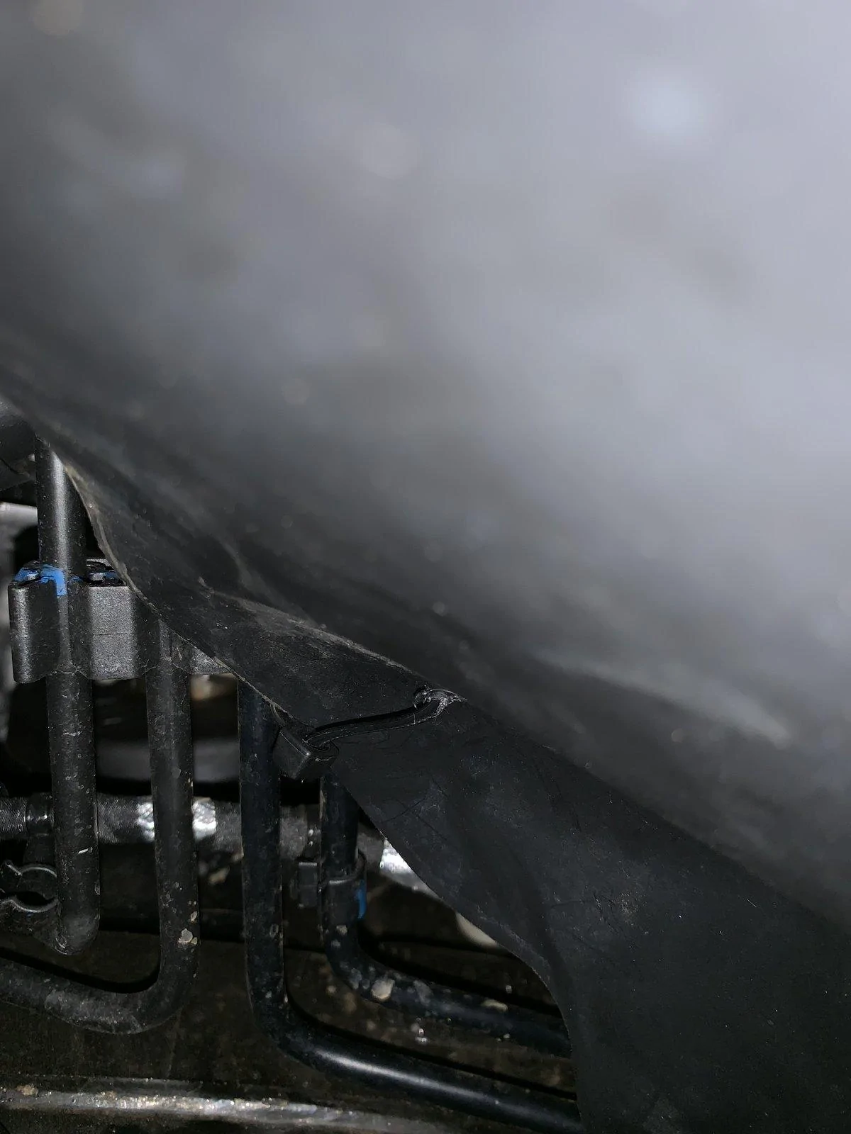

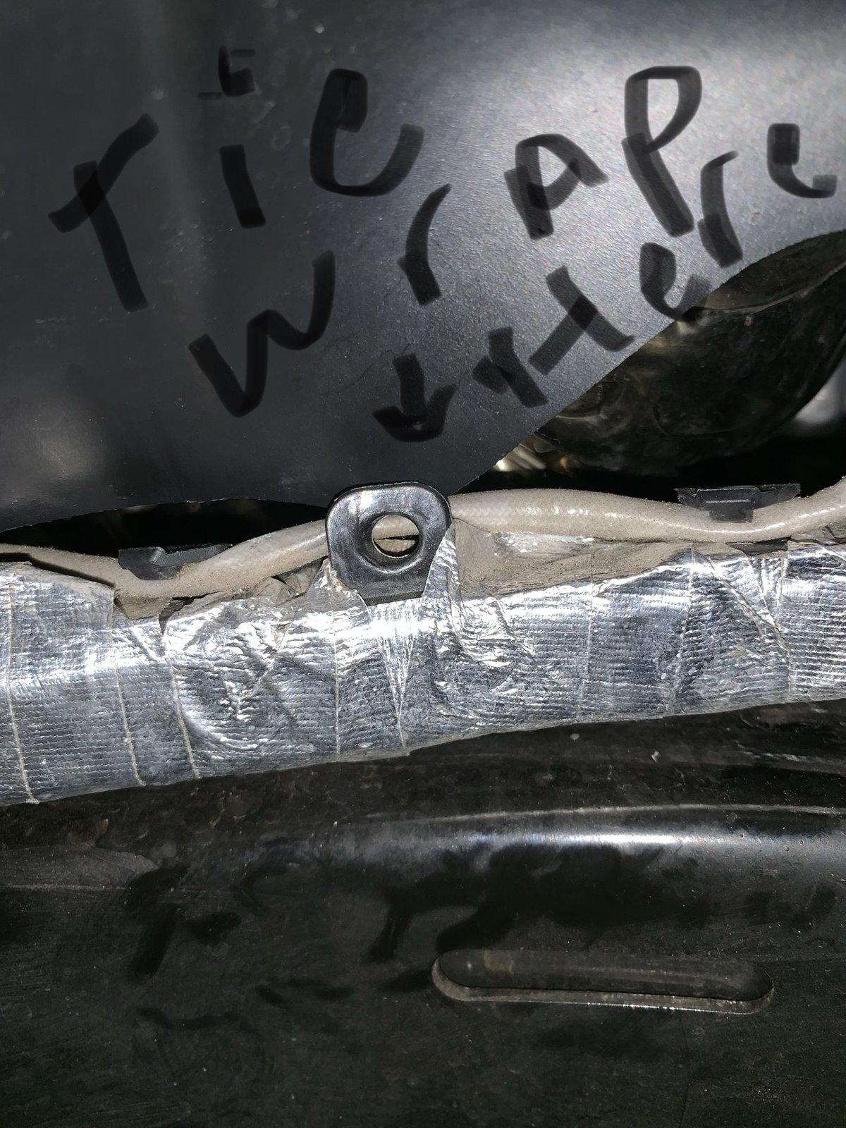

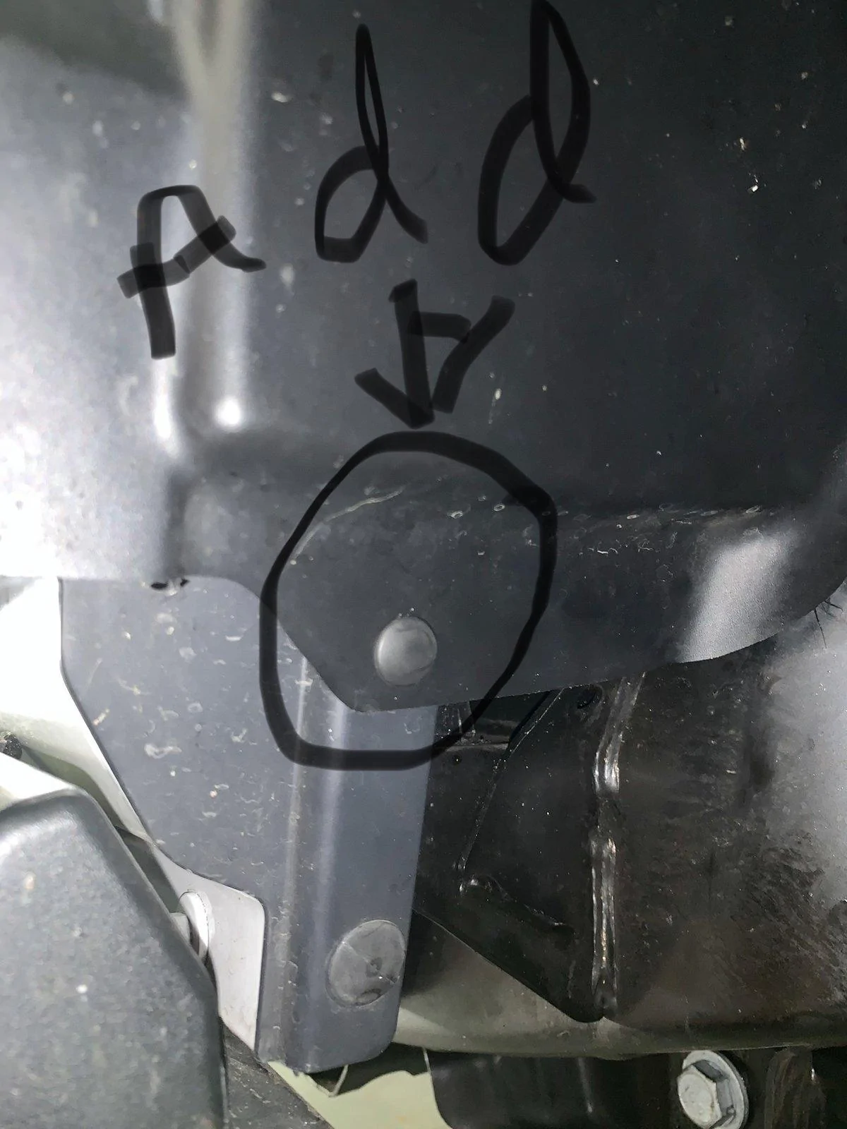

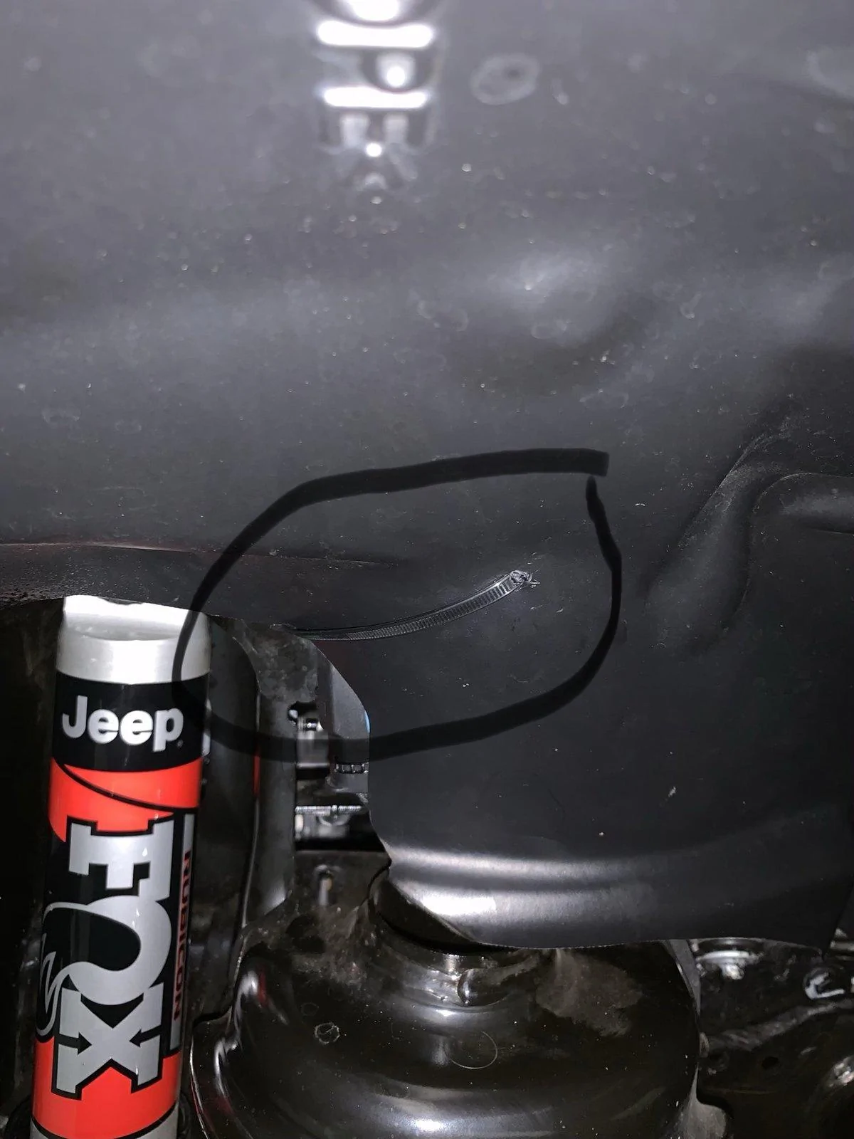

I’m planning to remove these poster board thin inner fenders when I upgrade my tires and add something metal and nice. Until then, I went the tie wrap and push pen approach for now to buy me time before this rub destruction happens to me. Here are some pictures of what I did to tighten things up under there temporarily. I hope it helps as a preventative maintenance for now.
Jeep Gladiator Flimsy Front Inner Fenders 2FF06D14-3CF7-4591-B607-2A59FFF065C3
Jeep Gladiator Flimsy Front Inner Fenders 11572A9D-19AF-4DAD-881C-1AE7AD25CD38
Jeep Gladiator Flimsy Front Inner Fenders 2F6407E6-1583-4B04-B97B-7DA2EF7F9513
Jeep Gladiator Flimsy Front Inner Fenders B1F7F7C3-5013-4D24-AC44-4DDDFFD3A915
Jeep Gladiator Flimsy Front Inner Fenders CAC20E18-AB53-4064-82FB-DA95EFBE5E4B
Jeep Gladiator Flimsy Front Inner Fenders 5DF8FC41-0050-4AFD-84F0-A5D3E0132229
Jeep Gladiator Flimsy Front Inner Fenders A5866405-4008-43F4-80ED-4663AA6DB9A6
Jeep Gladiator Flimsy Front Inner Fenders 3E355789-F10D-4BF7-BDCB-D9B78BEC20E7
Jeep Gladiator Flimsy Front Inner Fenders 9F63B44D-3536-4FED-8D56-FBD6B663CD6F
Jeep Gladiator Flimsy Front Inner Fenders F7C1F59D-E427-4976-AE79-67D786AD85AA

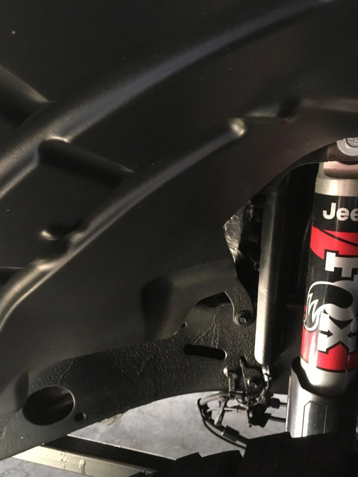

Just got my first service. They replaced the inner fenders with some much better ones.
