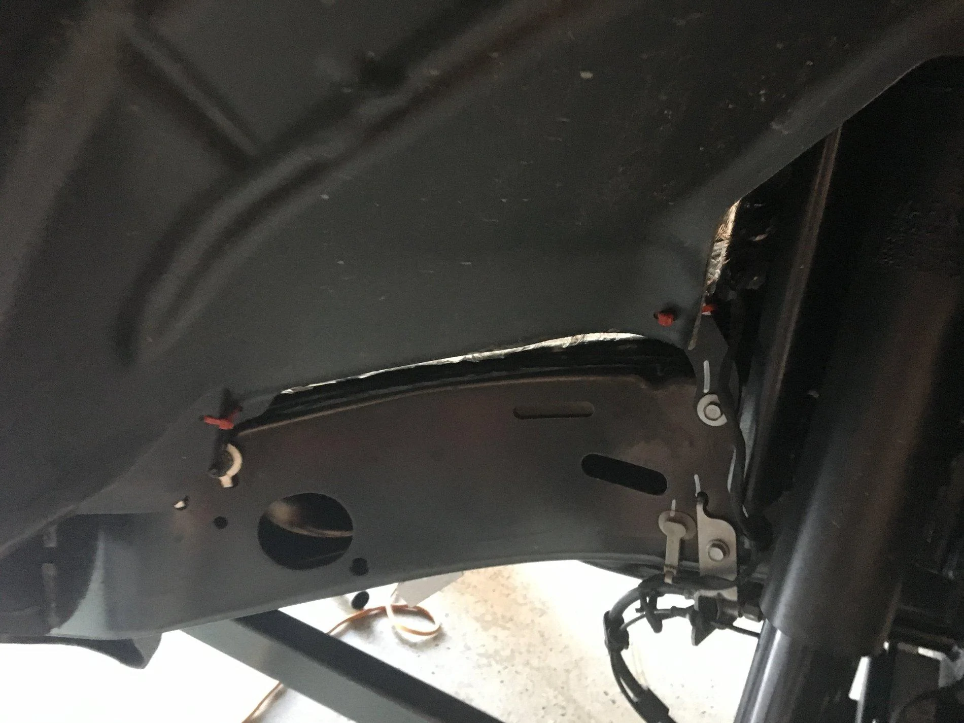

I just installed a lift on my jt and, after reading this thread, decided to head off the fender flap. I drilled holes and zip tied them to the frame. So far no issues.

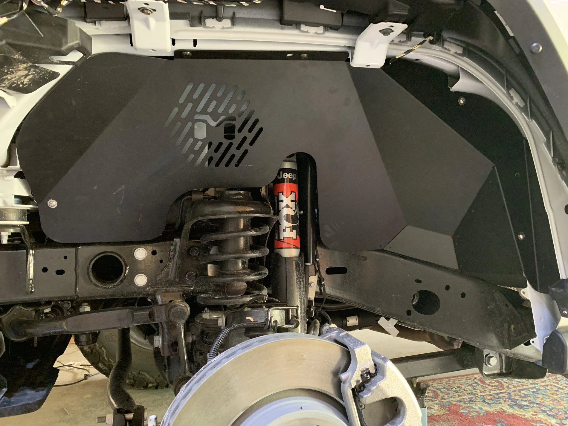

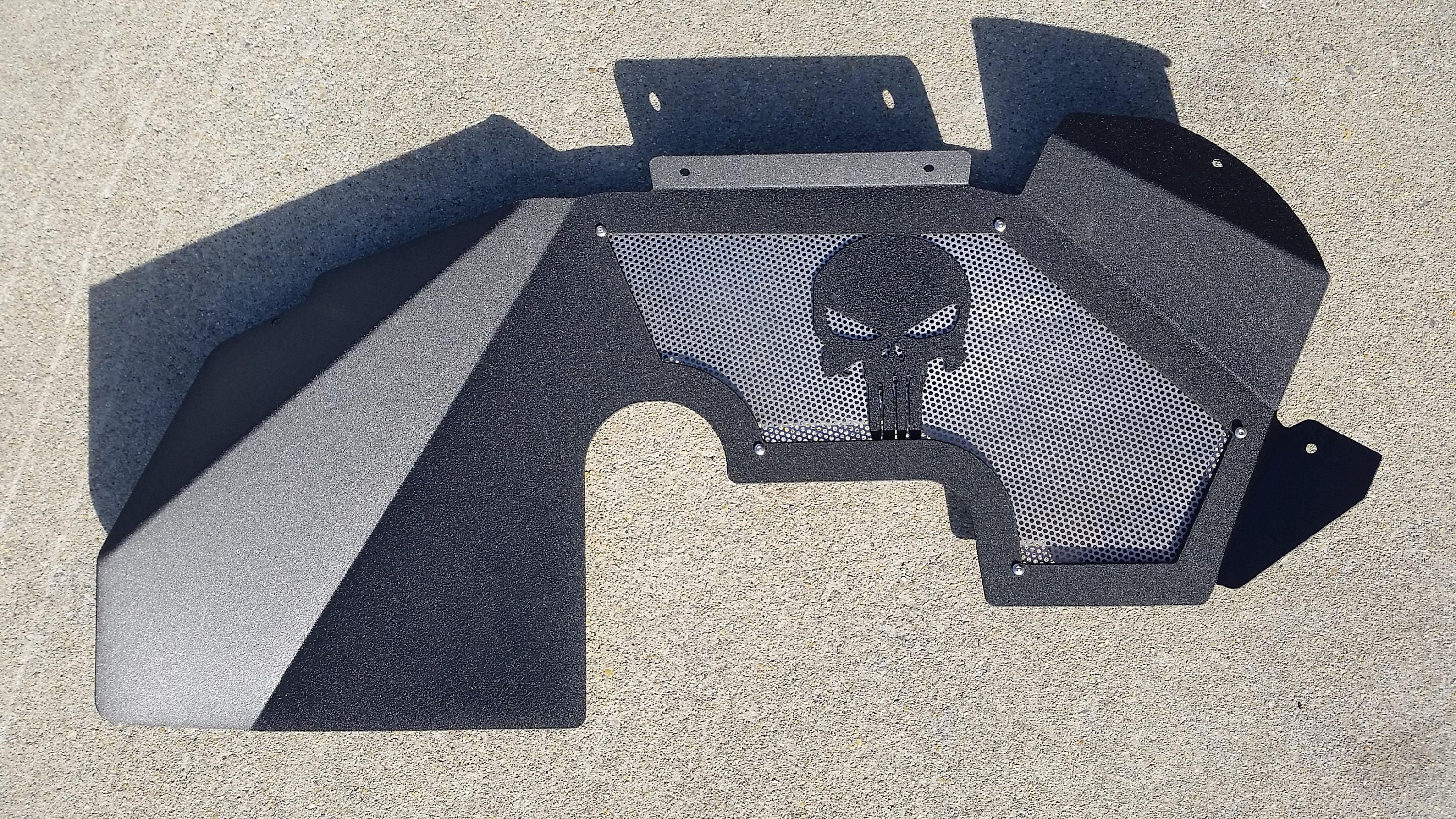

So just got through installing the drivers side MetalCloak inner fender. My input
1. Get ready for a struggle
2. Stock fenders will not have as much protection part of the old liner covers the fender interior
3. When/If you purchase make sure they include 8 of the larger button head bolts takes for per side( spoke with MC and they are revising their JT kits
4. If you don’t cuss now you will by the time you are through
5. Expect to spend longer than they estimate for completed job.
6. The folks at MC are absolutely stand up people they are over nightingale the correct number of bolts( when you live in a town of 1200 your local hardware store is no help
