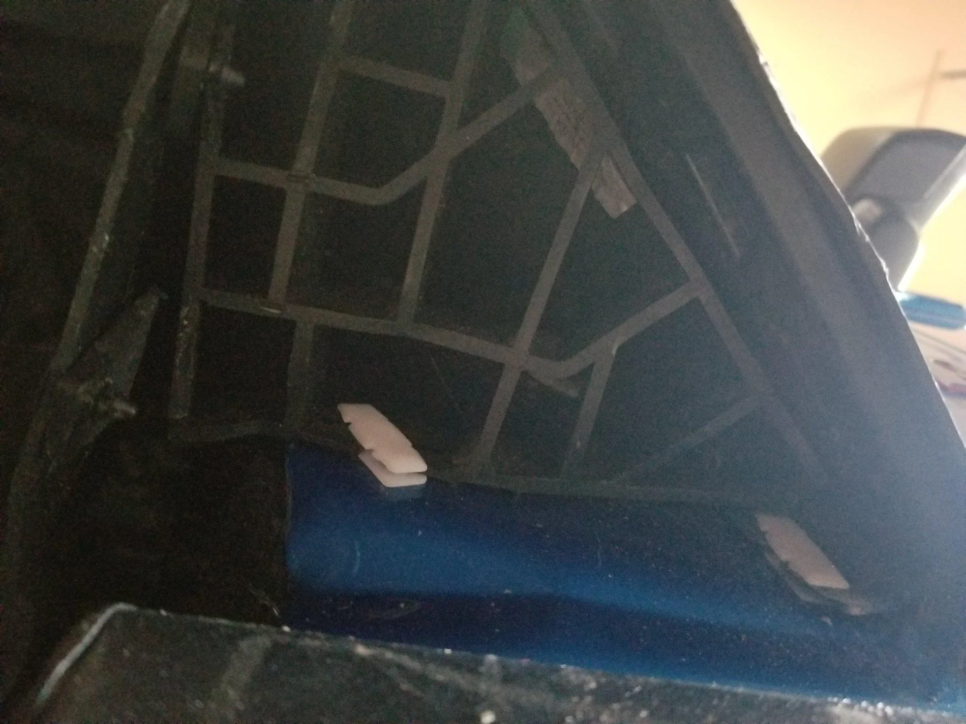

I'm not sure where to put this question but it is related to the inner fender. I backed into a stump with my front fender and broke a brace that goes between the inner fender and the outer painted tender on my JT Rubicon. I've been scouring the MOPAR parts websites and can't find this waffle looking piece. There is a part called a Sill Cover (68394597AA) but its not the right part. I ordered one and not the right size or shape. The outer painted fender is fine, just a couple of attachment point on this part are broken and I should be able to fix it with push pins and a couple of new rivets. The two busted tabs are on the left in this photo. Can anyone point me to the right part to fix this?
Jeep Gladiator Flimsy Front Inner Fenders 20200610_192636
Try asking @AllMoparParts.com here: https://www.jeepgladiatorforum.com/forum/threads/what-can-we-do-for-you.21910/

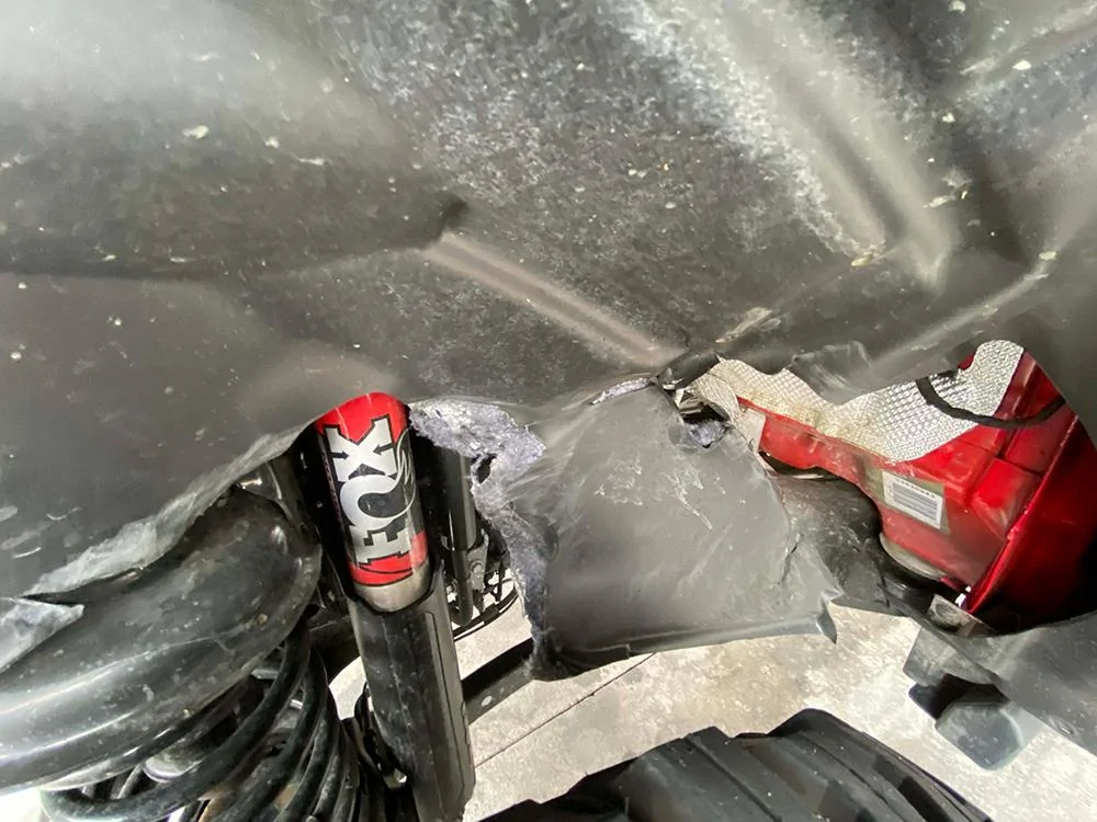

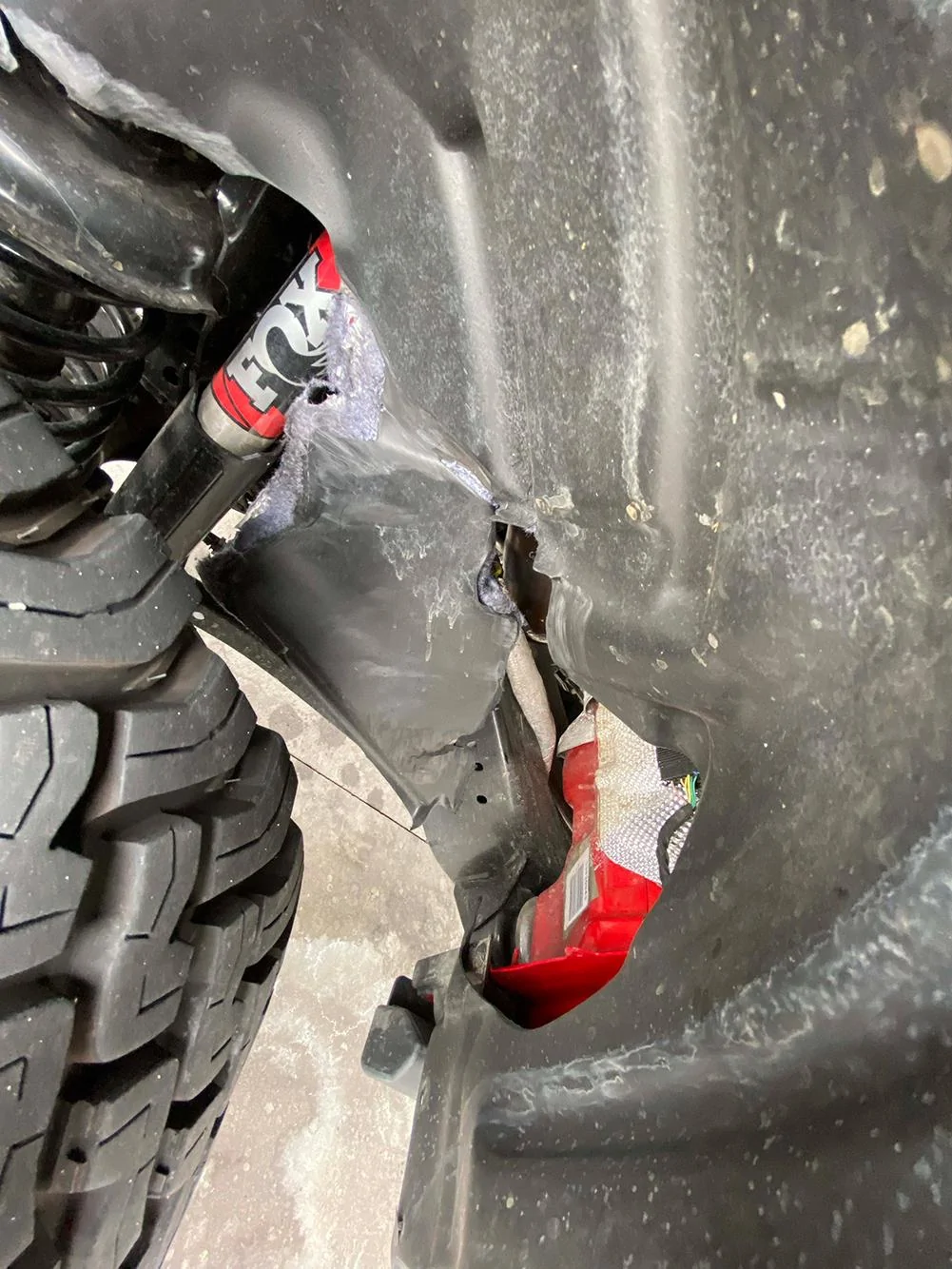

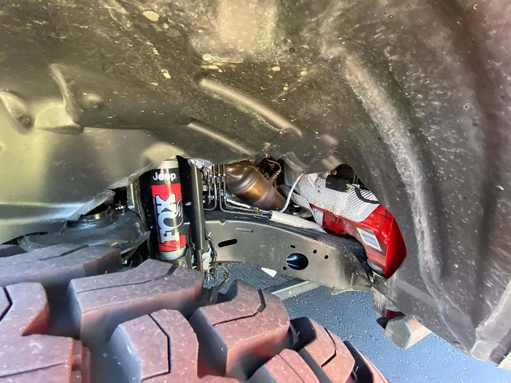

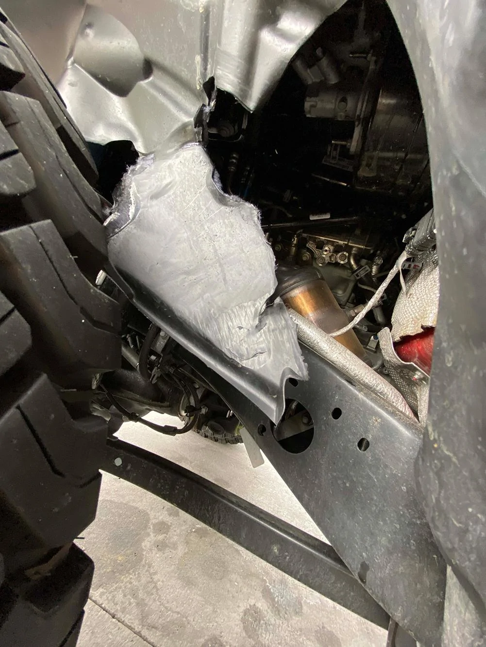

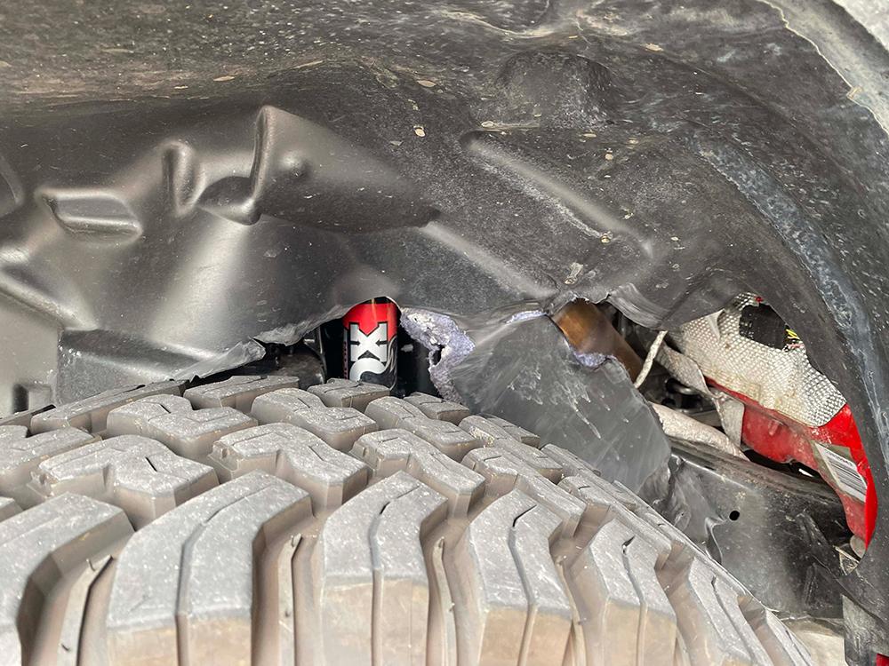

Welp...I had this issue fixed back in September...unfortunately, the new, "better" fender liner ripped out again yesterday.
Heard massive rubbing from the driver's side front fender. Pulled over to find this:

I'm concerned if I toss rocks or sling mud up into that now exposed area I could damage something (exposed wiring, etc...) this week...not great timing.
@JeepCares I had a previous case with you because LA CDJR tried to charge me to replace the fenders and pay for their "diagnostic fee."
