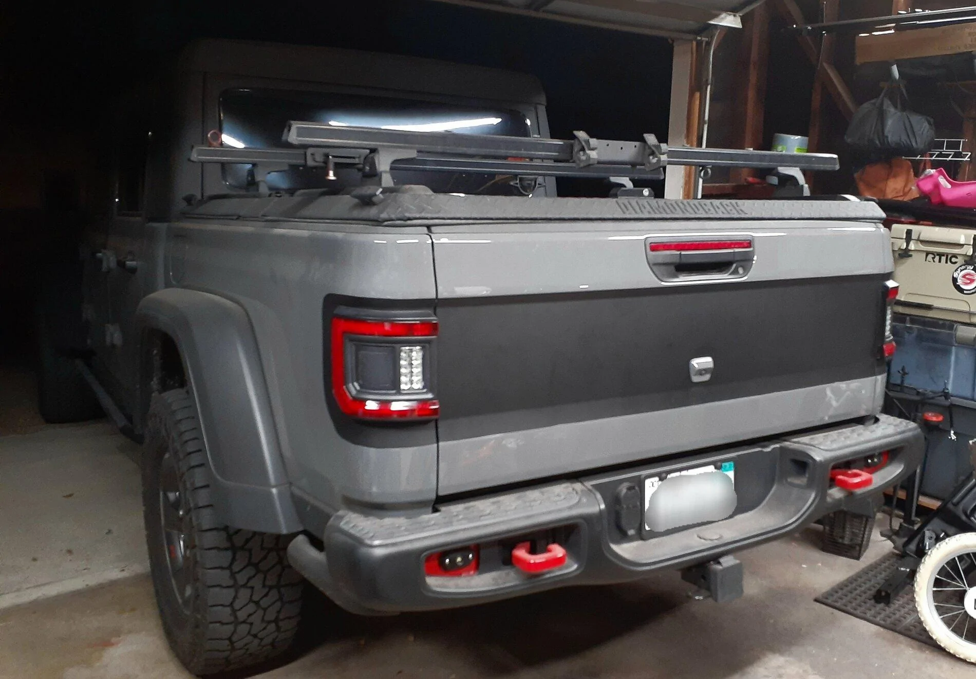

I’ll add some positive feedback. I installed mine and I had ZERO issues (and I was too excited to watch their video) with the fit. The lights worked fine going from stock halogen to these LED, but the reverse lights didn’t stay on until I switched settings with the Tazer
(edit- I didn’t want to run the resistors so I removed them, which is probably why the reverse lights didn’t Stay on, and relied on the Tazer I already have)

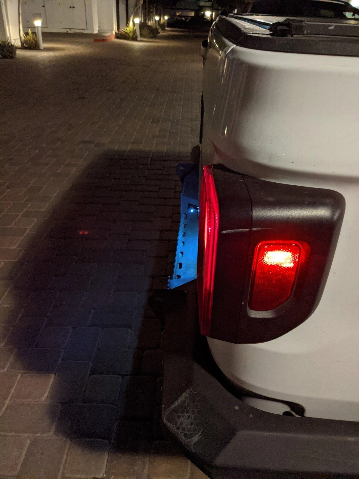

Jeep Gladiator Flush Mount Tail Lights 430CD82B-9445-41D0-936E-28F3CB398351

Lights showed up but too late to install tonight.
Wart removal begins tomorrow. Motobilt bumper so don't think it'll be as junk in the trunk looking.

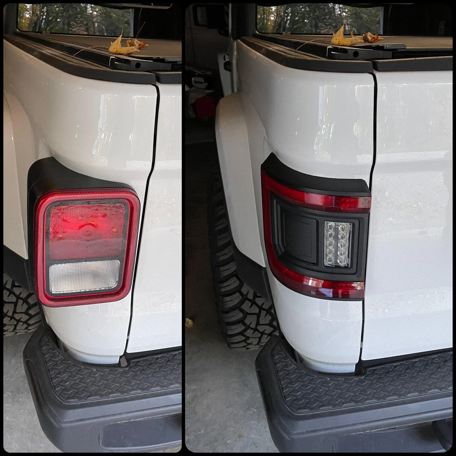

The wiring on these is shorter than the factory lamps. I had to pull the retainer clip holding the factory plugs on both sides. Otherwise, the plugs on these lamps would not have reached.
Same as another guy, the fit on the passenger side is definitely better. Not sure why. That tiny recessed screw was just a hair over flush.
I turned them on just to see if they worked. And they did.
I did not want to run the resistor, so I went the extra step. Side note, no double sided tape on mine either.
I installed the z auto SGW extension. I had to use a screw driver to depress the tabs to pull the two plugs.
Then I plugged in the SGW bypass connector with OBDII module.
Turned vehicle on Run.
Loaded up JSCAN app on my phone and paired.
Chose my vehicle.
Went to Adaptation tab.
Went down to
rear turn lamp LED
reverse lamp LED
stop lamp LED
tail lamp LED
And changed them all to Activated
I turned the truck to off. I did not reboot.
I started up the truck and went through all the functions. Everything worked. The reverse is way brighter than factory halogen.
I took it for a drive around the block. No errors. No hyperflashing. Gonna give a week before I ebay my factory lamps. Hahah
