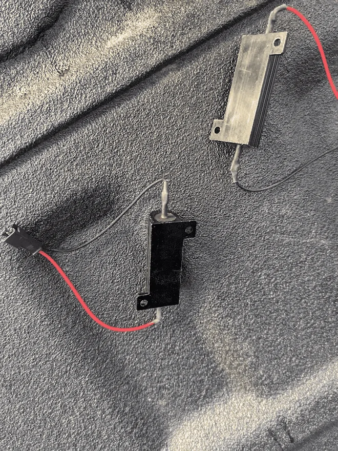

- I didn't have double sided tape on my resistors (Oracle QC issue) but I didn't need them

- Coming from halogen the resistors did work just fine, but my reverse lights didn't stay lit, they flashed.
- JScan fixed everything up when turning to LED with removal of resistor

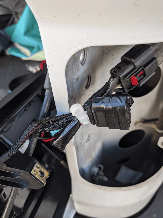

- No nannybots to worry about, tape up that harness and the resistor harness

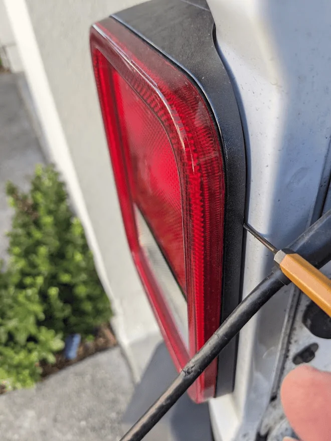

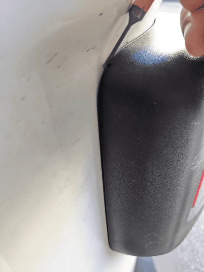

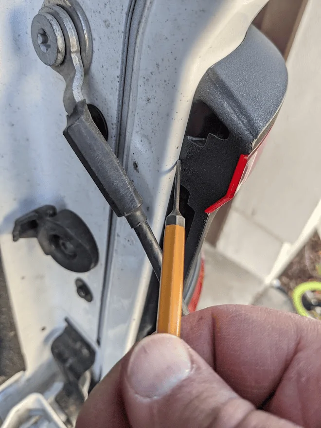

Factory light gap, my punch tool fits inside the inner portion
half the size on front

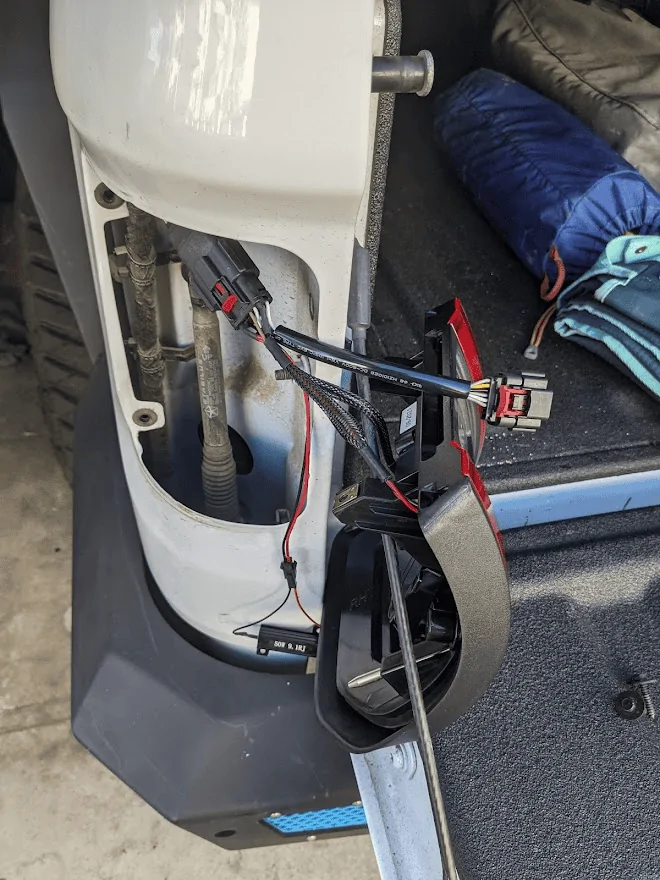

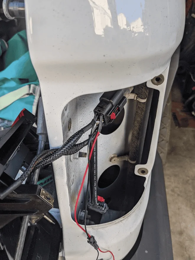

There is PLENTY of slack to work with if you pop the harness off the top retainer
... on both sides
... tape and tie the leftover harnesses I didn't need

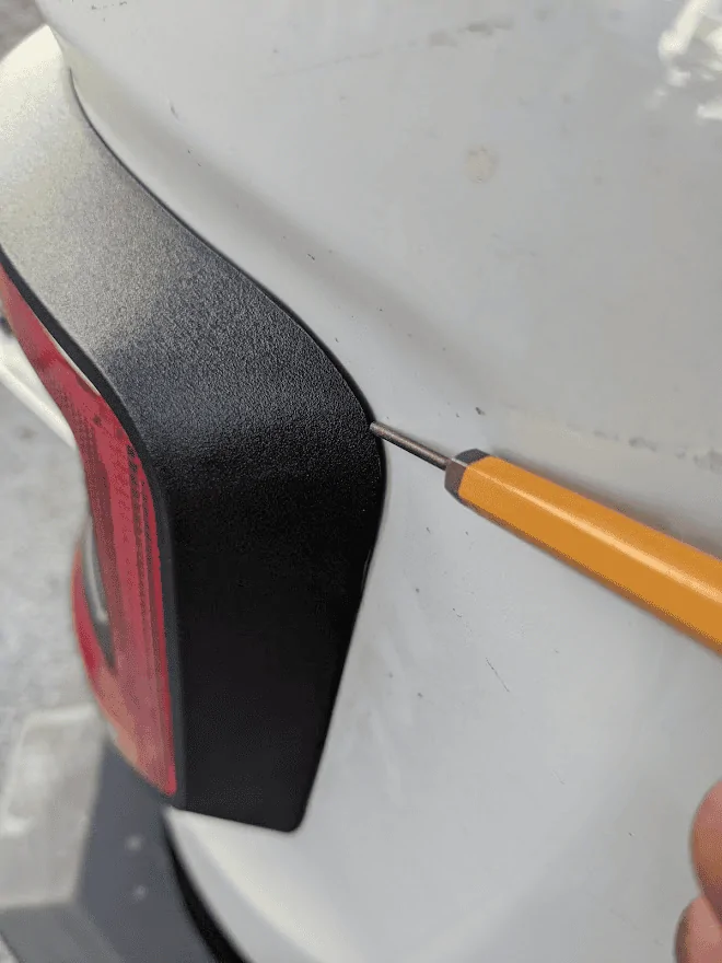

Fitment after about the same on leading edge
Fitment better on tailgate side
Oracle QC... resistors with no tape

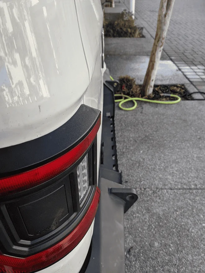

Side view after isn't junk in the trunk with the Motobilt bumper

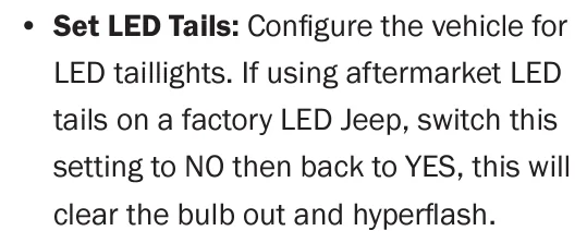

For anyone curious what setting needs to be changed in the Tazer, I grabbed this from the Tazer Mini User Manual
Jeep Gladiator Flush Mount Tail Lights 1634318077117
